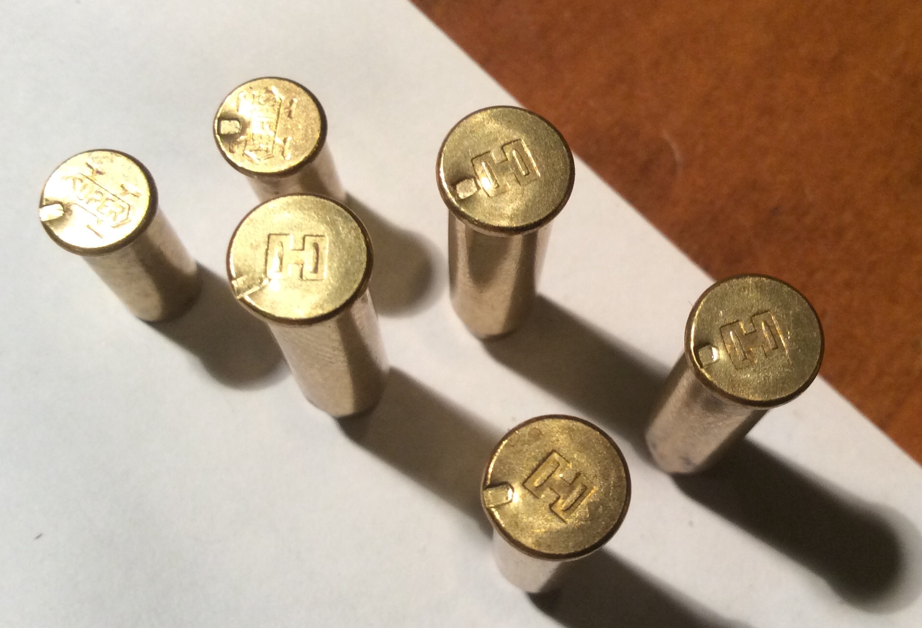

Better penetration from modifying the firing pin imprint. Don’t waste energy deforming the rim where there’s no primer paste, and by not deforming the rim the case rim stays true against the barrel.
Before on the left, after on the right. CZ452 22LR, Savage 93 17HMR and CZ455 17HMR.

Boundry Rider wrote:Better penetration from modifying the firing pin imprint. Don’t waste energy deforming the rim where there’s no primer paste, and by not deforming the rim the case rim stays true against the barrel..
Definitely worth doing regardless of brand or cost - Good looking FP strikes you have there!

You are going to have to explain this to me. I see that they are deeper and smaller . The firing pin indents seem to have moved more to the centre and away from the rim and the firing pin marks are visibly smaller. Did to change the firing pin as well? . As the priming compound is in the rim, why move away from the rim? My 101 shoots beautifully and I am not going to stuff with it.

Post by Boundry Rider » 25 Jul 2022, 11:33 pm
Savage was the worst, look at the poor imprint on the case. Many non fire episodes. Was 1MOA> and fliers 1 in 8 shots, now it CAN achieve 1/2 MOA 5 shot groups with infrared and better with glass optic. 455 was similar with the fliers, the 452 was already pretty good but now is excellent. These are hunting rifles not target. These HMR are for me to achieve head shot/ and or ethical cull bunnies all night to 120Y. The .22 is for parrots and lorikeets from 30-90Y in trees on orchards with winsub hollow points. No room for fliers and underperforming firearms.
First; primer paste is contained at brass thickness inside the rim. Primer paste is required to be crushed fast and consistently. So why crush the brass outer edge as well? Shift the impact inside the edge and crush primer paste and not brass edge.
Second; less surface area on firing pin equals more impact pressure. So much so that you can actually lighten your firing pin spring (to reduce your lockup effect) and still have consistent ignition.
Third; look at your fired case after a bladed firing pin has impacted it. You will have an imprint under the rim where the rim sets against the barrel chamfer. So crushing the rim affects the alignment of the brass case inside the chamber prior to powder ignition and seal. Why pay for headspace resetting when your bladed firing pin is drop kicking the case across the chamber prior to ignition? Impact inside the rim and keep the case square in the chamber.
Firing pins are cheap and are metallurgical construction, light stone, diamond file, emery paper etc. Choose your own method if you wish to modify yourself. And for all the naysayers, look at the imprint of a combination single shot (.410/.22LR) on a .22 case. It will be inside the case edge as it is impacted by a center fire firing pin offset so this isn’t new science.
Hope this helps others.
