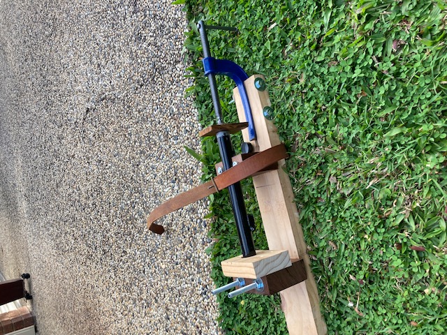

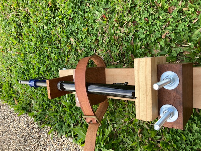

Re: My Model 25 Gecado
Post by Wm.Traynor » 04 Sep 2022, 4:46 pm
Project 10.jpg (204.09 KiB) Viewed 3204 times
Project 9.jpg (187.8 KiB) Viewed 3204 times
Project 1.jpg (204.09 KiB) Viewed 3204 times
Posts: 1824
Post by Wm.Traynor » 04 Sep 2022, 5:09 pm
The piece of pine in the above pics, that is screwed to the block of red wood furthest from the G-Clamp, is drilled right through, the accept the breech-end of the compression tube. It is that red block, which resists the force of the spring. The hole in the pine is lined with thin leather, to avoid marring the very expensive :roll: ;) finish on the tube. The belt idea came from a Yt video, although it is used in conjunction with some firm rubber between it and the very expensive etc., etc., etc..
Thank you everyone who contributed :D It works like a charm now. I can scarcely believe how good it is :D :D
