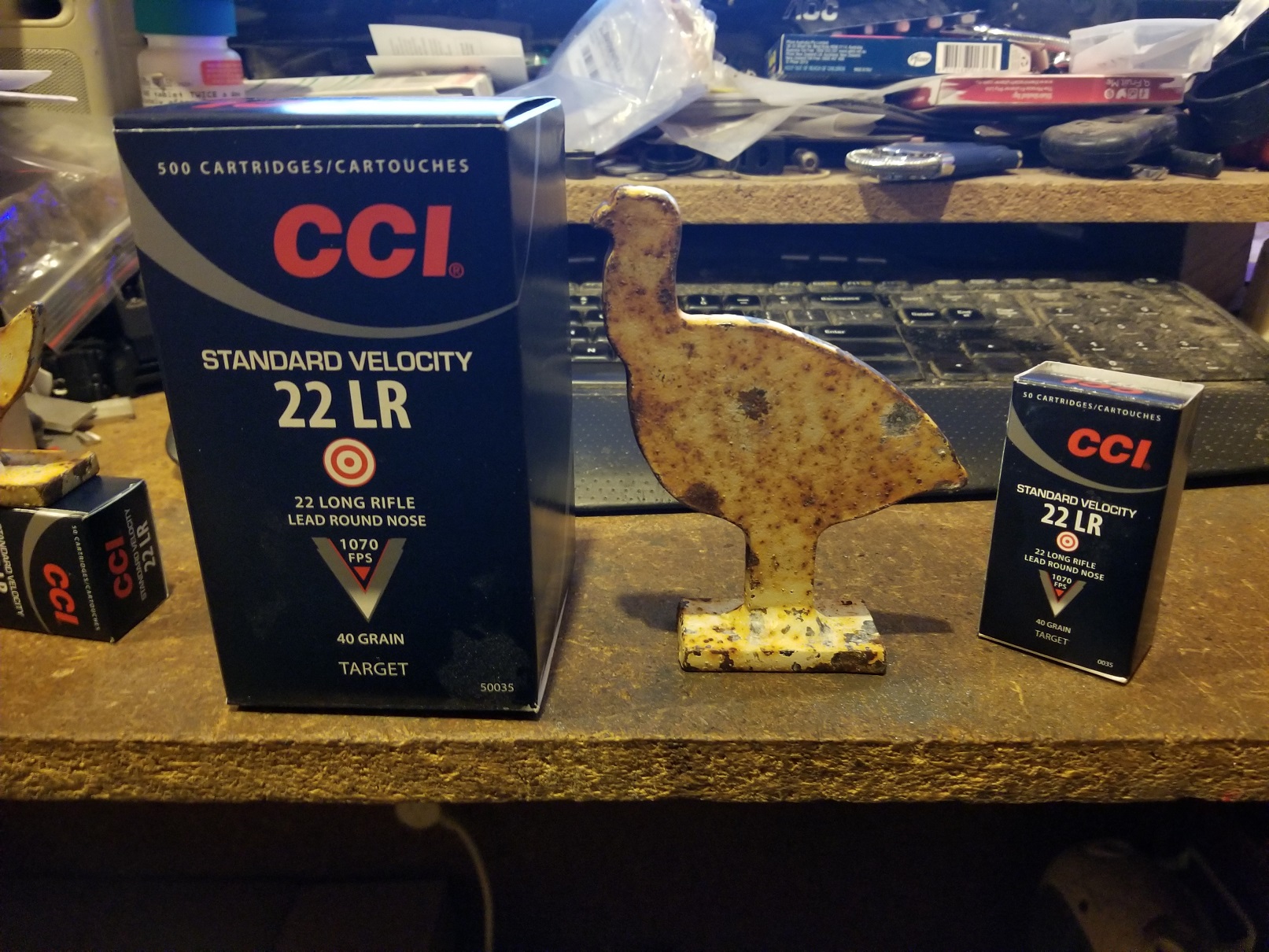

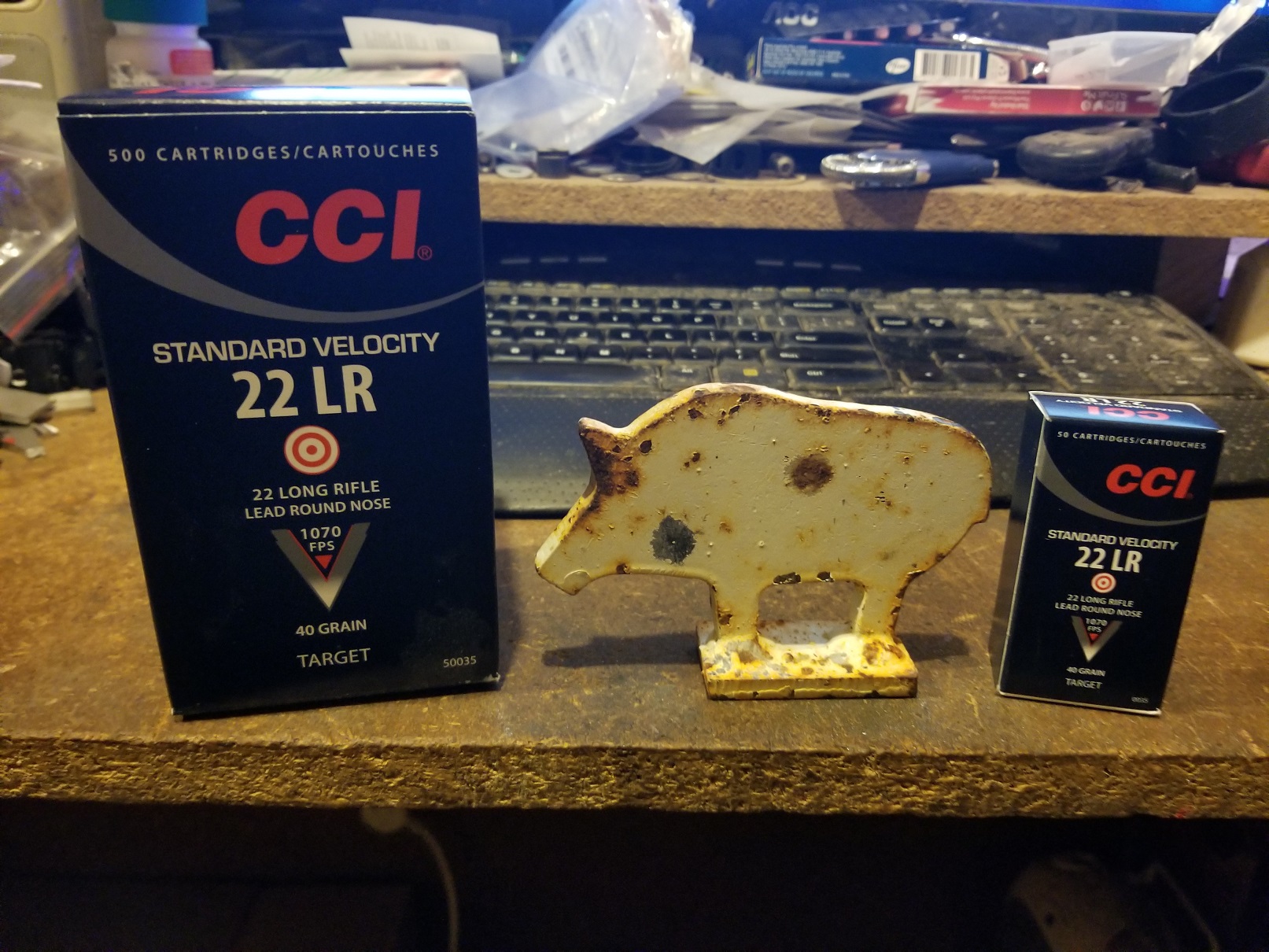

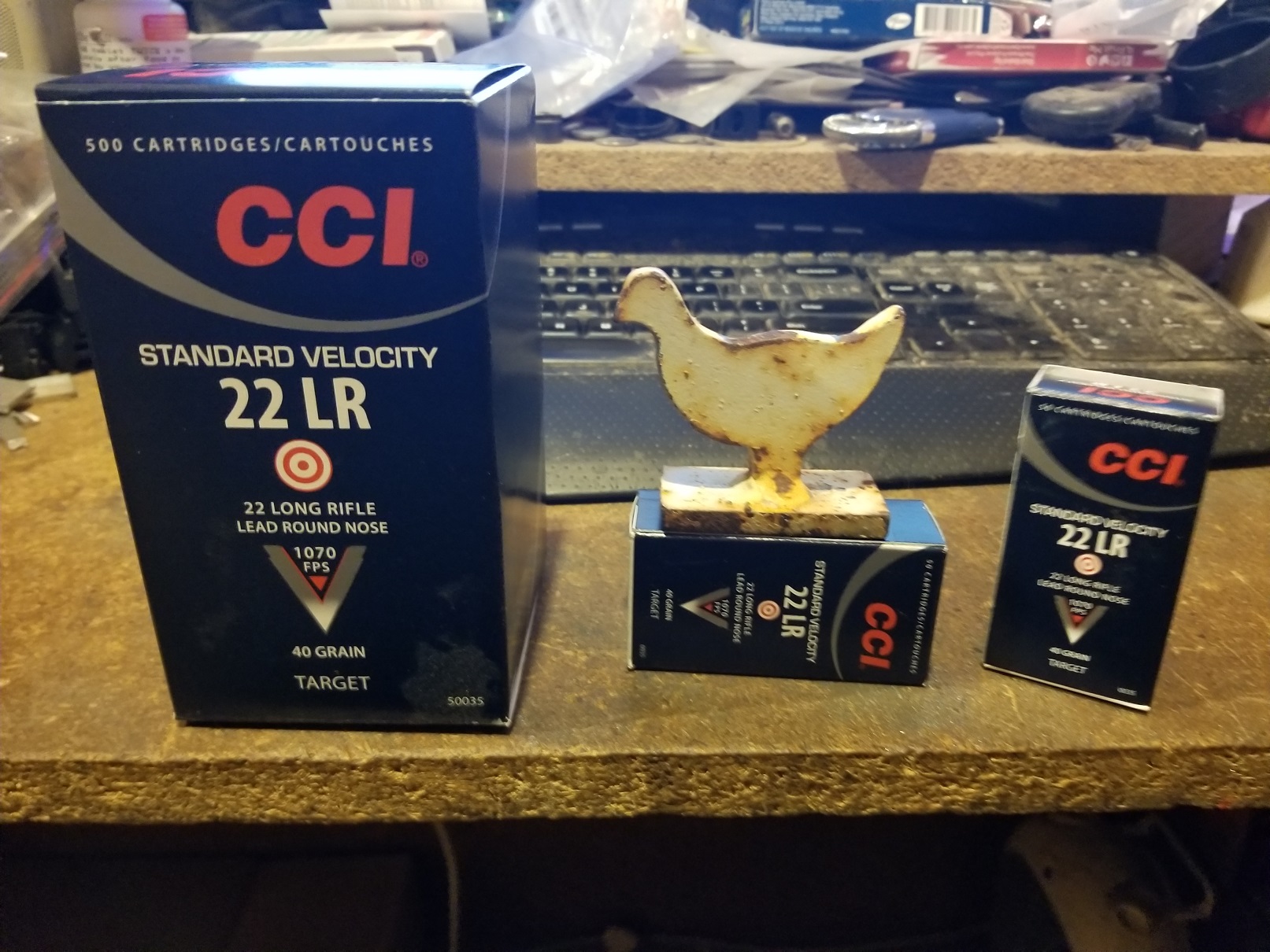

I don't do a lot of difficult offhand scoped practice, but I do a lot of iron sight practice on half-scale silhouettes. I have the half-scale and fifth-scale rimfire silhouettes mounted on frames so I don't have to keep setting them up, I just turn the frame around to shoot them facing the other direction. I also practice a lot on cut-out silhouettes, paper stuck to an MDF backboard. I would practice on these _a lot_ so you can see where the entirety of the group is falling, including the misses. This allows you to define precisely where you need to be aiming at the target - which is likely to be different for both facing directions.
https://enoughgun.com/forum/viewtopic.php?f=17&t=9146&start=30#p151134
The biggest factor in reducing my offhand group sizes was simply practice, a whole lot of practice. At least a brick every week for months, every single day, regardless of the weather. I keep a pile of 15rd mags and speedloaders loaded up and when I find I have a moment free I grab them and wander up the paddock for a quick session. I generally fire a 150rd or 180rd session, but I do sometimes double that. I try to avoid having to reload everything in the field as it takes me ten minutes to load 150rds into mags or tubes. When I'm "in the zone" my group sizes are now small enough to theoretically put every shot onto the silhouette - with iron or open sights on the half-scale silhouettes - the misses are now entirely down to my own efforts. The rimfire fifth-scale silhouettes are very significantly smaller than the half-scale though, you need a rifle that will consistently group small enough, and you need to be able to shoot it well enough to keep them in that area. To hit the rimfire silhouettes you need to be able to group offhand consistently in about 1.5 minutes, which I struggle with. If your rifle only holds 3MoA (87mm) groups at 100m off the bench I would think you will have a very difficult time getting consistent hits on a target half that size. If your rifle does hold 1.5 minutes (44mm) at 100m then there is still zero room for error, you have to be able to group precisely as well offhand as you do off the bench.
You need a very good trigger so you can load it to the break point, then release it at the exact moment the sight picture is where you want it.
I don't try to hold steady on the target, I let the sight picture "float" around the target and fire when it's in the right spot.
