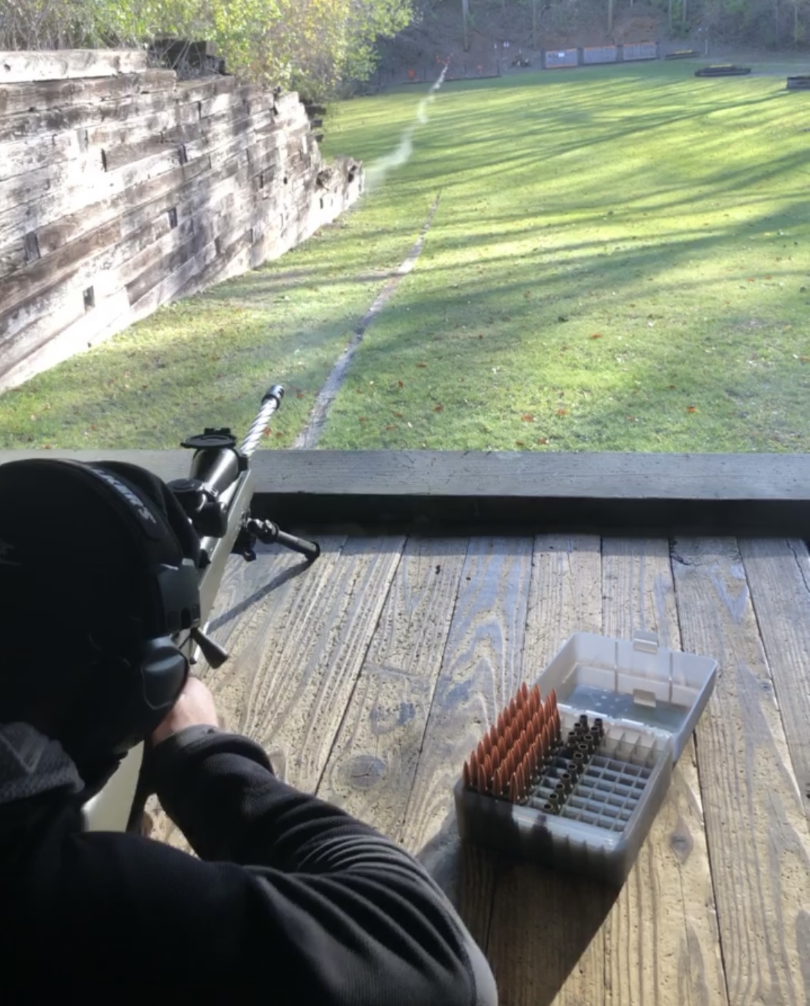

Post by Lazarus » 15 Jan 2024, 10:18 am
I have never witnessed this phenomenon, with either rim or centrefire, has anyone here seen this in the field?
The shooter in the video is clearly getting it from .22lr
https://youtu.be/bDxrUj_4Gj4?si=rqZAO5kpO_GN_ru6

.22.LR ??????

Post by Lazarus » 15 Jan 2024, 1:48 pm
niteowl wrote:.22.LR ??????
From the short bolt throw and tiny brass, 22lr indeed.
Must be lobbing them way out there from the flight time before you hear the gong

Post by niteowl » 15 Jan 2024, 4:21 pm
Have a look at his ammo box !

Post by Lazarus » 15 Jan 2024, 4:41 pm
niteowl wrote:Have a look at his ammo box !
Have a look at the video

Post by niteowl » 15 Jan 2024, 7:26 pm
Yeh OK. Nothing to do with the image posted ??

Post by Lazarus » 15 Jan 2024, 7:44 pm
niteowl wrote:Yeh OK. Nothing to do with the image posted ??
Sorry, that's my fault for not making it clearer, the picture was part of the same story, I forgot to make it clear that that was another example of the phenomenon with a centrefire

Post by straightshooter » 15 Jan 2024, 7:46 pm
Niteowl
Good observation on both counts.
Chances are that the shooter in the picture is using tracer projectiles.
However I still have trouble abandoning the thought that the corkscrew chemtrail is due to the corkscrew fluting on the barrel.
Although if I were to lose my jester's cap I might be able to offer a sound physics based explanation for the corkscrew chemtrail. But not tonight.

Post by Lazarus » 15 Jan 2024, 8:09 pm
straightshooter wrote:Niteowl
Wrong
Again
https://youtu.be/jRzvQ-3TukQ?si=3ircU6FmVIaQjwgh
