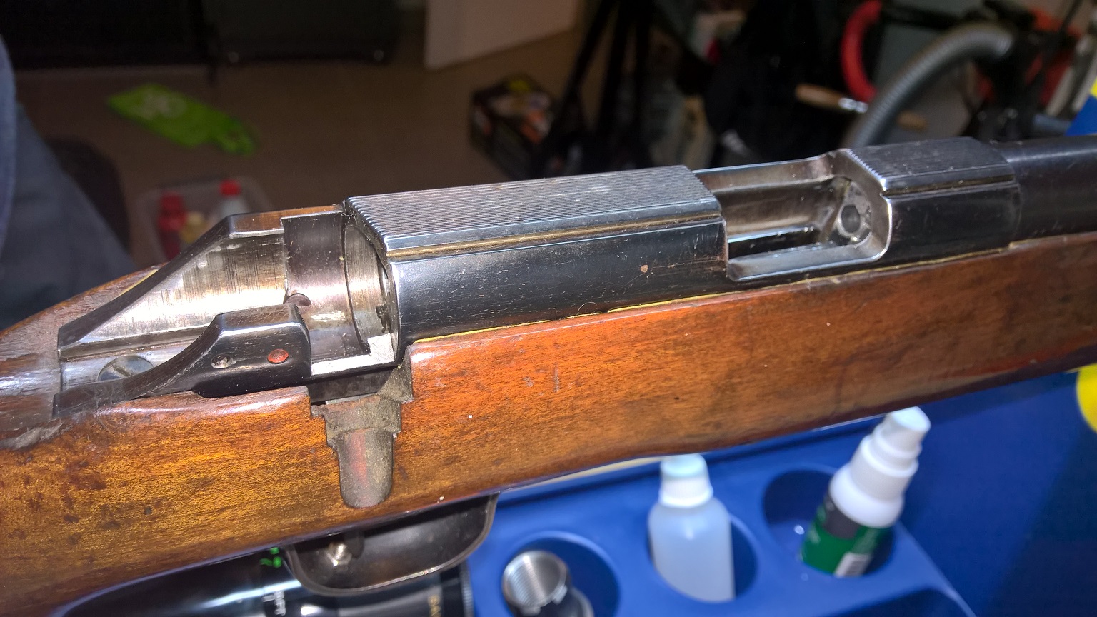

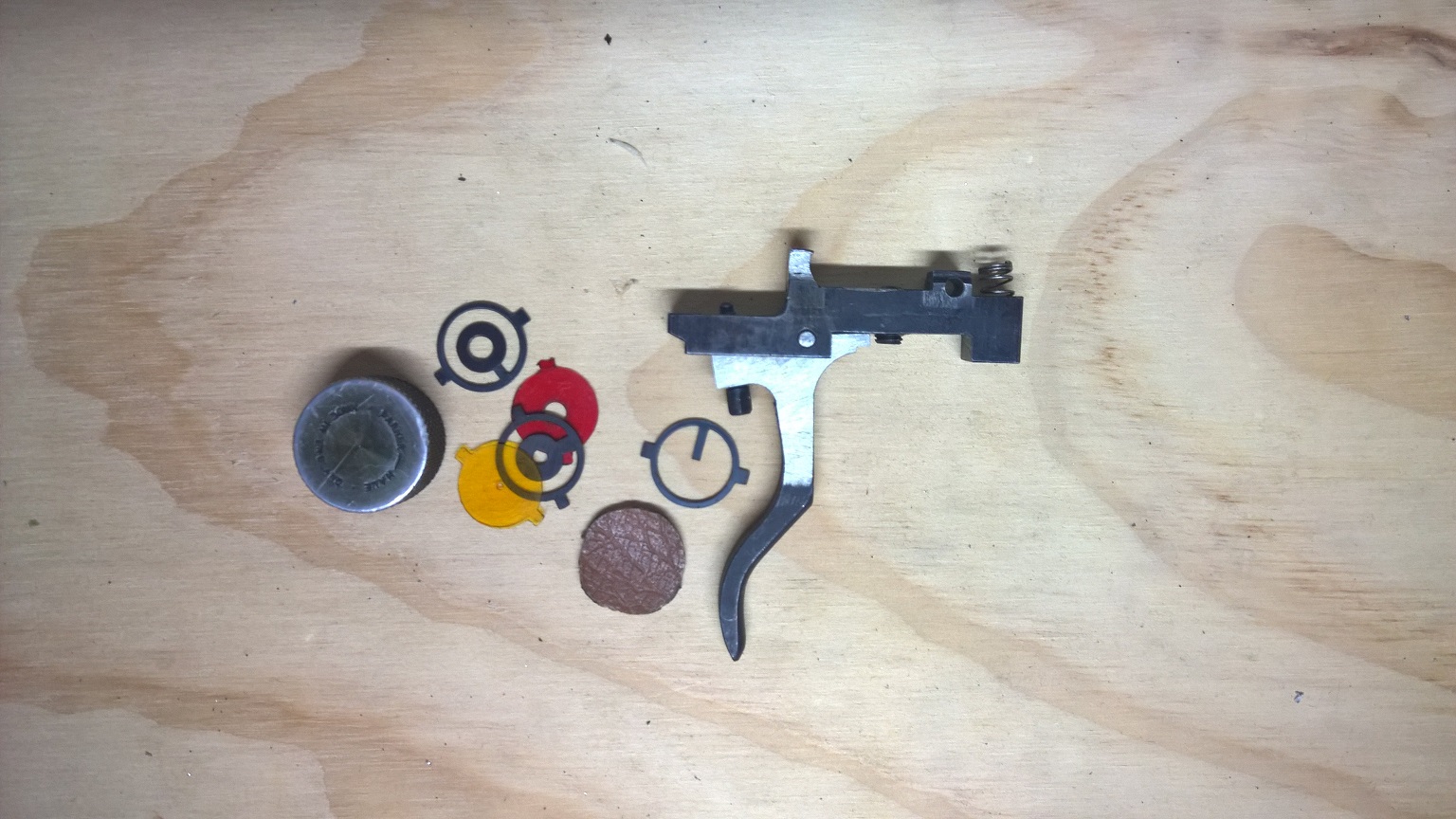

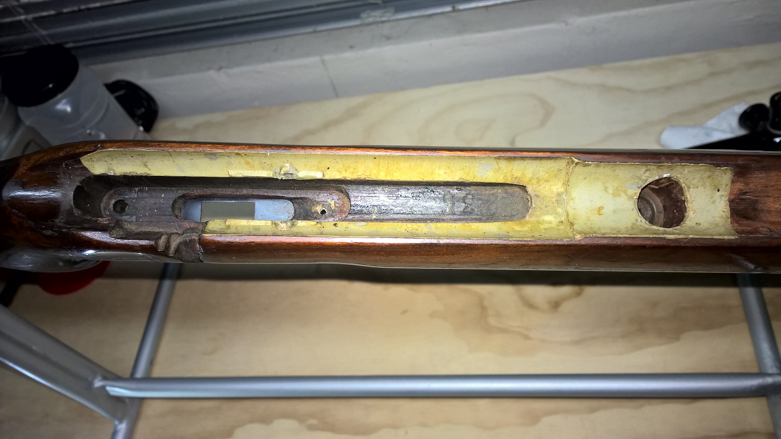

Finally got the pta and went and picked up the Clubman. Stripped her down to have a poke around and was nicely surprised, action bedded and barrel floated and overall everything is pretty good. The sideways motion of the trigger is more to the lack of timber around the sides of the trigger from what I can work out as everything else on the trigger and how it mounts to the action has very little movement. Be nice if I could see some pictures of another sportco trigger set if anybody can take the time. Even has the Parker Hale attachment on the front of the stock and parts inside. Local range is closed for some work so will be a few weeks before I get to try her out.
Bedding
Sportco Clubman2.jpg (418.82 KiB) Viewed 6288 times
Action
Sportco Clubman6.jpg (453.38 KiB) Viewed 6288 times
Trigger
Sportco Clubman4.jpg (452.55 KiB) Viewed 6288 times

I don't know anything about the trigger on your rifle but sideways movement is not a good thing for consistency
how I would fix it is to drill out the existing pin holes with a slightly larger than the hole drill bit and cut the drill bit off as a new pin
drill bits are hardened and are good for pins :thumbsup:
