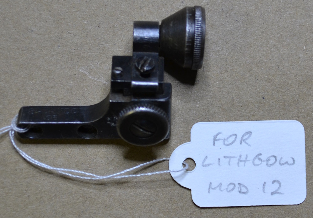

Are you using the factory rear sight mounted on the barrel, or is there a peep sight fitted?
These rifles are much easier to shoot with a peep sight (for my aging eyes anyway). The peep sight mounts onto the 2 small screw holes on the left rear of the receiver. They appear on eBay for sale every so often.
Lithgow Mod 12 Sportco sml.jpg (270.82 KiB) Viewed 4832 times

Tinker wrote:Are you using the factory rear sight mounted on the barrel, or is there a peep sight fitted?
Thanks Tinker. I am currently trying to use the standard sights. Agreed my 57 yo old eyes are not coping at all. I have to get the rifle somewhere near zero, but shortly thereafter a peep sight will be on the list to keep the rifle period correct, and usable for me. Thanks for the advice.
