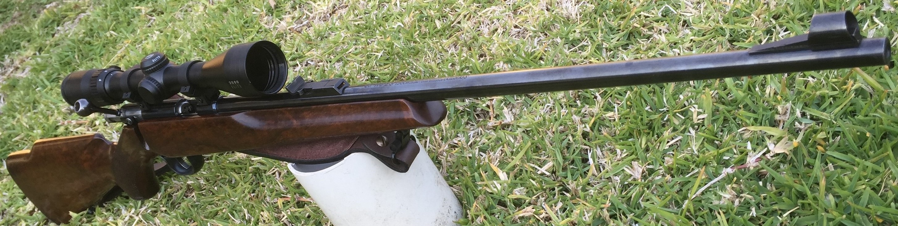

Good luck with your 62, hopefully you get to use it and love it. I still use mine for club Field Rifle competitions, it's light, easy to use, reliable and still shoots better than I can hold it. My ammo of choice is CCI Std 40g RN
Here's a pic of my 63 (with a more modern scope)

Note the high quality 'iron' sights on the barrel.
My 63 was part of a re-vamp of the product line with better stocks as you show and I could hit a 5 cent piece size target at 25 metres with ease.
