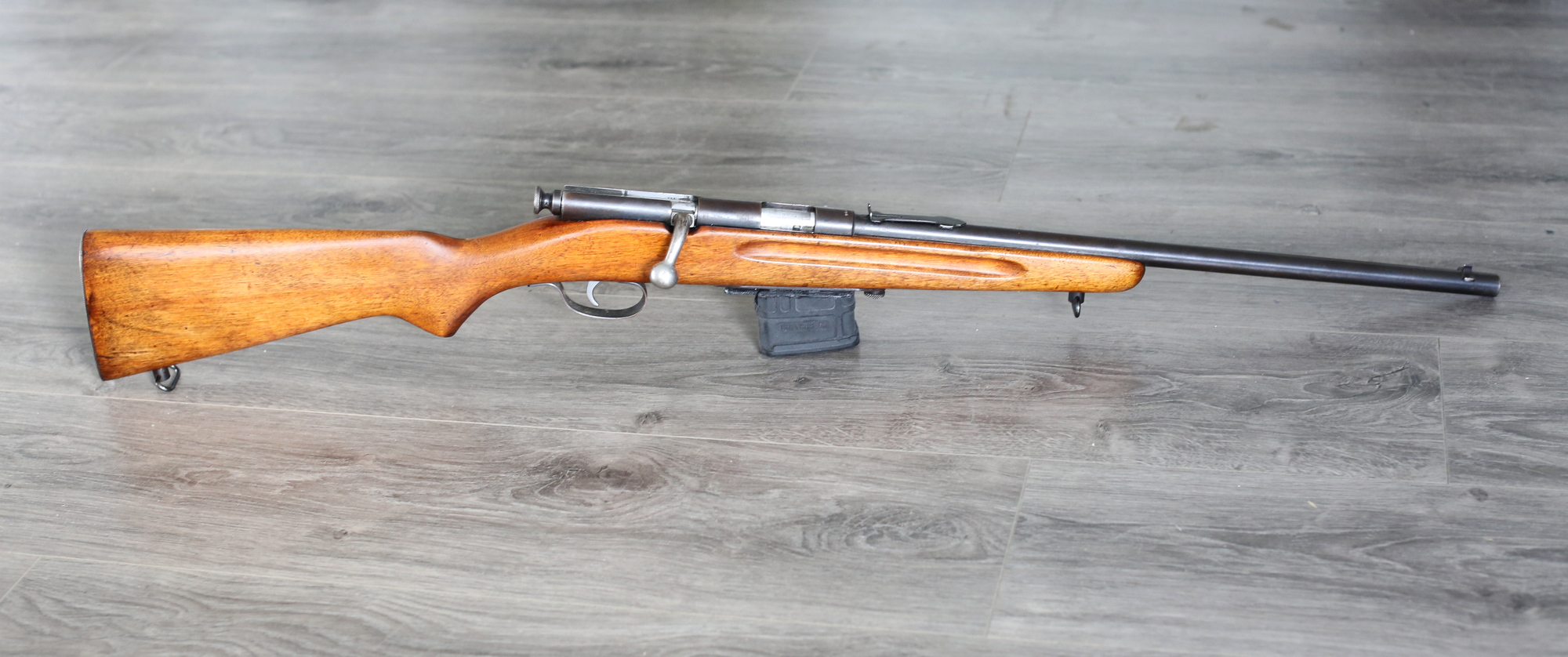

Post by SHV » 10 Jul 2025, 2:59 pm
cycle the bolt but ammo jams half way into the chamber, bite off a piece of lead form projectile and sometimes if push too hard the case bent

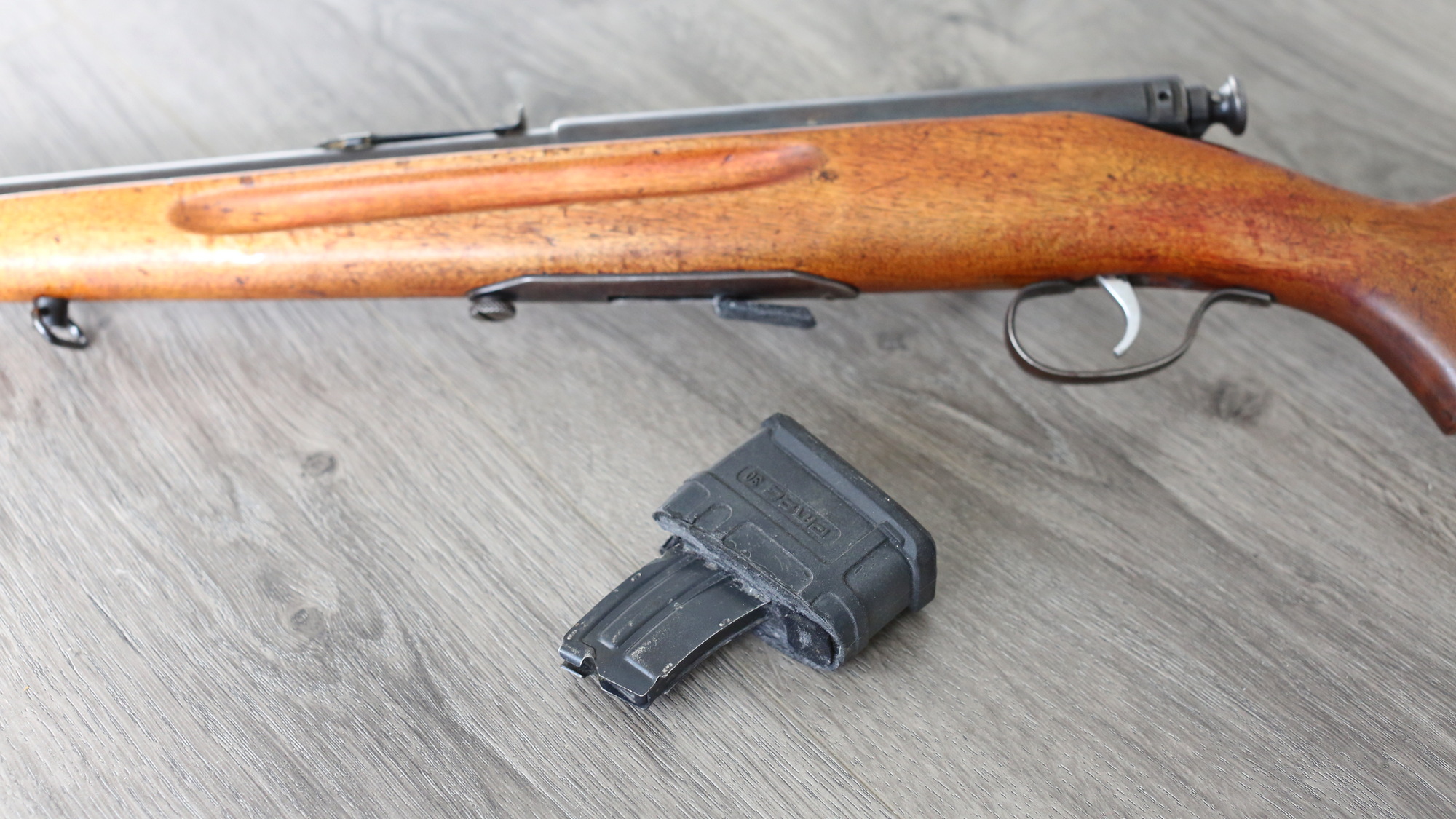

after a while i find out if hold the 10 round mag to cycle the bolt it fix the problem perfectly that means change the mag position(up) a little bit or change the angle a little bit will change the ammo's position or angle which is the cure

so I made a sleeve for the teen round mag and use a piece of patch glued in front part, it will adjust the angle of the mag once the mage installed

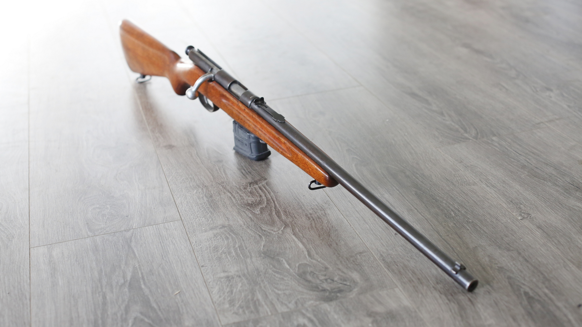

Post by SHV » 10 Jul 2025, 3:20 pm
now no matter hold the mag or hold the rifle to cycle the bolt, no issue chambering the ammo anymore
