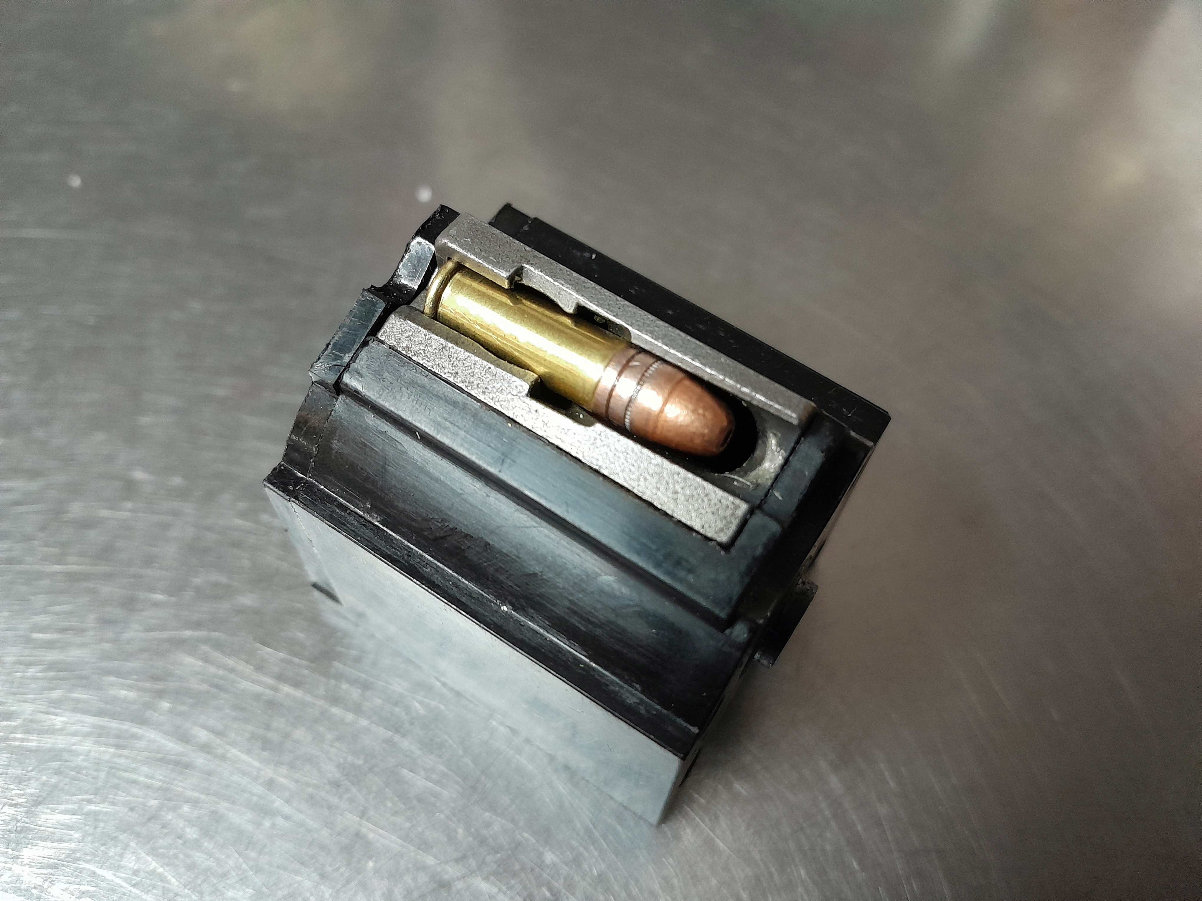

Get yourself a pea rifle with one of these mags, and you'll never have those dramas again.
10-shot and flush fitting, no gnarly spikey little magazine stabbing you in the back when on the sling either.

Post by Wapiti » 08 Sep 2025, 7:27 am
Explain to me how you "shim" these magazines, mate. They fix on a centreline within the stock with locating pin at the front and a tapered catch in the centre-rear.
They cannot locate anywhere other than the tapered seats fixed into the stock, which are not adjustable. They are cast steel inserts and bolts moulded into them.
The feed lips are cast, hard stainless and cannot be adjusted either, which isn't needed.
They were originally designed to endure the abusive hard life they'd get in the 10/22's, and suit the pussy-easy life they get in the bolt actions even better.
I collect bolt action 77/22LR's, 17's and 22mags and have seven, and Cat C 22LR and 22mags. As well as two Americans which are tortured around here as expendables, and treated like crap. All use the BX mags. None, whether timber or synthetic stocked, bolt or semi, can be shimmed in the stocks and all function perfectly.
I'd love to know how, in case I ever have any dramas.
Only dramas I've ever had, are the awful "Lucky 13" and other cheapies, with their aluminium and plastic feed lips which start chewing out immediately.
