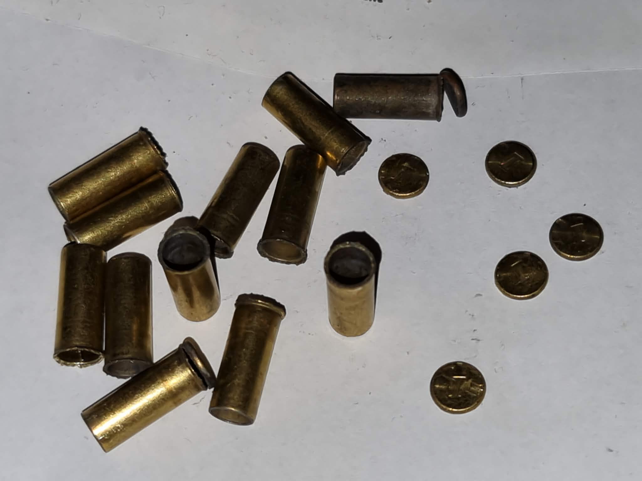

I've rarely had any trouble with the old ammo I've been shooting, but on Wednesday in a Standard match I was a few rounds short so I grabbed some out of a box of old ICI just to finish the match. The first round blew the case head off the case, leaving the shell in the chamber. As I didn't have a rod and brush with me I finished the match five rounds short.
So I decided to clear some of these old boxes out yesterday. I had 17rds of this old "I" head stamp ICI stuff left. Out of the 18rds, 13 blew the case head completely off, and two more blew the case head apart but it was still attached to the case. If I had fired this stuff in a pistol with an extractor I'm sure I would be hunting for a new extractor for it. It dumped the gas out the sides under the slide, impregnating the residue into the skin of my finger, but there wasn't any heat or pain. The FAS 602 is very easy to remove the barrel though so I just pulled it each time and pushed a bronze brush through to remove the cases. Two of the case heads landed on the bench beside me, the others I found on the ground behind me, so they probably went over my head. I didn't get any debris back into my face but I probably wouldn't want to be standing close beside me when I was shooting these (I was on my own at the club).

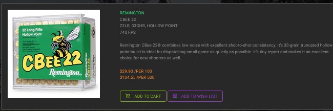

I notice Remington is now also selling the 1500fps 33gn Yellow Jacket bullet at 740fps, calling it the C-Bee22. I liked the Yellow Jacket when I was a kid but it lacked some accuracy, so I wouldn't mind trying the CBee22 - anybody seen it in Oz?
https://www.remington.com/rimfire/29-21119.html

Yep well known around the old blokes that I know that the priming compound causes corrosion in that old ici stuff hence that's where it becomes brittle around the rim

What I like about the Yellow Jacket is the very soft bullet and the huge cavity, they kill very well. If they are using the same bullet in this 740fps stuff it could be excellent - if it's accurate in your rifle, and it feeds in your action. Cleaver has it listed so it's a good chance it'll show up here eventually.
