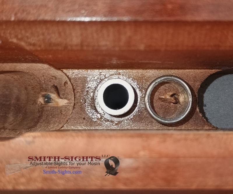

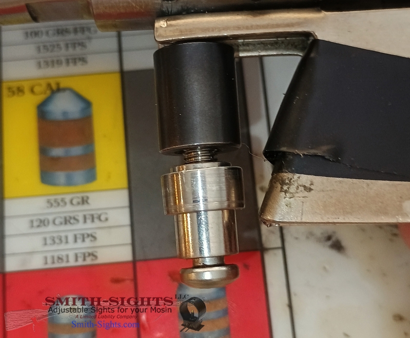

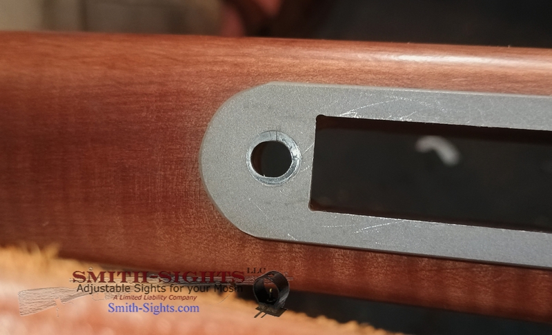

That's a really clever bit of work mate, what was the effect?
I imagine that the two pillar halves would have quite critical lengths to come together and just pinch (didn't want to use the word "compress" because it's not really the intention) the timber enough to keep everything consistently in position.
What happens when the timber yields over time? Can it be "snugged up" again?
With regular bedding as you'd know, you can keep a consistent torque by retightening the action screws as the bedding material settles in the timber, in certain woods it certainly will. I've left out the knuckleheads overtightening everything...

Post by Josh Smith » 12 Jun 2026, 5:29 am
Wapiti wrote:That's a really clever bit of work mate, what was the effect?
On the other side of the spectrum is the awful plastic bottom "metals" (what a crime of a term) on firearms where the makers just blatantly say "quality is not our intention". If I was a firearm manufacturer and used plastic that basically forms part of the bedding, I would be ashamed.

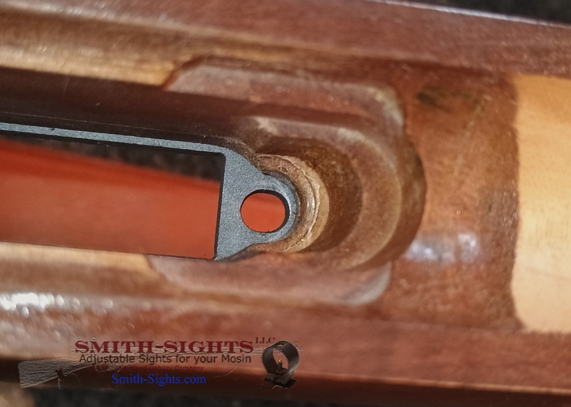

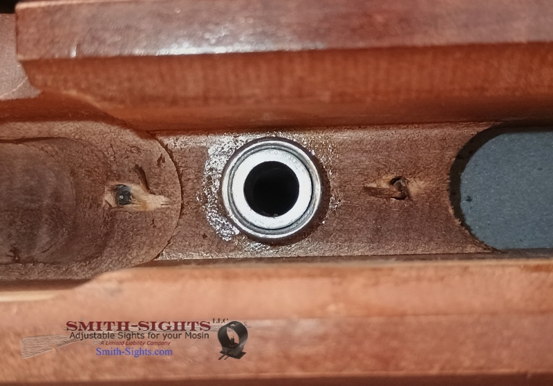

There's what they look like apart. Notice the bottom metal is the thicker DIP brand, and I'm not sure how well this would work with the stock bottom metal.
Josh Smith

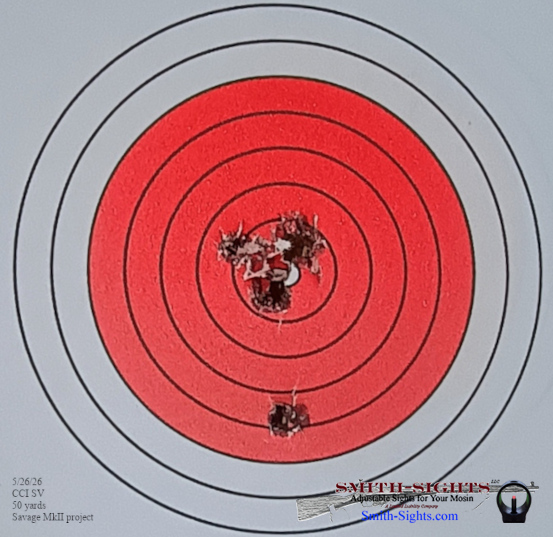

Post by Josh Smith » 12 Jun 2026, 5:31 am
It seems to work.

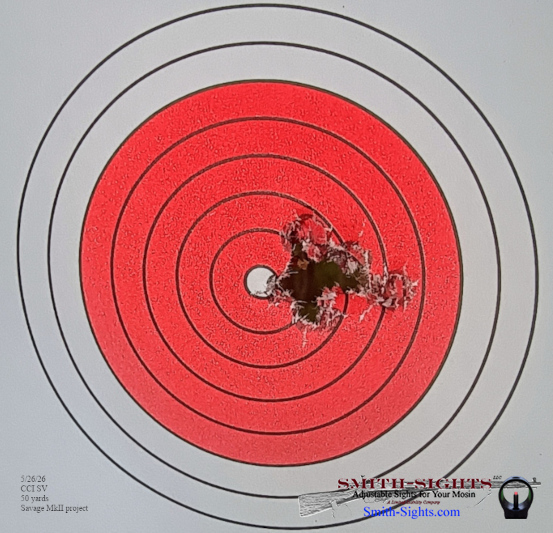

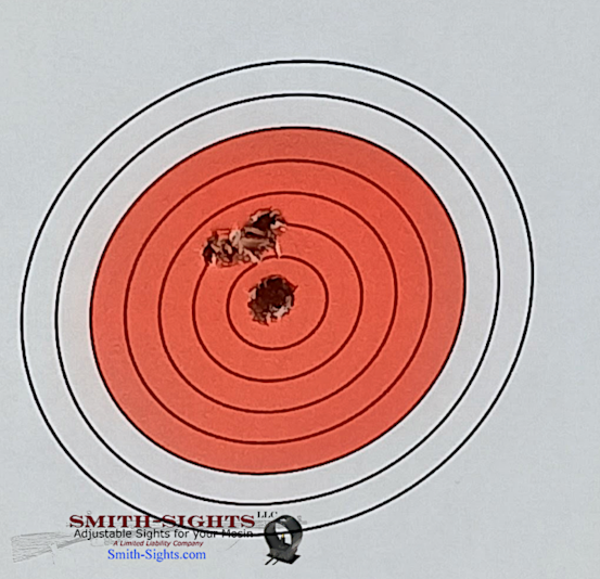

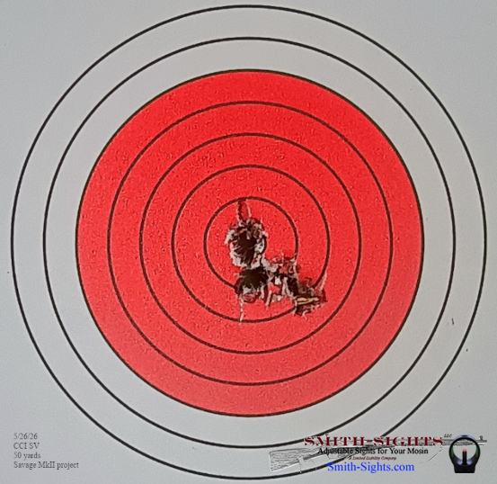

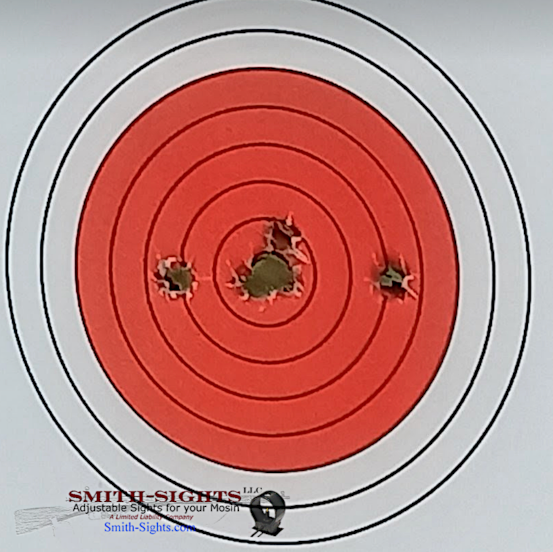

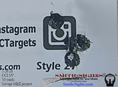

I'm still re-learning how to shoot precision, having not done it in something like 15 years. But when I get on the rifle correctly, I do see quite a bit of improvement, even accounting for flyers:
1 CCI-Mini-Mag-HP-36grn-Lot-J19U13-1.png (461.06 KiB) Viewed 8 times
Mini-Mag HP, 50yds
2 CCI-Mini-Mag-40grn-solids-Lot-J19U13-1.png (459.87 KiB) Viewed 8 times
Mini-Mag Solids, 50yds
3 13.png (145.74 KiB) Viewed 8 times
CCI SV, 50yds
4 10.jpg (152.78 KiB) Viewed 8 times
CCI SV, 50yds
5 11.jpg (172.57 KiB) Viewed 8 times
CCI SV, 50yds
6 12.jpg (180.4 KiB) Viewed 8 times
CCI SV, 50yds
Not my best work, but I've also not sent match ammo through it yet.
