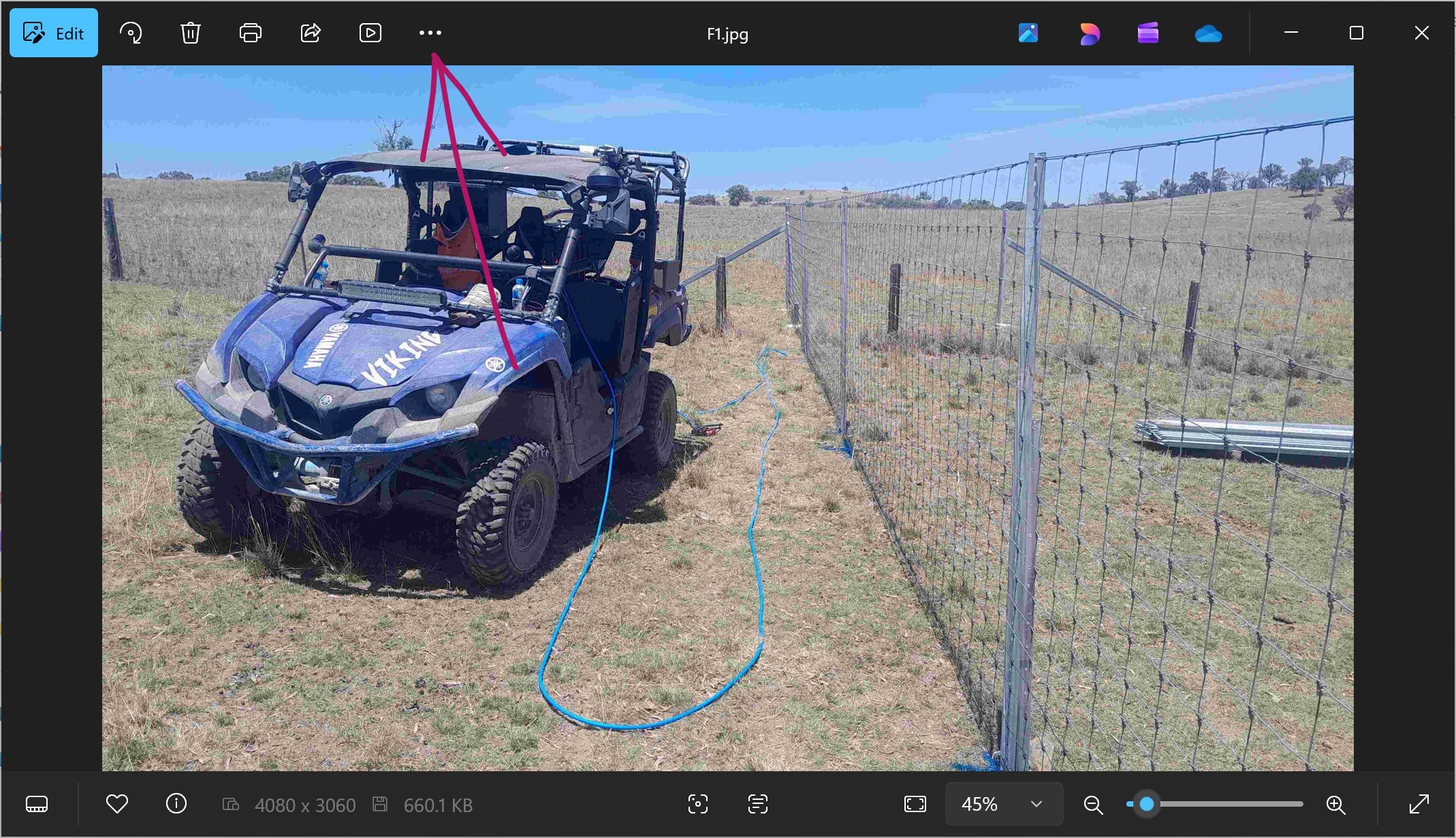

mate, open the pic on your PC, see this example.
Under the arrow (click on the dots) and a drop down box will come up saying "resize image" and you just use the slider to get it under 700kb.
Then save as whatever you want to call it, then when attaching via the site, find it where you stashed it, click "full editor" then double click on the upload pic and "place inline" .
But first click on the page where you're printing first, where you want it to appear.
See below
