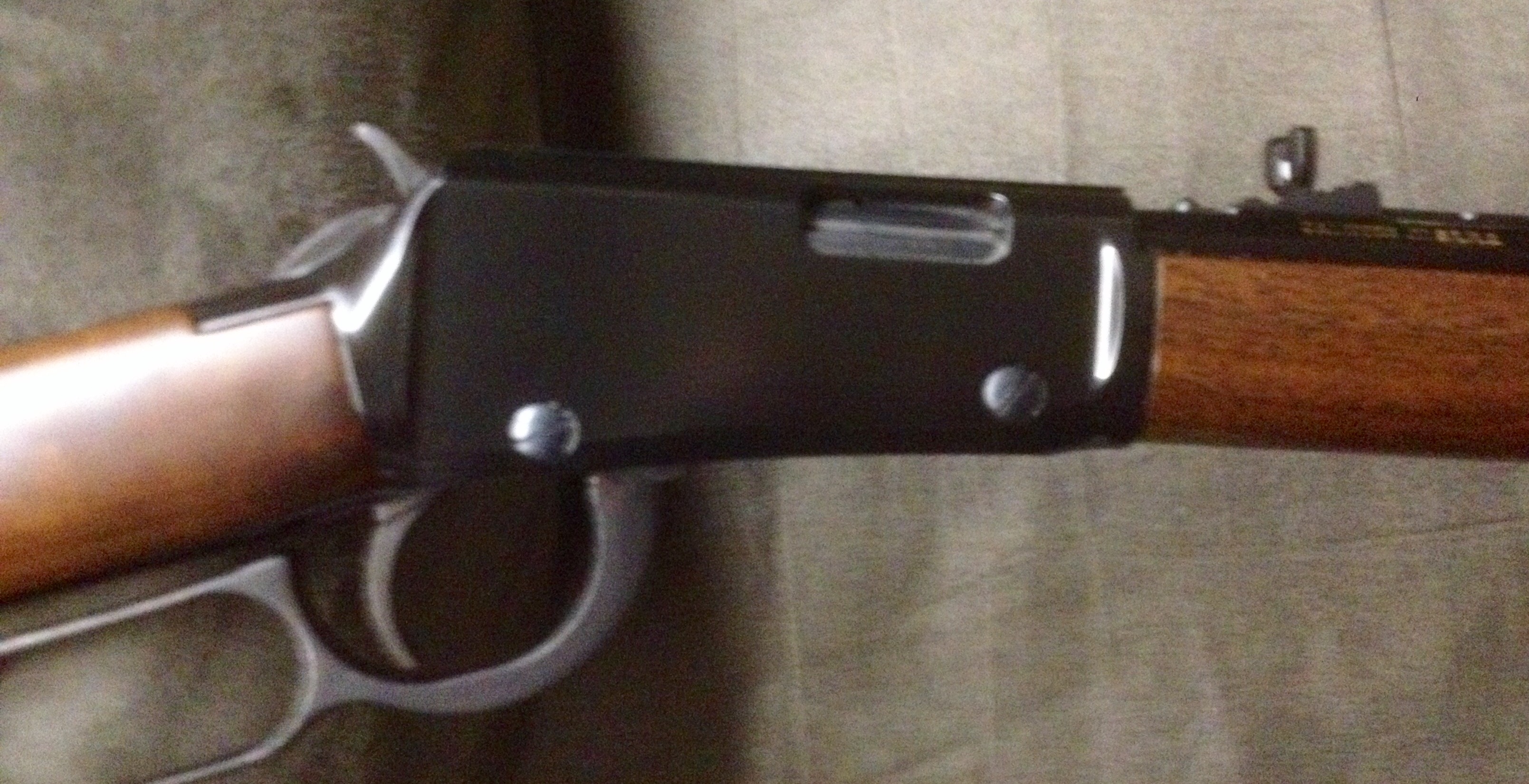

So as some of you know, I have a Henry Frontier .22 Lever Action. It has an octagon barrel and is just beautiful. It's only issue, for me anyway, is it has a painted receiver. It's painted well, and looks fine but it does have a slight orange peel to it.
Henry Frontier
Painted receiver
Black barrel band

So I had some spare time this weekend and decided what the hell, I'm gunna do it. So I got some paint stripper and 0000 steel wool and went to work.
Stripping the Receiver

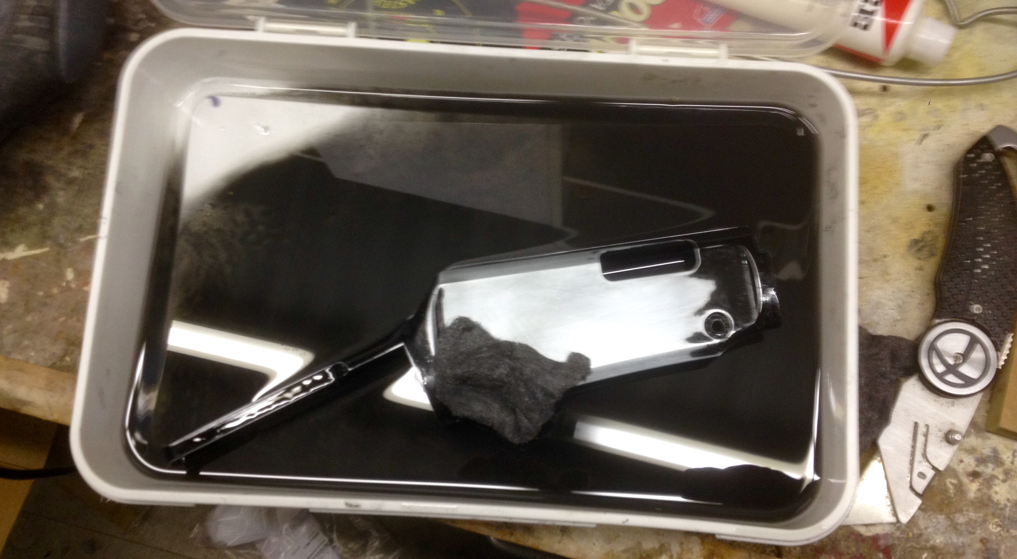

Removing the receiver cover and barrel band was pretty easy. I filled up a small plastic tray with paint stripper and sat the receiver in there. I have to admit I took a deep breath before immersing it as it was the point of no return.
I slowly and methodically worked away at the paint and it took a fair bit of effort to remove. The top coat of black removes fairly easily but there was a grey primer that took a bit more work. I also used a small bronze brush to work away at some of the tinier recesses. I also removed the bluing from the various screws.

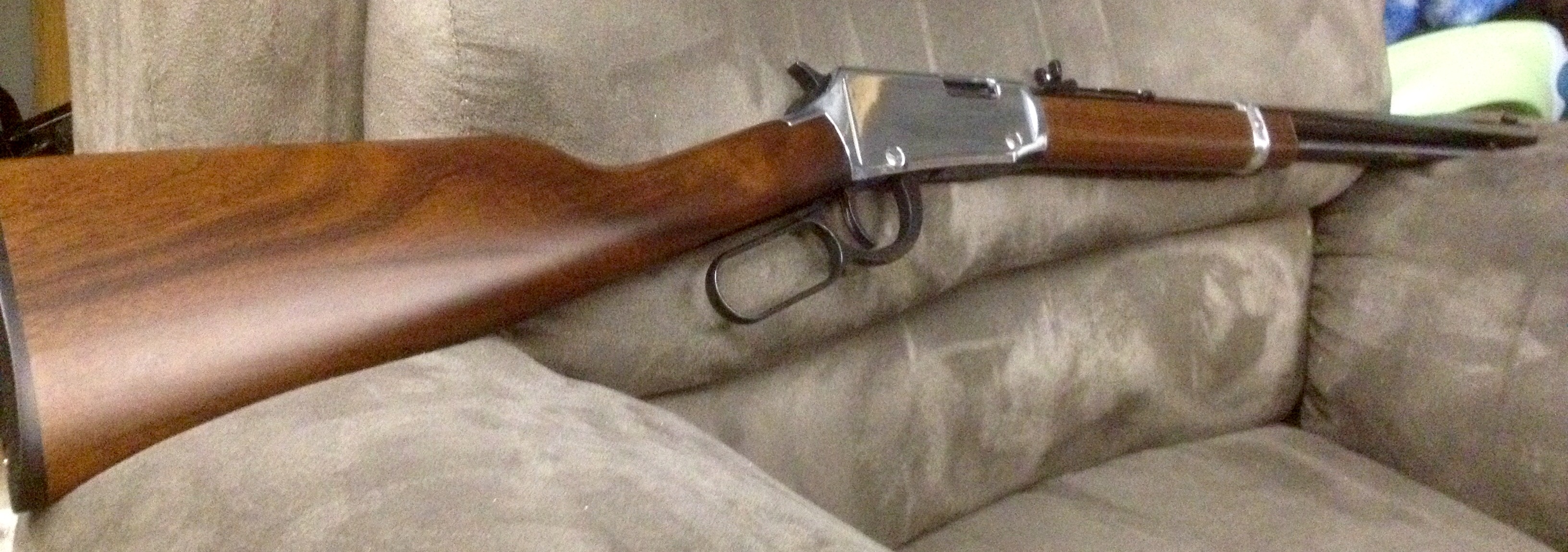

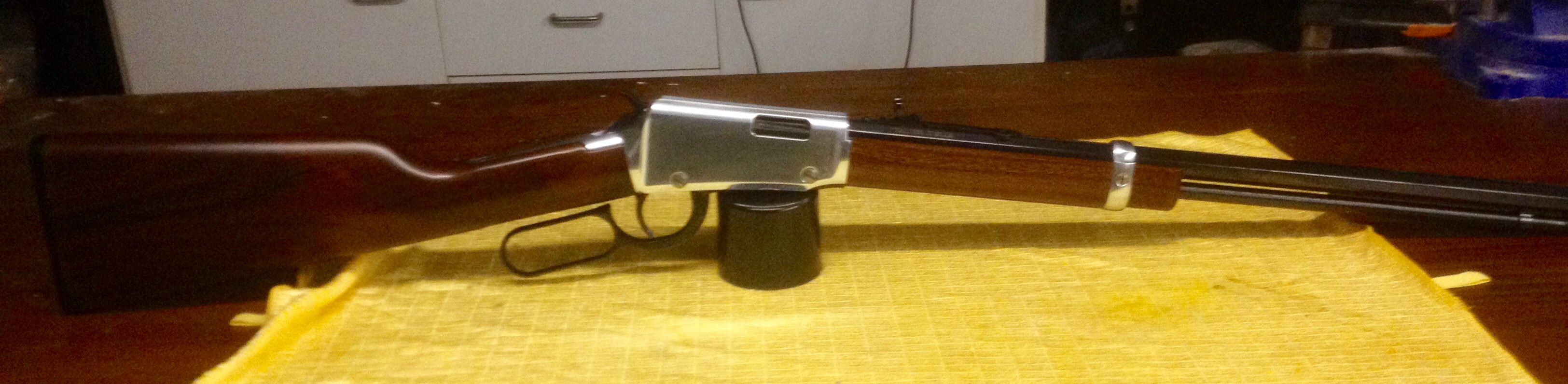

Very happy with how it turned out. I will probably take to it again with some steel wool and knock a bit of the shine off it to give it a brushed metal look. The brighter receiver also bought out the wood grain a bit. Overall , glad I did it, looks good in my opinion.

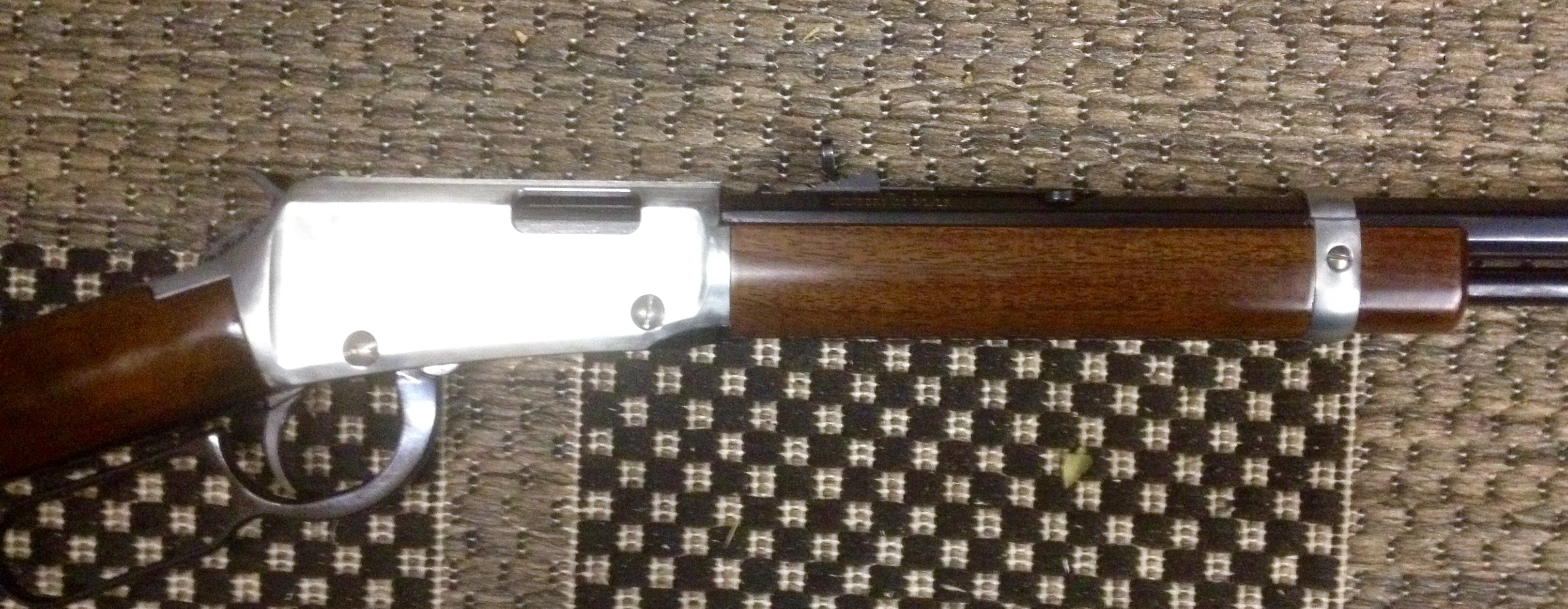

So I thought I would try it first really shiny and see how I like it. Whipped out some autosol and them some purple polish and shined it right up. Spent an hour or so in front of the tv polishing the receiver (sounds like inuendo). It came up pretty shiny. I will live with it for a little while and see how it travels.

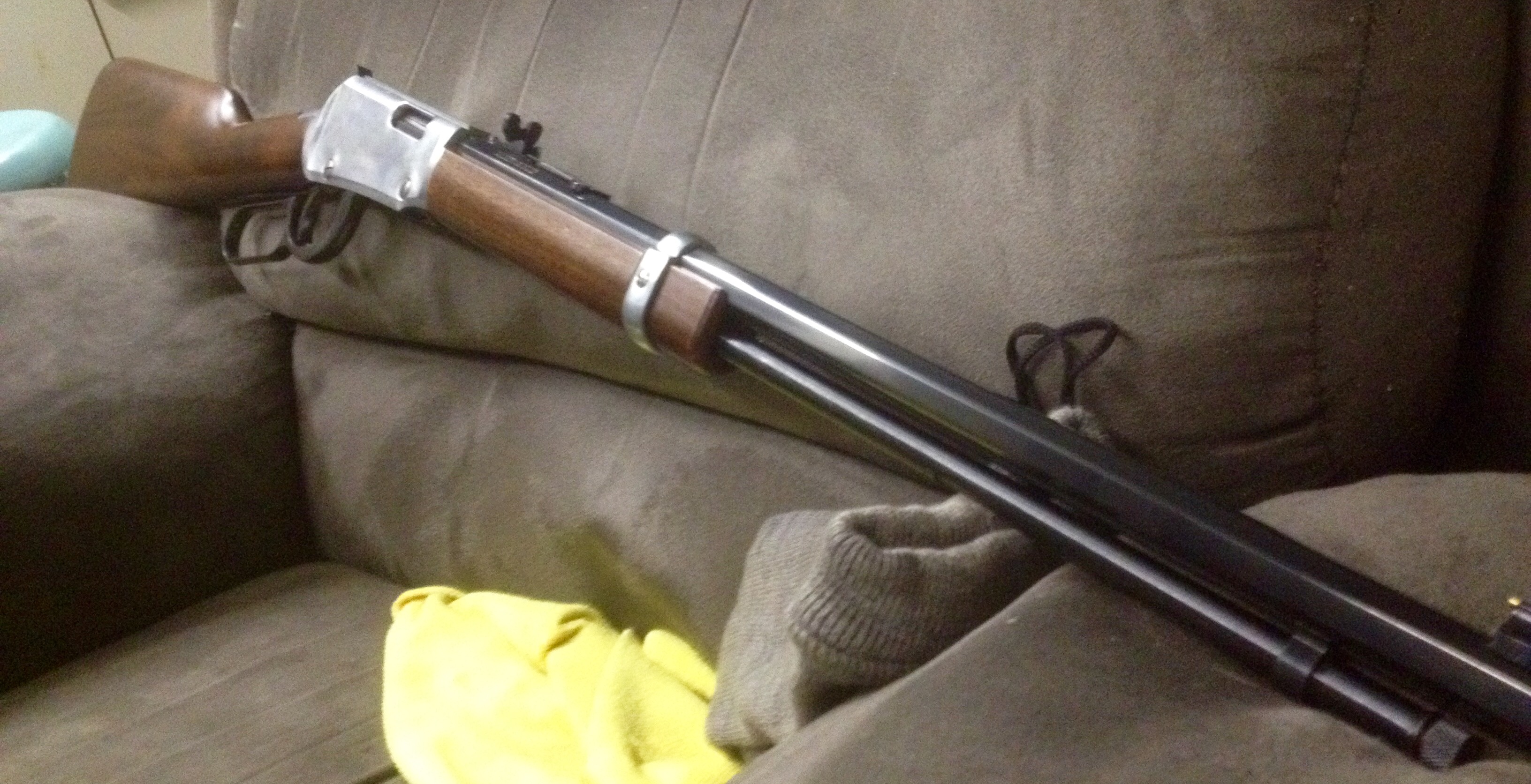

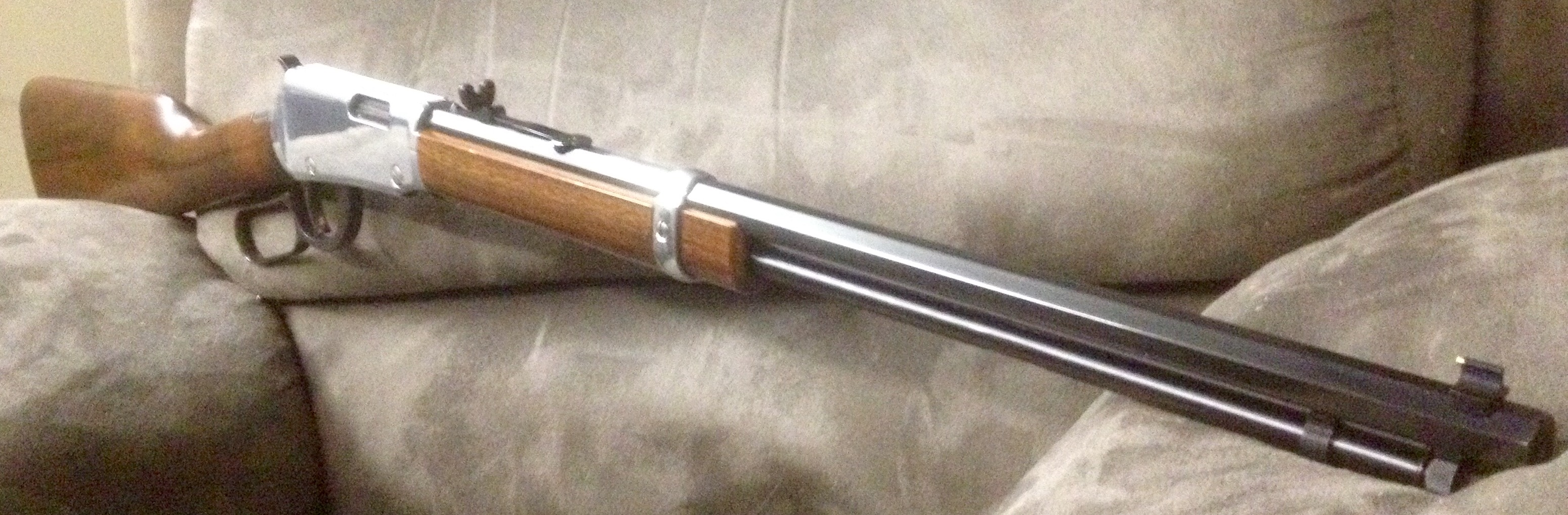

Quick update, while the initial polish came up nice and shiny, there were a few light scratches from when I stripped it. Out comes the Dremel, a small buff wheel and some polishing compound. Buffed out the scratches and was careful to polish in one direction only.
End result I'm pretty pleased with.
