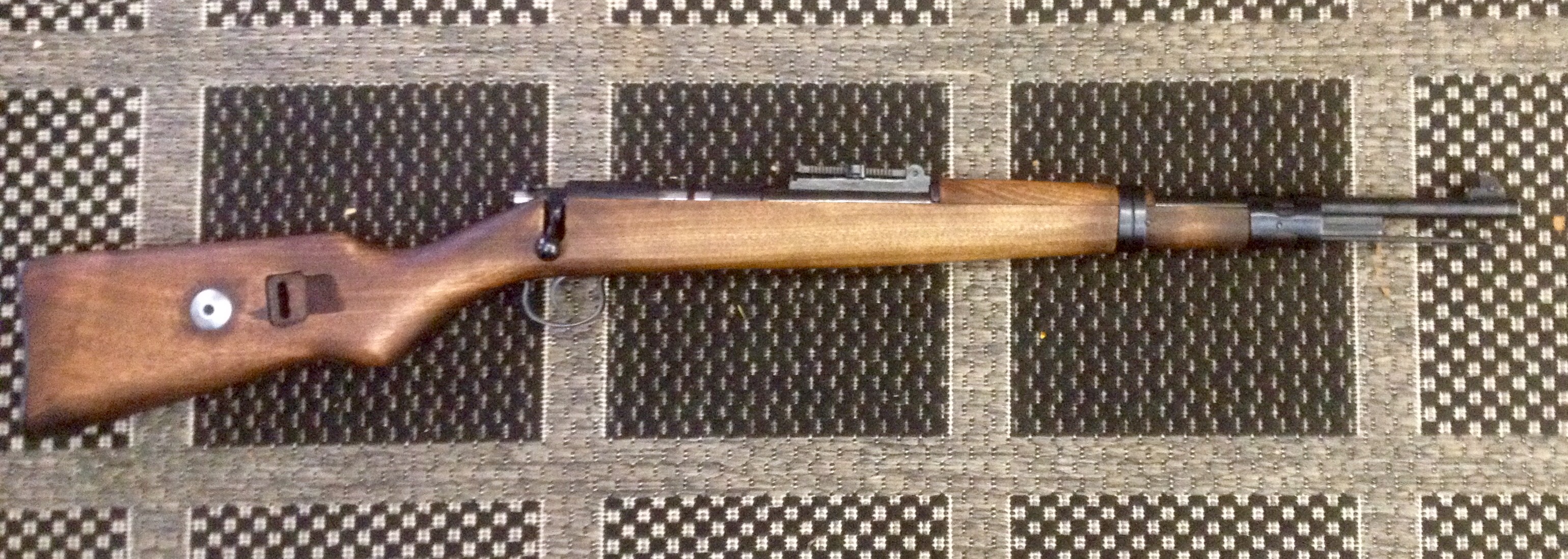

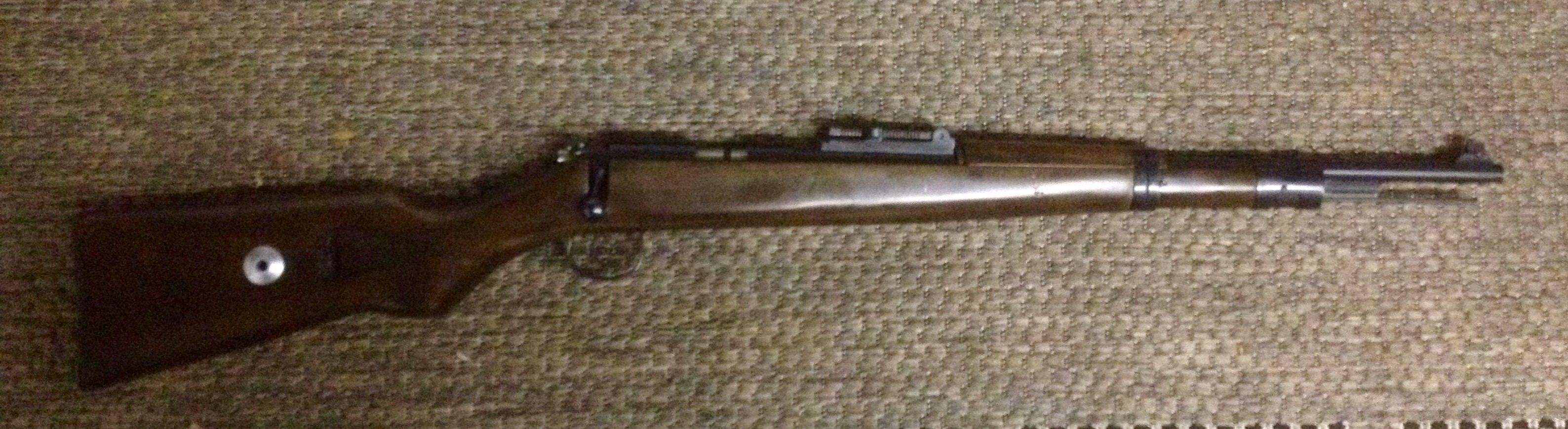

Well over the last few days I decided that my norinco JW-25 "chauser" needed to be refinished. It started with a turd brown plasticy finish that looked like it had been slapped on by a blind man. The stock did not look very timber like at all. It has bothered me pretty much since the day I bought it. I had a day off because I was a bit crook (cough, cough) so I decided the day was as good as any to do it.
I started by sanding it back and removing the old finish. The timber was some sort of mystery Asian timber, way to soft to really be a gun stock, but one of the reasons norincos are cheap I guess.
Then did the trick of wetting it down then drying it straight away with a heat gun to make the wood fibres stand up. Sand again with finer paper and repeat.
Gave it a walnut stain.
Then applied several coats of linseed oil and turps.
Then several coats straight linseed oil.
Then several coats of equal parts linseed oil, turps and beeswax
Then a final hit with a lambs wool buff pad on the drill
All up took me a few days work, and I'm pretty pleased with the result. The stock actually looks like timber now. The process aged and weathered the stock too, giving it some real character. The rifle looks a lot more "mausery" now ( yeah it's a word) .
Before
After

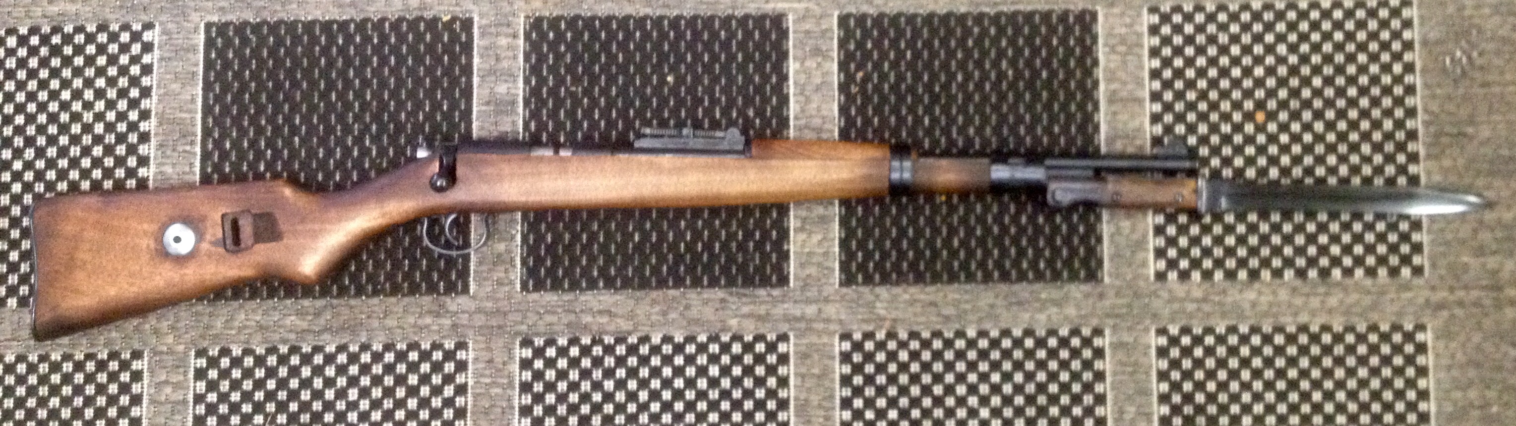

After with bayonet

Was oiled inside and out, the process has begun of building up the finish. When I have the time I sit down in the shed and rub in the BLO/turps/beeswax mix. Very therapeutic . Wood has begun to blend and darken, looking quite nice. I like to rub in the mix with a cloth, buff with a cloth and then once dried properly I often give it a hit with the lambs wool buff pad on the drill. Gives a really nice smooth semi gloss finish. Gun smells really nice now too . (Missus can't stand the stink) . I will see how it shoots now that it's been disassembled/reassembled. Might try a bedding job on it if I have somehow made it worse .

I had the bayonet for my FN Mauser , it's a Chinese reproduction. Authentic ones are a shade overpriced for my liking. I was looking at the norinco and wondered "will it fit on there" and I'll be damned it slid on perfectly. There is something ridiculous yet very cool about a .22 with a bayonet. A mini zombie apocalypse gun . The finish is coming along nicely. The oil has had time to settle into the wood and blend in the stain. The timber actually has some reasonable grain to it. Overall im glad I refinished it, looks much better. That's the thing with BLO/Turps/Beeswax, it takes time to really come good. I have thought about the Tru-oil path on several occasions, I know it's a good product but I'm just not a big fan of really shiny guns, I can however see the appeal of them to others.
