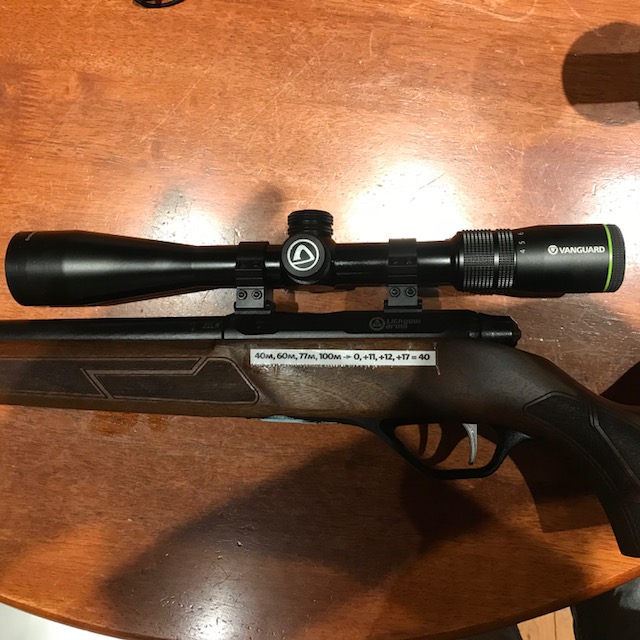

Here’s my Lithgow with a 40mm objective scope and medium leuie rings
As you can see I have a little dope sheet I once made stuck on the side for number of clicks (from 40m starting zero) for 60m, 77m and 100m - you could just as easily have it in moa if you wanted. These days I know from memory it’s around the 3moa mark, then 6moa, then 10moa - I just quickly spin it around to the appropriate number. You can easily and accurately guesstimate distances between these.

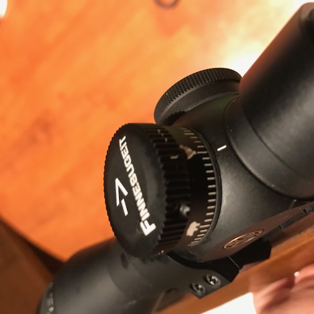

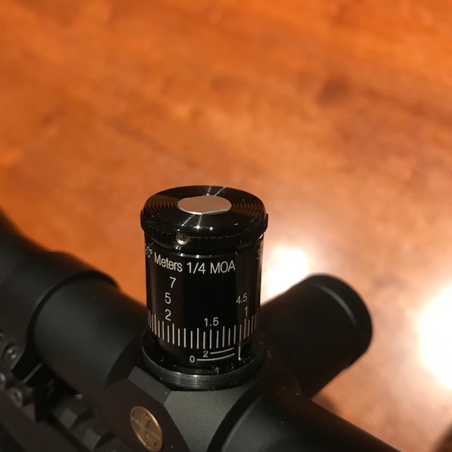

That said, these days I’m a huge fan of the Leupold CDS aka custom dial system. Buy one cry once (learned that the hard way!). Once you figure out the actual trajectory for your favorite load, you send in your ballistic information and receive a free custom dial to match it. Then it’s just a matter of rotating the dial to the required distance and you’re bang-on (pun intended). Here’s my 308w CDS:
The digits on that turret are in hundreds of meters, with 1(00m) being my zero. It has multiple rotations going all the way up to 8(00m)! That thing is deadly out to 500m with my pet 150gr load.
Then you can go full bespoke (if you pay); here’s a CDS I had made for a rimfire silhouette build:
All you gotta do is rotate to the bank that you’re currently shooting and bingo, perfect every time. Also that turret has a stopper in it preventing over-rotation so it’s 100% idiot proof (lucky for me ;)
Honestly I think a 40mm objective is more than enough for a 22lr - the importance is in glass quality. And I strongly feel the 22lr is at most a 100m caliber - the wind absolutely destroys it past 100m. That bdc reticle stuff just didn’t work well for me in reality - believe me I tried to make it work (even in comps), but I shoot best with a dead on hold and my silly wet scores reflected this. Food for thought. :drinks:
