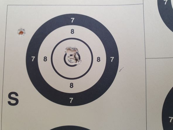

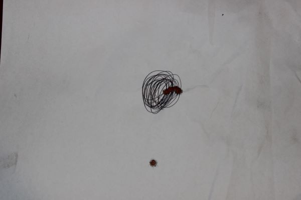

Re: 1st shot lands low
Post by MtnMan » 05 Jan 2022, 7:38 pm
went to check the zero at 50m. First shot is the low shot. the next 4 shots grouped just nicely. subsequent groups in that session were spot on with no flyers with 2 types of ammo.
As I say it has happened often enough that it has come to my attention and surely the chances of squib rounds happening most often on the 1st shot is remote.
This was with weight sorted SK Pistol match special. Being weight sorted it's even more unlikely to be a squib.

Post by straightshooter » 06 Jan 2022, 8:39 am
MtnMan wrote:went to check the zero at 50m. First shot is the low shot. the next 4 shots grouped just nicely. subsequent groups in that session were spot on with no flyers with 2 types of ammo.
MtnMan
Much of the commentary is simply uncontemplated regurgitation of various anecdotes explaining why the first shot may be "out of the group".
Your picture tells a different story.
In your case the first shot is so far out of the group that some other mechanical explanations need to be explored.
I have no experience with a Lithgow 101 whatsoever so please excuse any ignorance that may be displayed, all I know is it is a modern design with all the kitsch must-haves sought by modern shooters.
First examine the scope mounting arrangement for any sign of looseness.
There can be some compatibility issues with weaver rings used on a picatinny rail or picatinny rings used on a weaver rail if things are not sufficiently tight. This can be minimised by pushing the front ring hard forward and tightening, pushing the rear ring hard backward and tightening and only then tightening the upper ring halves onto the scope.
There can be a problem with the scope.
Less likely is a bedding issue where the barrelled action sometimes can move forward of it's true recoil stop and on the first shot recoil pushes it back into position.
If none of the above solve the problem then shooter, ammunition and ignition may need to be looked at.
Post by No1_49er » 06 Jan 2022, 9:22 am
Sorry, 'straightshooter', I think your comment may also be a bit of "uncontemplated regurgitation" (your term).
The picture shows pretty much exactly what many, including bench-rest shooters have found. I will find that forum/thread, and post a link.
Note that the op said it is the first shot.
If it was the scope, then all successive shots would be out of any group that might have been possible.
"So far out of the group"? An inch or so at worst? Exactly as has been described by many other (very serious and competent) shooters beforehand. And here, we are talking about ammunition that will consistently shoot the proverbial "bug-hole" but the first shot will never be anywhere near that group.
IT DOES HAPPEN
