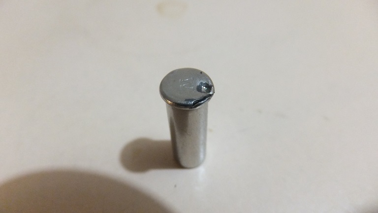

Post by rsj223 » 20 Jul 2015, 10:52 pm
It was my fault mostly, I brought some old ammo at the last shooting fair, it was nickel plated .22 ammo with a "W" stamped on the bottom as you will see in the pic if failed but what P****d me off was the rifle bolt did not contain all the failure, it felt like bits of powder hit in the side of face and the noise was extreme no plugs were used as it was "just a .22" never again.
Anyway its done now and things that teachers that have said over the years just keep repeating in my head, I think the round was faulty but not sure why or how much the bolt should have contained so whats your thoughts.

Post by sandgroperbill » 20 Jul 2015, 11:04 pm
Ruger american rimfire, right? They have a gas escape port drilled into the action in case of failure and the actions are apparently quite strong.
Without being there to experience it I probably wouldn't be too concerned

Post by rsj223 » 21 Jul 2015, 11:12 am
sandgroperbill wrote:Ruger american rimfire, right? They have a gas escape port drilled into the action in case of failure and the actions are apparently quite strong.
Yeah it's a Ruger, that port is on the left side this came out on the right along my face/cheek/ear, I'm ok with it just wish I had plugs in.
Other thing is I wanted to give this one to my kids but think I better find a better .22 any suggestions.

Post by rsj223 » 21 Jul 2015, 3:43 pm
Nioa sent me a reply and are happy to look at it, said something about checking head space?

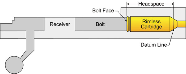

Post by Herdsman » 27 Jul 2015, 12:02 pm
rsj223 wrote:Nioa sent me a reply and are happy to look at it, said something about checking head space?
This is what headspace is if you're not familiar.
credit: http://www.forsterproducts.com/client_images/catalog19938/pages/images/Headspace_2_lg.jpg
Where it's measured from varies a little depending on the type of cartridge but you get the idea.
If the headspace is incorrect there can be all sorts of issues from closing the bolt, changing the pressure build, damaging brass and more.
Can be real dangerous in centrefire cartridges where there is a lot more bang.
If it's incorrect though it will effect all cartridges. Any other problems? How many bad out of how many good shots?

Post by rsj223 » 27 Jul 2015, 3:53 pm

Post by rsj223 » 27 Jul 2015, 3:55 pm
Herdsman wrote:This is what headspace is if you're not familiar.
Ok that could explain why there was black powder marks along sides, I would have shot at least 2000 and had 2 do the same but this one was worse.

Post by Wheelbarrow » 29 Jul 2015, 11:29 am
How far down the case do the powder marks go?
Just a mm or two or near full length?

Post by rsj223 » 29 Jul 2015, 4:08 pm
Wheelbarrow wrote:How far down the case do the powder marks go?
From memory over half way

Post by BBJ » 31 Jul 2015, 12:11 pm
More that half would be a lot. Typically it would be 2mm or so.
A bit of guesswork here as not intimately familiar with the specific rifle and ammunition but it sounds like excess headspace could be the issue.
It would explain the damaged brass, and the carbon making its way down the outside of the cases could/would be due to insufficient pressure to expand the brass to the chamber wall and seal it off against it which would be related.
I would take NIOA up on their offer to inspect.

Post by rsj223 » 31 Jul 2015, 2:54 pm
BBJ wrote:More that half would be a lot. Typically it would be 2mm or so.
NIOA have it now, will just to wait and see when it gets back to my LGS I hope its something that can been seen.
