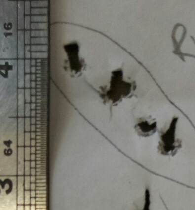

Post by Oldbloke » 29 Sep 2019, 5:19 pm
Well i had an opportunity to put a few through the Mod 2
I tried a few diff brands but RWS Club went well. Perhaps the best yet.
Shot at 50 yards. I put 10 through her prior to this group.
RWS Club @ 50.jpg (27.73 KiB) Viewed 17300 times
Free floating?
Any ideas on improving on this group?
Re: BRNO Mod 2 accuracy
Post by marksman » 01 Oct 2019, 6:51 pm
so the barrel is free floating :unknown:
I would be cleaning the bore, then fowling and try
didn't work, touch up the crown, trigger and bedding :thumbsup:
by the stringing I would call the action is bending in the stock :unknown:

Post by TassieTiger » 01 Oct 2019, 7:01 pm
That’s what -a 1 inch group at 45m ? I’d think you’d do better. My model 2 has also been cut and shut - it’s the shortest barrel I have in the safe and the lightest fire arm by a long way - kids love it and can hit swinging golf balls at 50.
Interesting - my barrel is floating BUT the stock is off centre some distance. It’s disconcerting but it shoots so I’m not touching it.
Have you tried the regular workers - CCI subs, SK magazine, Eley ?
I again agree with MM - a clean, re foul, try some diff ammo and ensure nothing is touching barrel.

Post by Oldbloke » 01 Oct 2019, 7:43 pm
No it isnt free floating. Do u blokes think i should i?
Tried
cci
Win subs
Rws. Club
Win bushman
Win power point
Few others i cant remember.
Any suggestions?
PS. Trigger is ok. No complaints
Post by Stix » 01 Oct 2019, 7:50 pm
I floated mine & it created all sorts of problems...
If you float it, try that washer trick at the same time...
I think that group looks weird so marksman is prob right...
Get that action sitting up on a washer so its free from tension...
Look at the rolled pin that houses the action screw--you can easily punch that in & out, so make sure thats not too long or too short.
Might also be worth trying with & without the front screw, & at dirrerent torqe settings.
Post by Stix » 01 Oct 2019, 7:51 pm
If you do float it & its worse, you csn just bed it up to that barrel screw to get it back...
