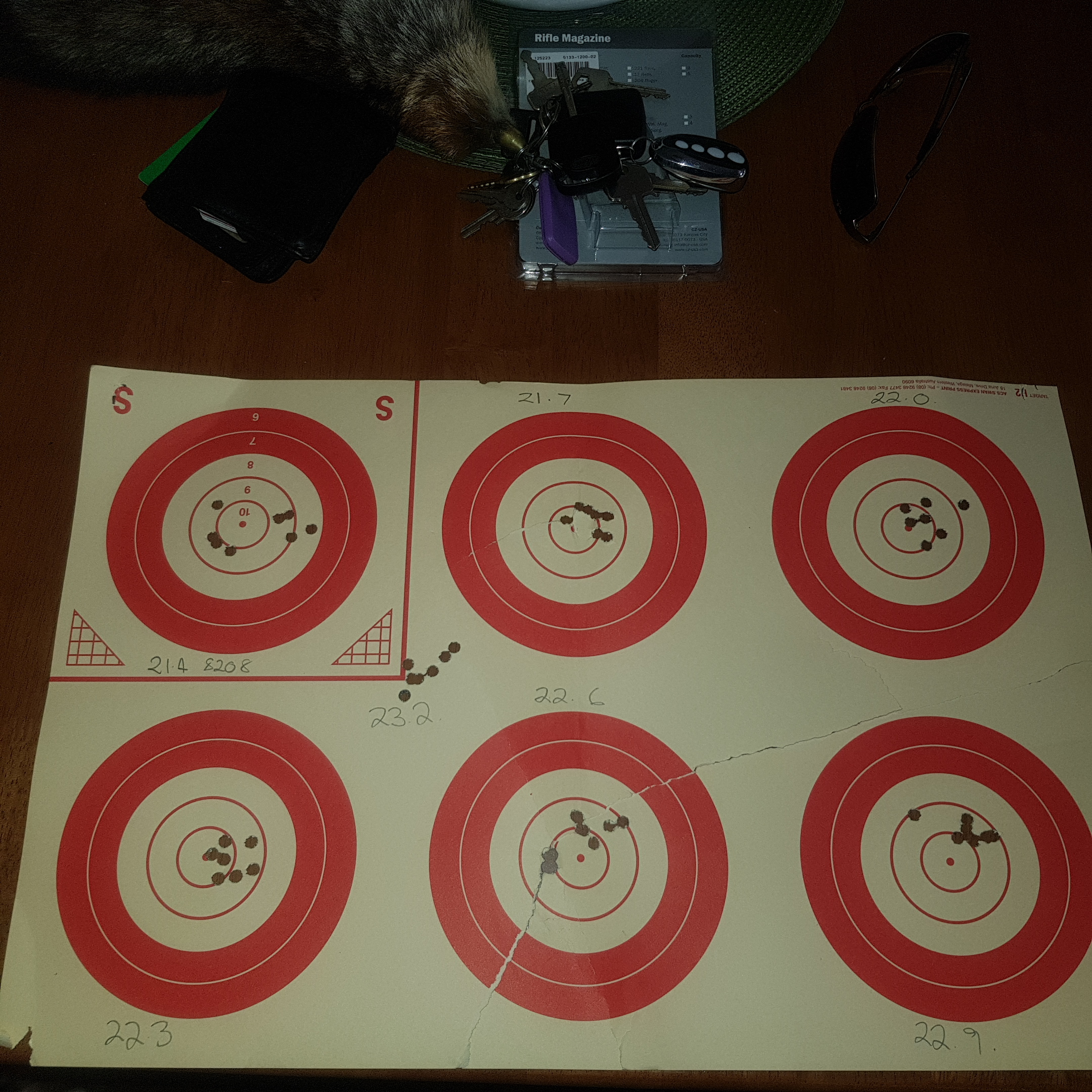

So ive had a little play around with the 62gr tap round and i uave one load in particular shows promise and with a little tweaking will be the goods. Im trying to upload a picture but so far.no luck why has it become so hard to upload pictures?

Post by AZZA'S HJ47 » 02 Dec 2018, 2:02 pm
Success finally and yes before anyone tries to tell me i ripped the sheet yes it happened. And they are 7 shot groups just to be strange .

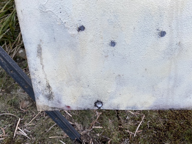

3170fps from my steyr 223 shooting these 62gns.
This plate here is at 650m and the 3 shots horizontal are my 12 yr old daughter shooting the 223 / 62gns - not a huge amount of energy at that distance, but she was also shooting on a crazy angle. The bottom impact was an 06.

That's some awesome shootin TT :thumbsup: especially for the 223. Just goes to show what the little 223 is capable of. I have a 4yr old daughter, and she is one strong-willed little character - ultimatley she'll do what she wants to do, but do I hope to one day get her into the sport. After all I need someone down in the butts! :sarcasm:

Wow your little girl can shoot better kneeling at 650m than I can shoot at a bench at 500m. You should take that kid along to some matches, you might upset some old buggers like me when she shows us how it is done.
