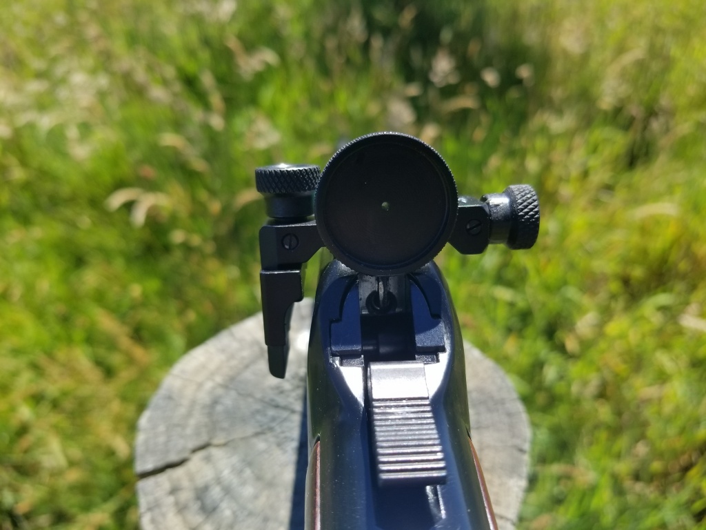

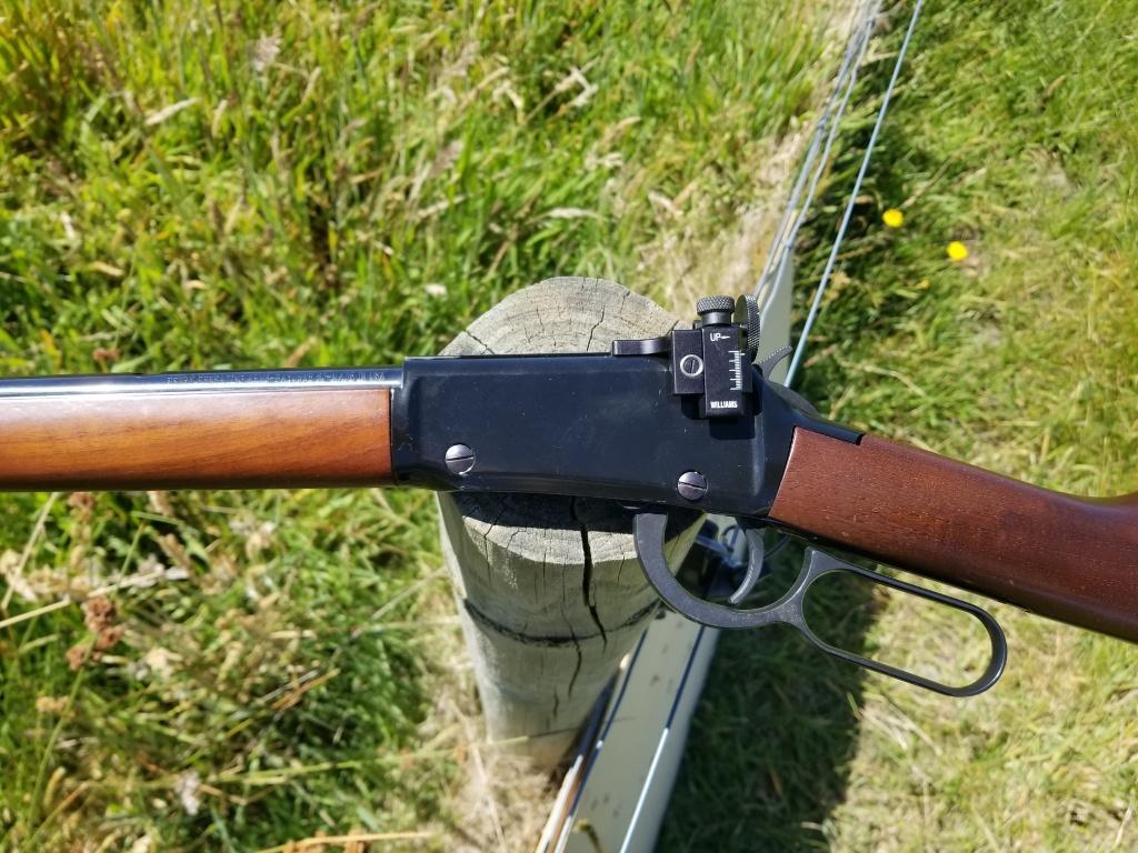

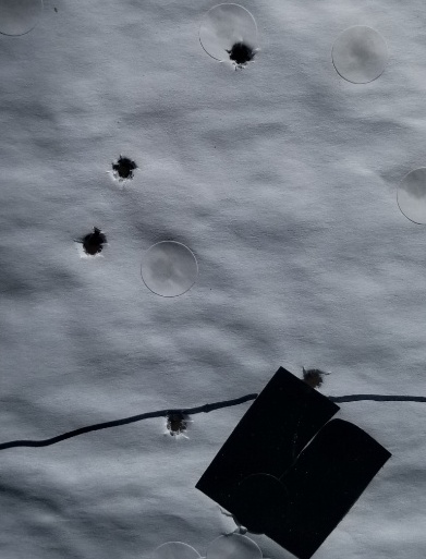

I'm not going to be able to get a William's peep sight anytime soon, so I swapped it across from the Norinco. The odd width of the Henry Dovetail makes the sight biased to the left side as the sight element is centred over a 3/8" dovetail - the Henry seems to be significantly wider, though I haven't bothered measuring it yet.

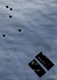

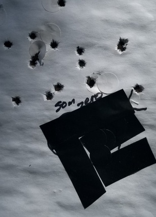

The diopter effect instantly improved the sharpness of the front sight, though it is still a little "furry". I went out and zeroed it with Eley Standard at 50m. The aiming marks are smaller than I prefer at 50m, but the first group was about 50mm left and 100mm high.
As the rear sight graduations are dependent on the sight radius of the rifle I have no idea what the clicks might equate to, but I increased the aiming point to three thicknesses of insulation tape, and dialed the knobs to get it pretty close, while allowing about 15mm of wind from the right. The elevation bottomed out early, 50mm high at 50m, very annoying as it throws out my holds.
So I fired a last group at 40m offhand to confirm and it's 50mm high there as well.
I guess it'll be close to a 75m zero.

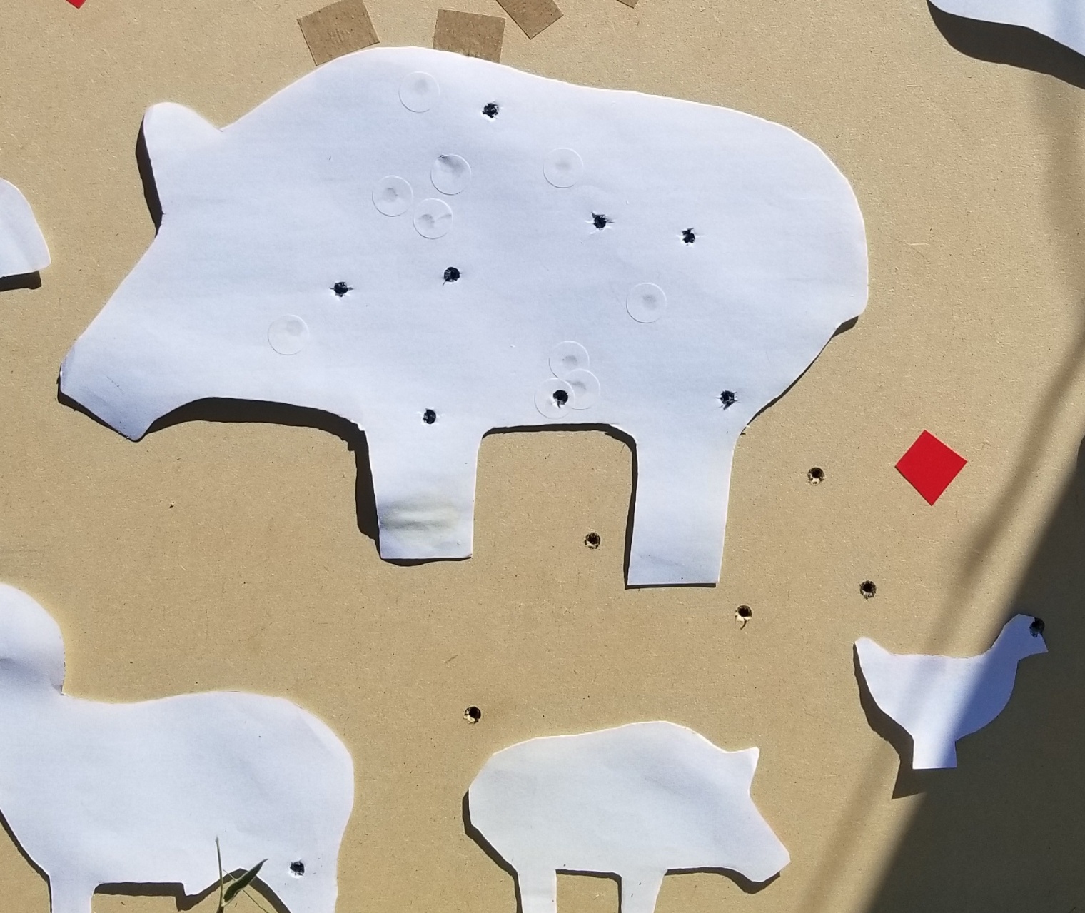

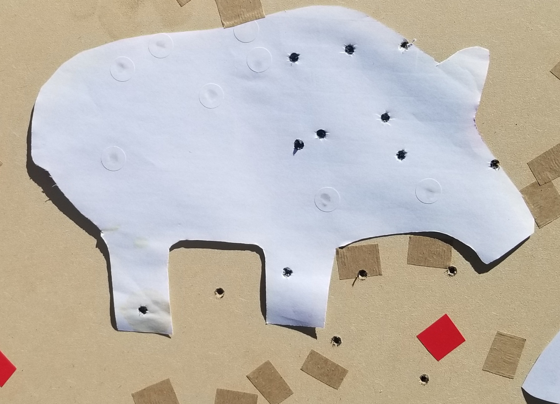

Then I went up to see what my holds are on the silhouettes. I did a lot of walking down to inspect and photograph the targets during the session to try to work out my holds.
I started at 50m on a pig, holding along the bottom of its tummy.
Eight hits wasn't too bad, but I had to come up about 50mm.
Ten hits and I'm pretty close I think, though my hold on the right-facing pig is a little too far to the right.
The fat front sight is still a little blurry making a fine hold difficult, but the bullets are going roughly where I want them.

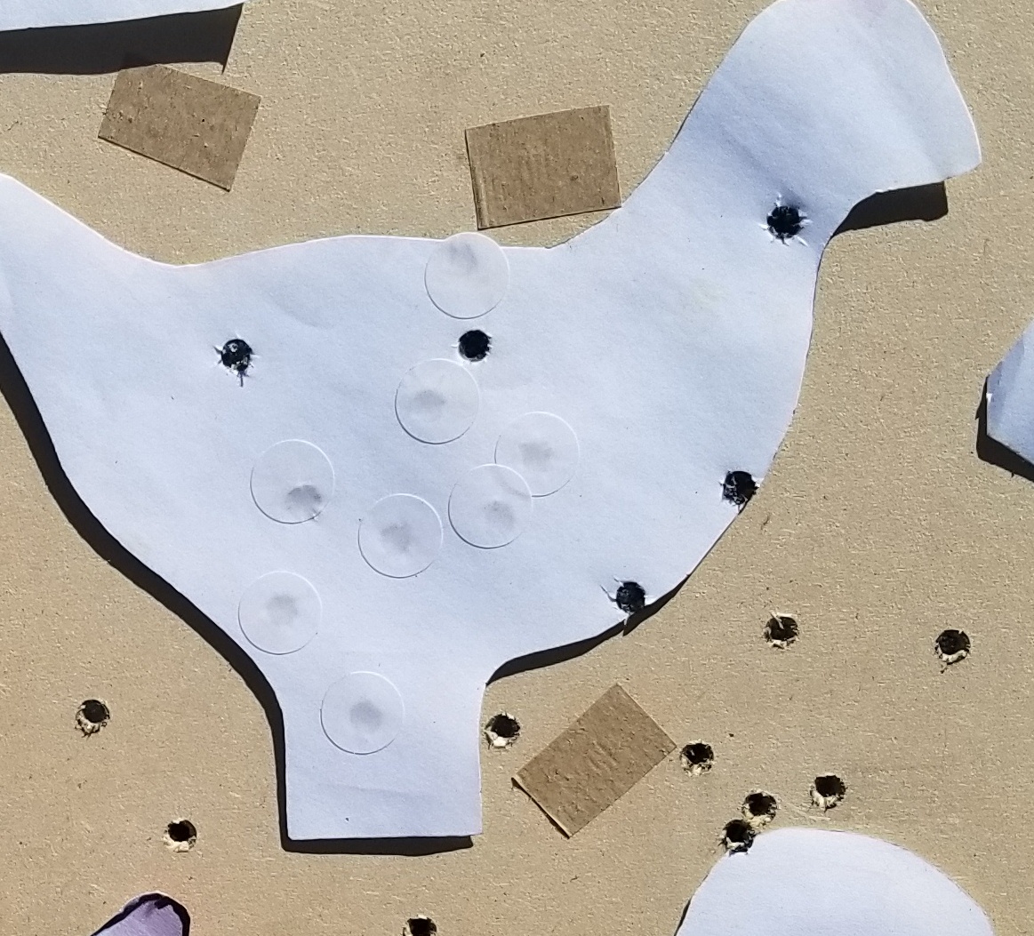

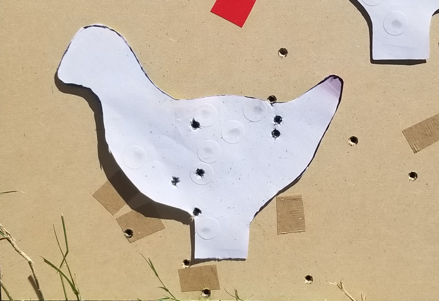

Up to 40m on the chickens, trying to hold just below the foot. Six good hits and still biased right.
Second chicken was five hits and the group is low right. So far it's not looking too bad.

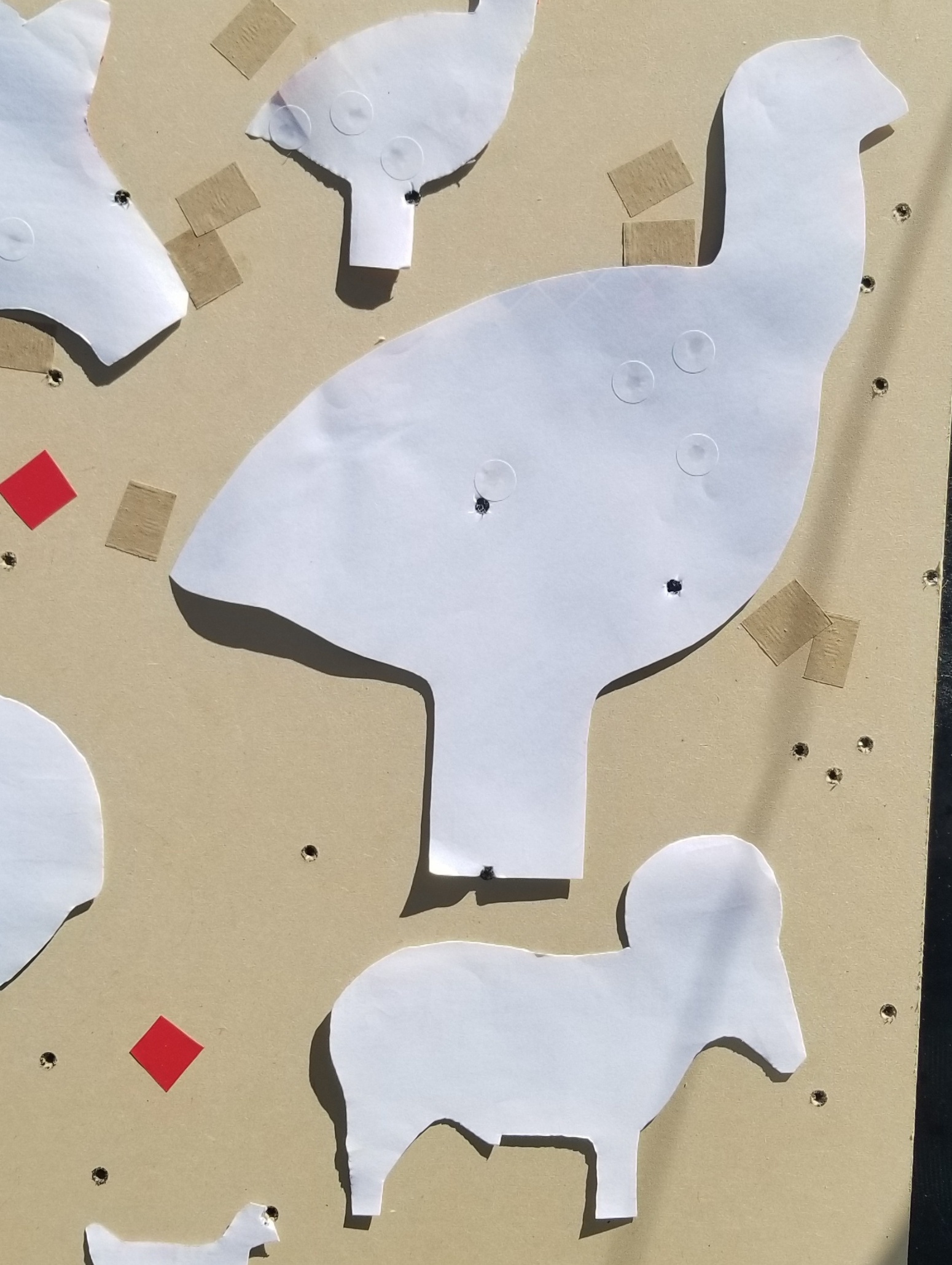

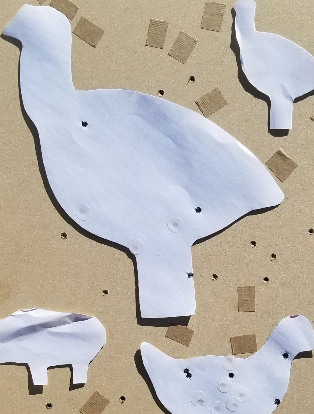

Out to 77m for the turkeys. I decided to try my reading glasses here, as they do slightly sharpen the front sight. But they don't sit where I'm looking through the lens when sighting a rifle unless I press them hard against my face. I found the glasses pushed my point of impact about five-minutes to the right, which is less than helpful :-) I would have to get prescription shooting glasses made if I want to shoot with them. I think I was taking a dead-on hold, but the group is low, and well to the right. Only three hits on each.
I didn't bring my hold up far enough, but my bullets were so far to the right that it didn't matter.

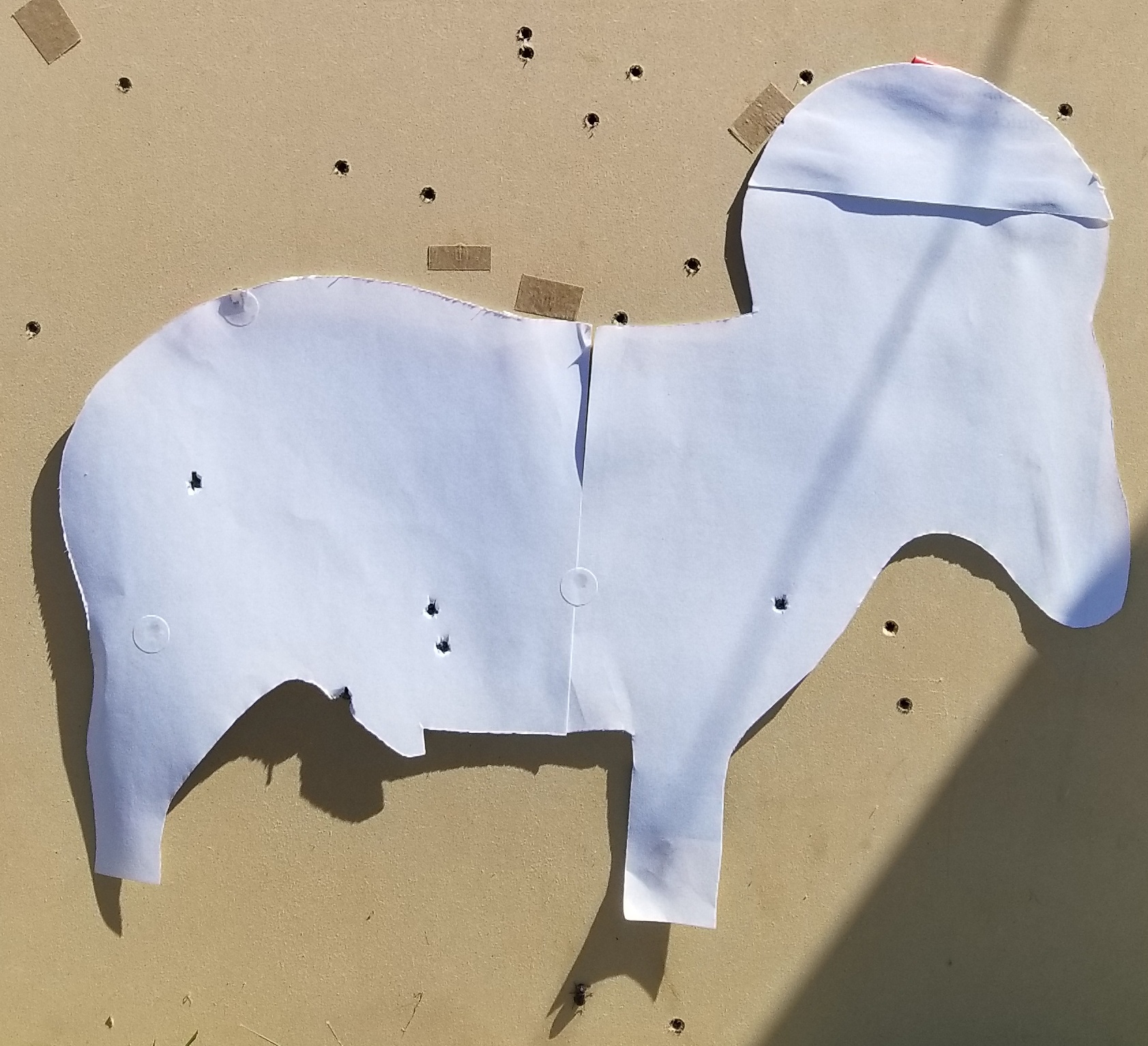

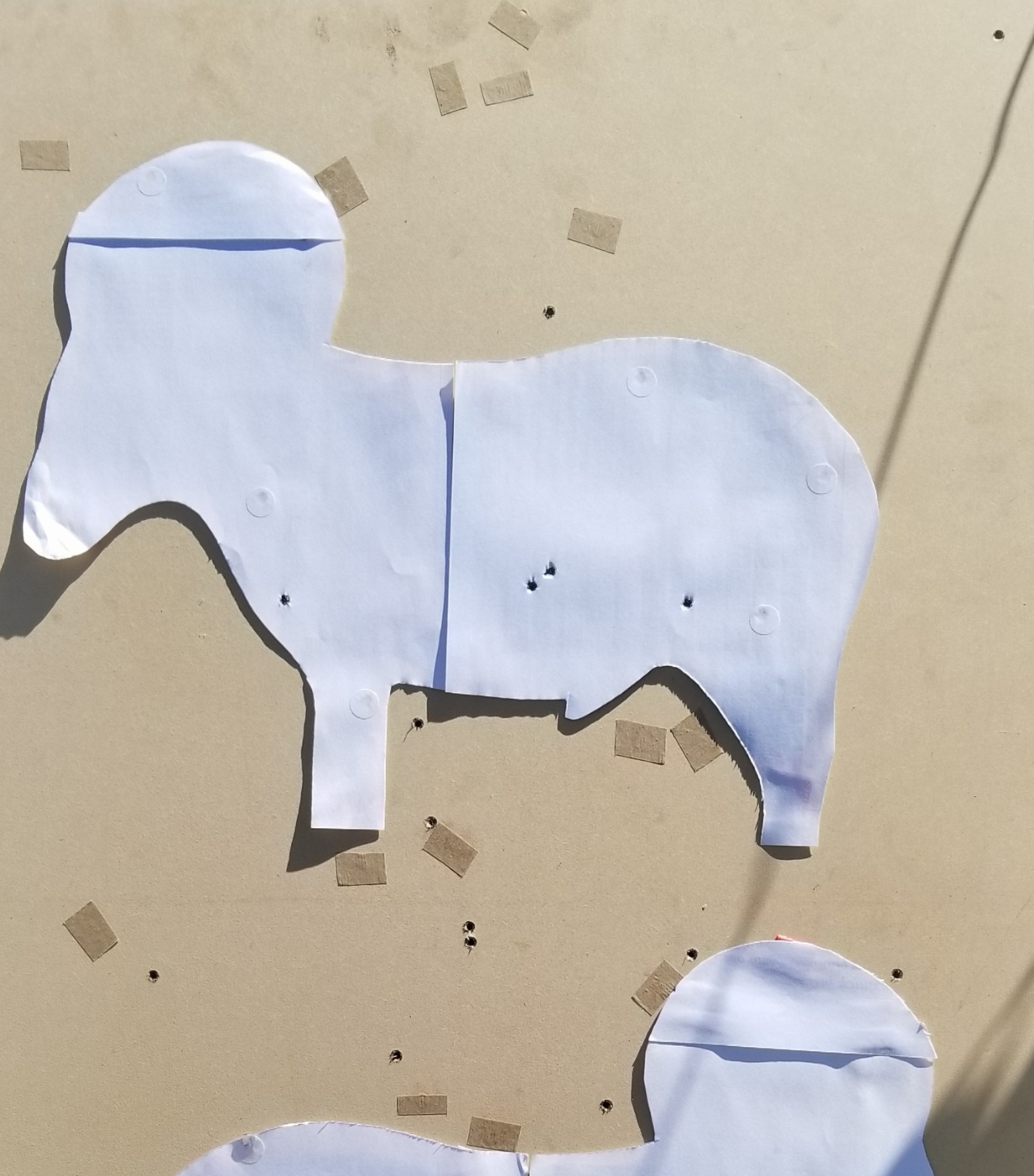

Back to 100m on the rams figuring on holding on the back or level with the horn.
Four hits, but the group was a good 100mm too low.
I came up to a random point above the silhouette and got five hits. Group placement is a little too high though so I need to work out how to find a consistent holdover on these, or make a taller front sight.

The Henry front sight is not plastic. It looks and feels like plastic, but is too heavy. I'm guessing it's cast pot-metal but it could be aluminium. It's indexed by a screw threaded into a hole in the top of the barrel, unfortunately not the same thread as AR15 sight inserts, that would've been too easy :-)
So I need to find out or measure the thread pitch of that screw/hole, then get a screw that fits it and file that down to the required height and profile. Should be easy enough.

This website even lists the front sight as plastic.

I emailed Henry in the US yesterday and asked if they could tell me the specs of the sight screw.
Two-hours later they let me know it's a #5-44, awesome customer support!
So I've ordered some screws to make a few different profiles of sight blade/post.
