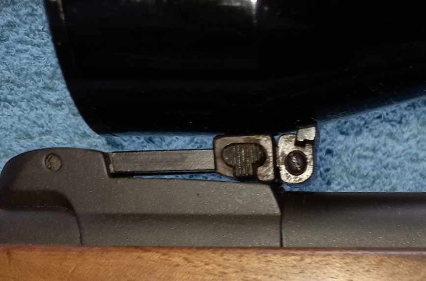

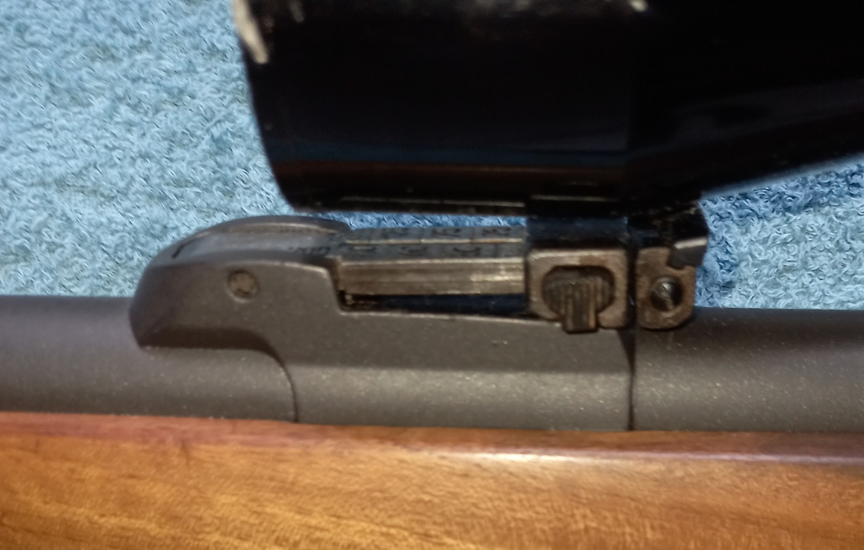

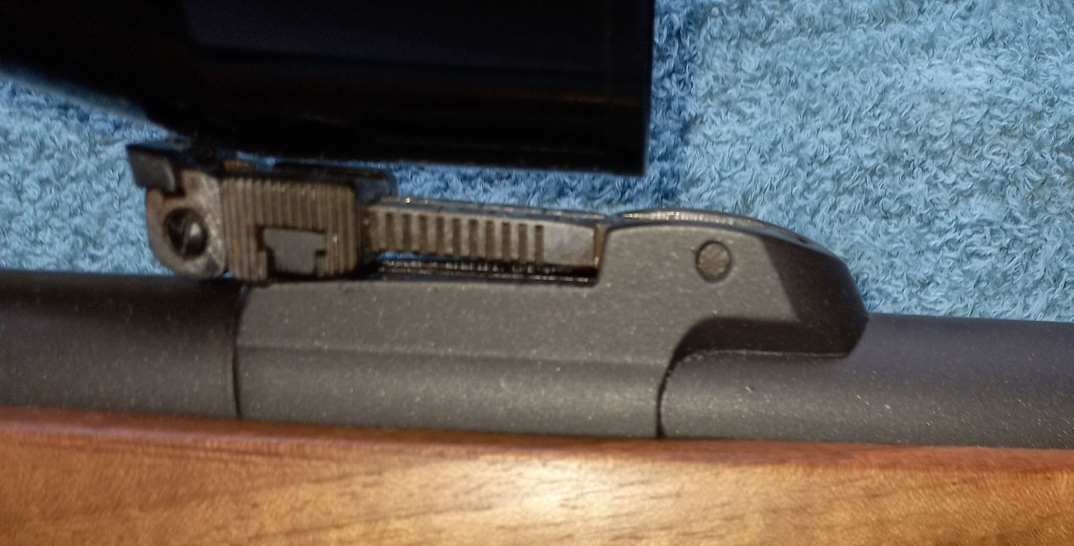

Its rubbish, but I do like it lol

I love the rifle but the sight annoys me :-)
I'm trying to make a simple ramp that can be fitted under the sight, otherwise I'll have to build up the rails and file them to shape.

Mine adjusts fine, but the ramp has no curve so adjusting it makes no difference at the target.

That would work to zero it, but not to adjust it.
The sight is graduated from 25m to 200m in 25m increments.

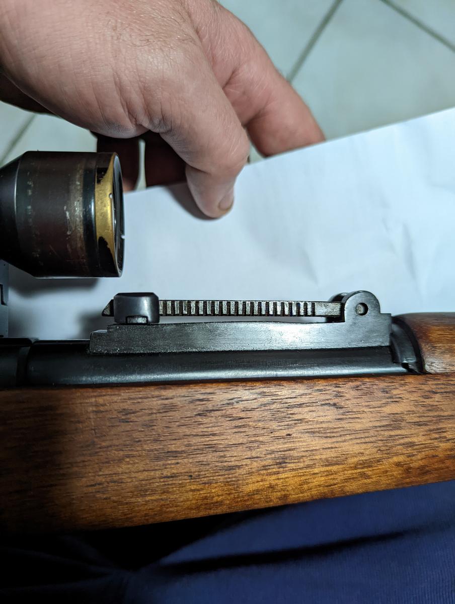

These are pics of my 1966 M2 sight.

Does it approximately follow the bullet's trajectory out to 150m or whatever it goes up to?
The JW25A is an aesthetic replica of the military ramp sight (as used on the original 1945 Brno KKW), but the ramp is basically level, so adjusting it from 25m to 200m makes no difference. It's _roughly_ zeroed at 50m regardless of the ramp position.

To be honest NFI. But the sight does rise as you would expect. I have never used the open sights.
Yours looks like it's missing the V. ?

I don't believe there's anything missing from it.
Yours looks like it's short enough and has enough curve in the ramp that it would raise the notch very well.

I know how it works, mine doesn't lift the sight at all whether it's at 25m or 200m.
It needs a curved ramp because of the circular trajectory of the .22LR cartridge. You need about 30-minutes of elevation (half a degree) to move from 25m out to 200m (with subsonic 40gn ammo).
If you look at the photo dnedative posted you can see that the pivot is above the ramp so sliding the sight forward doesn't raise it at all.
The sight needs to rise about 4mm from the 25m setting to the 200m setting.

If yours is the same as what oldbloke posted then the pivot is lower and the ramp is curved, so I would expect it to work reasonably well.

Yes, that will work for zeroing it, but I want to be able to use it out to 200m as designed so I'll have to reshape the ramps.

My M2 ramp has a curve

Yes, I'm hoping I can make a box that I can lay in under the ramp with the sides curved to follow the trajectory. This would allow me to swap in a different box for high-velocity ammo, and it avoids modifying the original sight.
