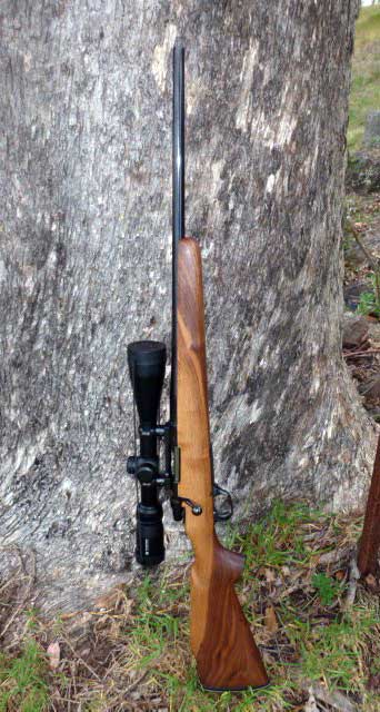

The change over is complete. I've finished off the work on the stock and inletting and changed the scope over to a 4-12x43 Vortex Crossfire whish looks pretty good so far. I've also done up the trigger and eliminated the creep although there is still a slight 2 stage feel to it. It now breaks at a nice 1.5kg. The stock has had about 8 coats of Tru-Oil sanded between coats with fine steel wool. After the final coat I rubbed it down with Rennaisance Wax. I've also fitted a thin Pachmayre? pad in place of the plastic butt cap that the stock came with. Shooting time on Wed. I'd like to post a pic but have no idea how.

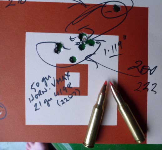

Hi Creet, it's not all that shiny mate, I rubbed the last coat of tru oil back then rubbed in the wax. It's got a sort low sheen to it and the grain is nice. Soon as I can figure it out I'll post some pics. The rifle shot a 1.16" group at 200m today so I'm smiling.

5shot group at 200m
Zastava barrel and mini Mauser action with a Boyd's walnut stock I bought unfinished

Far out grain on the stock there.
I know it's a flaw but it's kind of cool :)

Vortex on top there? :D

GO, I really like the grain in that stock, I don't know if they all come like that, but it's good value for under AU$160 all up.
Butiwanna, yes mate. it's a Vortex 4-12x43 Crossfire. I was going to get the next one up but heard some really good reports of the Crossfire.
Harper, thanks mate, I was pretty impressed with that considering the effective range of the rifle is only supposed to be 250m. That was with 50gn Vmax and 21gn 2207 and CCI BR primers, Winchester cases.
