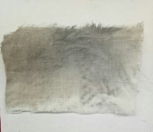

So, I reckon this is about patch # 40. Still a bit to go. Throat is still tight.
patch 40.jpg (42.32 KiB) Viewed 11718 times
Starting to wonder about never cleaning a 22lr?
