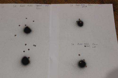

I picked up a packet of SK Pistol Match Special today and the results were crazy to say the least.
I turned 25 into HP's and gave them a try and proceeded to spray the target like patterning a shotgun!!
the 2 groups on the left were the first shots with this ammo formed into HP's.
After that shocking incident I thought I'd better try them unaltered and the difference shocked me. Of the 2 groups on the right the top one is with round nose as they come and the bottom group is with the DIY HP's.
To confirm, I shot another group with stock ammo.
Conclusions were-
1- It shoots good as is but it's not a hollow point for hunting like I want.
2- DO NOT DIY HP!!!

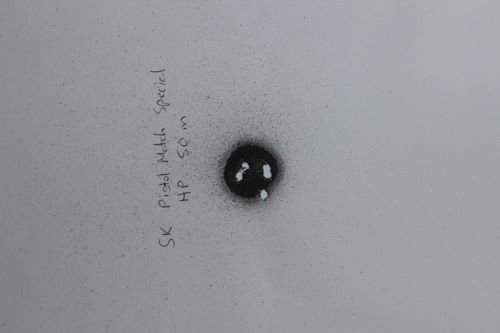

There's been an interesting development.
After forming some WIN super suppressed into HP's they shot like crap too. I knew then that something was up and went looking for the problem. Turns out the die was full of crud from the batch of WIN high velocity power points I reformed. These have a crusty coating on the bullet and the die had a substantial amount jammed in there and it was causing the rounds to be shortened considerably as the crud was incompressible.
After cleaning the die the WIN super suppressed went back to normal accuracy. Then it dawned on me that the SK pistol match special HP ammo that was shooting like crap was formed in the dirty die. So I tried another little batch in the clean die and BOOM! problem solved.
here's the only 5 shot group with it after the die clean. Amazing difference. This may well be what I'll settle on along with the WIN super suppressed for subsonic HP ammo.

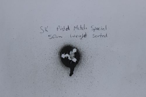

I forgot that the last group I showed here with the SK pistol match special HP's wasn't weight sorted. So i weight sorted the last dozen or so I had left in the box and shot another group. Weight sorting into matched batches certainly tightens up the groups.
