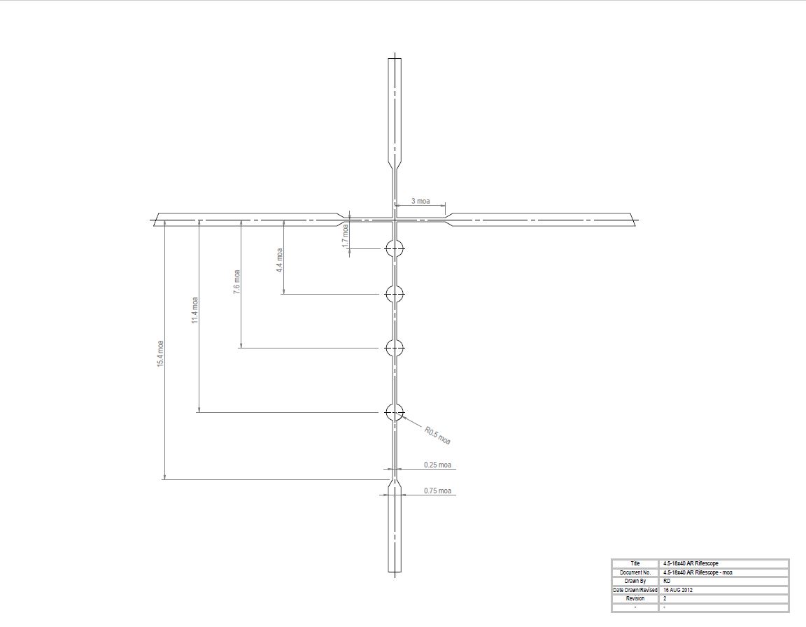

A duplex has one holdover - the top of the duplex post is probably at 3MoA but could be up to five to eight minutes from what I've seen. If you zero a hunting rifle high at 100m then you can have your bullet maybe 50mm high at 100m, on zero at 200m, and on the duplex at 300m. Shoot it and learn your reticle.
By shooting a lot of .22LR in difficult winds I am gaining enough experience with wind that I rarely use the wind metre anymore. But I do set up a plate at 100m and put a shot on that if I've lost the wind, if it tells me I'm hitting four-minutes to the left at 100m I move back out to the longer distance, hold four-minutes to the right and I should be on or very close. If I can see a visible difference in the wind between the two points I can adjust the hold to suit.
Elevation hold increases with range, wind hold does not. Though that doesn't mean the wind hold is going to be the same at 300m or 600m as it is at 100m. The wind is "alive", and changes during the flight of the bullet. With .22LR I have had a 3MoA right wind hold at 100m and needed a 1MoA left wind hold at 200m.
This is my reticle.
Bushnell AR Optics 4.5-18x40 223BDC reticle.JPG (45.48 KiB) Viewed 6743 times

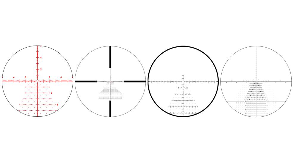

This is an example of some of the more intrusive reticles, that give you little useful information.

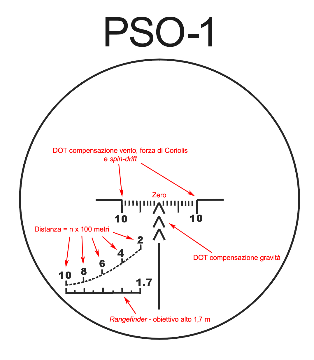

The famous SVD reticle that has simple wind and elevation holds and adds a rudimentary range finder.
Put a person's feet on the line and where his head meets the curved line gives you the range in metres.
