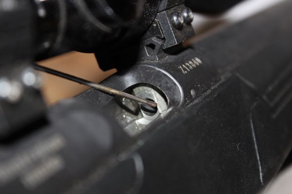

just cleaned the bolt under the extractor, the chamber and bore and lightly oiled the chamber. Now it ejects live SK but not fired SK. Also won't eject live Win super suppressed all of a sudden. really starting to piss me off now. I'm starting to suspect that on closing the bolt that the extractor is wedged away from the case by the contact with the breech face.

I'm suspecting that the extractor is hitting this angled face of the breech and being pushed away from the case rim. I'm thinking that the slightest touch from a dremel to create the smallest of recesses for the point of the extractor hook to sit into, so that it can move closer to the centerline of the bore and engage on the case rim. I think the extractor hook can't get in right behind the rim. variance in case rim thickness or diameter will exacerbate the problem I'm experiencing.
you can see here at the end of the pointer where I think a recess should be made to allow better extractor engagement on the case rim.
It actually looks like a small ridge at the edge of the chamber like that face hasn't been milled completely flat.
What say you?

MtnMan wrote:just cleaned the bolt under the extractor, the chamber and bore and lightly oiled the chamber. Now it ejects live SK but not fired SK. Also won't eject live Win super suppressed all of a sudden. really starting to piss me off now. I'm starting to suspect that on closing the bolt that the extractor is wedged away from the case by the contact with the breech face.
MtnMan wrote:I'm suspecting that the extractor is hitting this angled face of the breech and being pushed away from the case rim. I'm thinking that the slightest touch from a dremel to create the smallest of recesses for the point of the extractor hook to sit into, so that it can move closer to the centerline of the bore and engage on the case rim. I think the extractor hook can't get in right behind the rim. variance in case rim thickness or diameter will exacerbate the problem I'm experiencing.
What say you?
If it was working fine before it seems unlikely these angles and clearances could change.
Have you cleaned out the extractor recess?
My JW21 tends to shave lead off the bullets and that debris can fill up the recess causing extraction issues if I don't keep it clean. It's the only rifle I have that needs cleaning every 300rds to keep it running because of the debris that gets into the action. I use dental picks dipped in grease.

Well I took a Dremel to the breech face to create a relief enough to accommodate the extractor which helped because it was hitting the breech face and being wedged away from the rim. I guess that's a function of head spacing. Now it can sit in and engage the rim positively.
The thing that got it working was lubing the chamber and cartridges with case lube. This got the SK PMS going from 0% extraction of fired rounds to 100% extraction of fired rounds.
It fixed the Win super suppressed that was playing up too.

MtnMan wrote:Well I took a Dremel to the breech face to create a relief enough to accommodate the extractor which helped because it was hitting the breech face and being wedged away from the rim. I guess that's a function of head spacing. Now it can sit in and engage the rim positively.
Be sure to wear safety glasses when you test fire it after taking metal out of the extractor recess. That metal supports the case pressure, if it fails the case will rupture and vent the gas back toward you.
Lubing the brass sounds like a bandaid fix, find out what is causing the cases to stick in the chamber and fix that.
