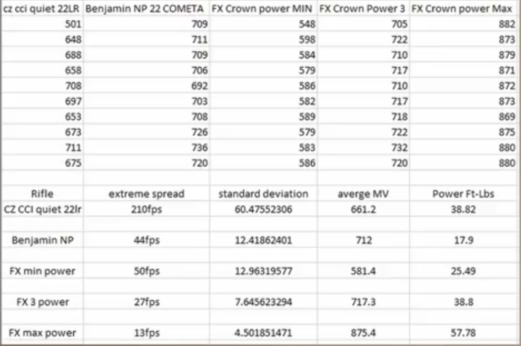

On the subject of low noise around smallish acreages, I did a stack of research on the topic, and ended up settling on the long barrelled CZ 452 Lux. I think barrel length is 28, or maybe 28.5”. Apparently that last few inches of barrel really absorbs the sound signature - It is very noticeably quieter using standards compared side by side with a standard barrel length ... which for all intents and purposes make identical ammo seem like HV when compared shot for shot with the Lux. You can happily shoot all day with these without muffs, although the bloke that shot em inside his house without the missus hearing must have a hell of a big house!!
A word of warning though... whilst I just lurve CCI quiets, probably one in three in the Lux result in the slug staying in the barrel ... last inch and a half or so. I restrict these to use to the other rimfires in the safe, and for ultra low noise in an old 25” single shot, which is stupid quiet with the round, and quieter that the Diana Panther springer chucking the .177’s out at around 1000 FPS. I think one of the channels I researched mentioned this may be a problem in the ultra long barrels. Short story is to make damned sure you can account for your projectile before shooting another ... or there may be consequences.

Post by bladeracer » 29 Jul 2019, 8:36 am
meawls wrote:On the subject of low noise around smallish acreages, I did a stack of research on the topic, and ended up settling on the long barrelled CZ 452 Lux. I think barrel length is 28, or maybe 28.5”. Apparently that last few inches of barrel really absorbs the sound signature - It is very noticeably quieter using standards compared side by side with a standard barrel length ... which for all intents and purposes make identical ammo seem like HV when compared shot for shot with the Lux. You can happily shoot all day with these without muffs, although the bloke that shot em inside his house without the missus hearing must have a hell of a big house!!
Interesting. I wonder if the noise signature is only reduced for the shooter though (being a few inches further away), maybe it's the same as any other .22LR for people hearing it from other than the shooter's position?

Having son and wife check from the side and from the rear, the reduction is validated Blade. I’m then able to verify it for myself having a mate doing the shooting. I wish I could justify the $5 or 600 that an instrument grade decibel meter sets one back - it’d be terrific to confirm the subjective!!
Absolutely beautiful and useful stats on your previous post btw ...

I just watched these videos.
He had a shot with the .22LR at 415fps, then ran a pull-through and got 501fps. Then the velocities settled from 648fps to 711fps. He dropped the 415fps shot as an anomaly but kept the 501fps so it would drastically skew the result. He gives it an ES of 201fps by including the anomaly, when the following nine consecutive shots have an ES of 63fps, then complains the ammo is poor quality.
Interesting that the FX power settings had no effect on the noise output, despite a difference of 300fps.
