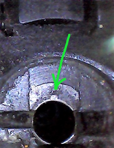

Post by on_one_wheel » 31 Jul 2019, 6:58 pm
My cz 452 has a witness mark on the back of the barrel from the pin smacking it.
I wouldn't do it deliberately, but it dose happen now and then when I go for that 6'th shot with my 5 shot magazine.
My cz pin witness mark

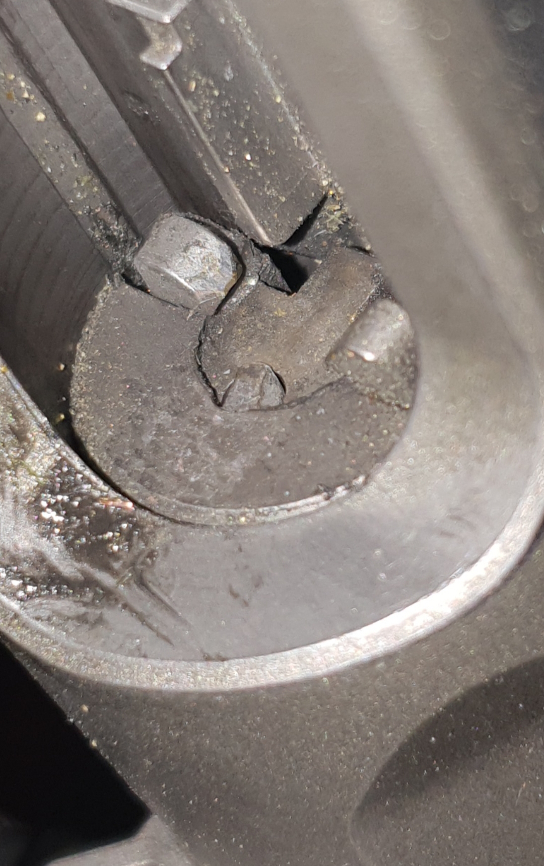

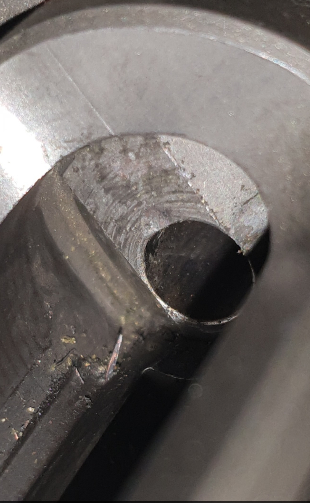

Post by james13 » 30 Oct 2019, 6:48 pm
This is one of the Lithgow bolt and chambers from a club rifles that are about 2 years old. They might get dry fired 20-30 times a day.
Lithgow bolt
Lithgow bolt
james13
Posts: 1
Re: Dry firing a rimfire
Post by allan » 01 Nov 2019, 2:22 pm
Best example I've ever seen to illustrate why repeated dry firing 22LR is not such a bright idea.
Thanks for posting.
Post by FNQ » 03 Nov 2019, 1:55 pm
Never intentionally dry fired a rimfire. Center fires all the time.
Was coming around to the idea of dry firing the rimfire but not after seeing the Lithgow photos.
Thanks james13
