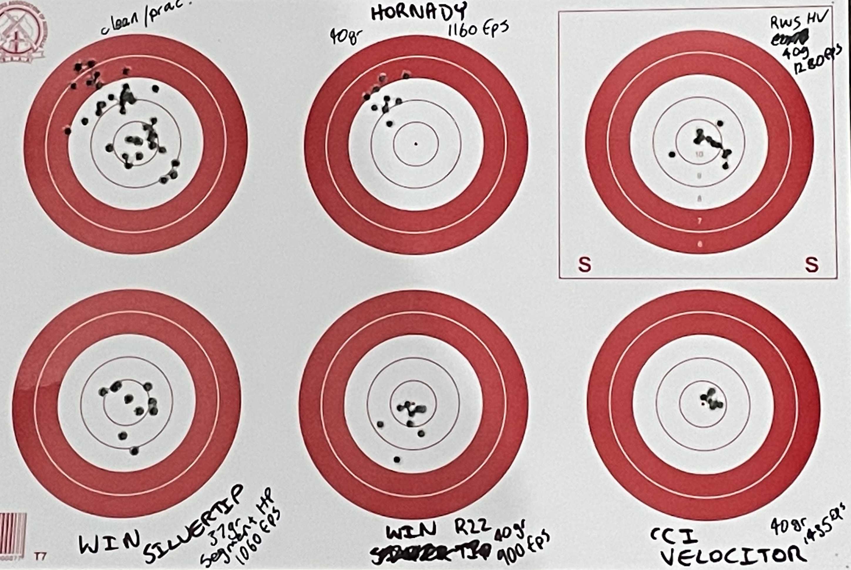

Post by ash_hendo » 23 Mar 2022, 9:28 pm
For fun I tried some radically different speed ammo at the 50m range at St Mary's last week, from 900-1435 (from spec, not chrono), All were reasonable, but the real surprise was how well the 1761 liked the CCI Velocitors (1475fps). Gave a much bigger crack than the other bullets. Almost could be a go to bullet for hunting and Target shooting!! 10 rounds under 1cm at 50m was about what I was getting with my previous favourite (cci standard). Shows the potential of this nice unit. I'm sure someone who could shoot really well with a tuner could get all the bullets almost in the same hole...... all groups are 10 rounds.except the clean target where I "warmed up" the gun to each new lot of ammo..... Ignore POI shift as I had a rough guess at changing it based on what was happening on practice target, I assume normally there would be a much bigger POI shift between 900's and 1435 fps rounds.....
ash_hendo

Re: Anschutz 1761 - First impressions
Post by on_one_wheel » 24 Mar 2022, 5:57 am
ash_hendo wrote:For fun I tried some radically different speed ammo at the 50m range at St Mary's last week, from 900-1435 (from spec, not chrono), All were reasonable, but the real surprise was how well the 1761 liked the CCI Velocitors (1475fps). Gave a much bigger crack than the other bullets. Almost could be a go to bullet for hunting and Target shooting!! 10 rounds under 1cm at 50m was about what I was getting with my previous favourite (cci standard). Shows the potential of this nice unit. I'm sure someone who could shoot really well with a tuner could get all the bullets almost in the same hole...... all groups are 10 rounds.except the clean target where I "warmed up" the gun to each new lot of ammo..... Ignore POI shift as I had a rough guess at changing it based on what was happening on practice target, I assume normally there would be a much bigger POI shift between 900's and 1435 fps rounds.....
Awesome results with the 1475 CCI's :thumbsup:
Post by Bello » 24 Mar 2022, 6:45 am
Congrats on the rifle
Those CCI Velocitors seem like the ticket
Post by Larry » 26 Mar 2022, 11:03 am
Getting ammo that is the correct MV to suit the node of your barrel is one thing the other that I think may be the larger factor is getting ammo that is the right size ie length for you chamber.
Posts: 939
Post by ash_hendo » 28 Mar 2022, 7:35 pm
Larry wrote:Getting ammo that is the correct MV to suit the node of your barrel is one thing the other that I think may be the larger factor is getting ammo that is the right size ie length for you chamber.
Interesting point, I also hear talk about match chambers being more fussy but better when you get something it likes, I've heard the 1761 can't take Stingers etc because of the match Chamber.too.
