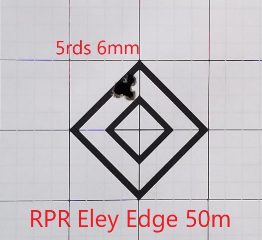

I put 310rds through my Ruger Precision this arvo, including my best ever 50m group - 5rds in 6mm.

That's an outstanding group man
Pwoah

My previous best was 7mm with CCI Std Vel, this one might be worth putting on the wall though :-)
