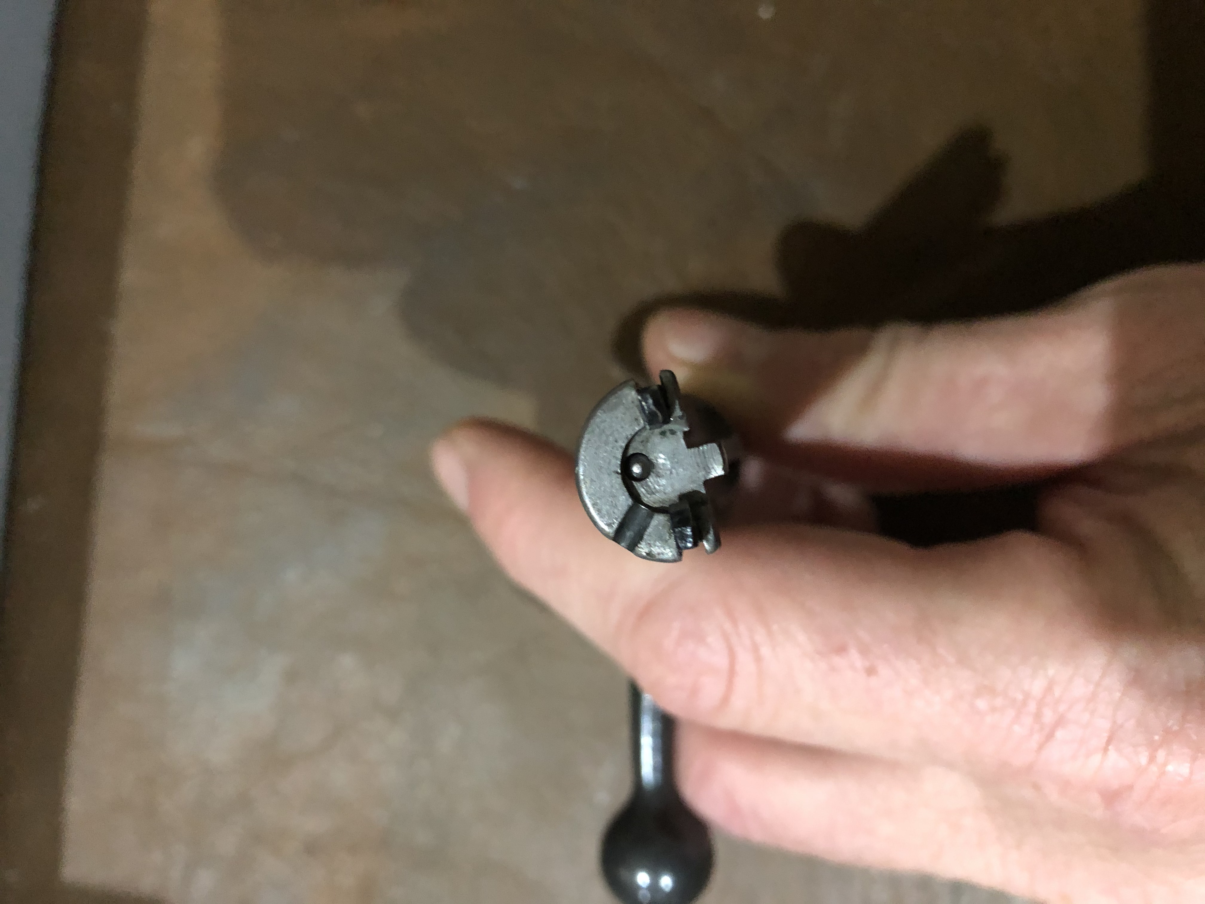

Any pics would help
Re: Anschütz 1450 Firing pin issues

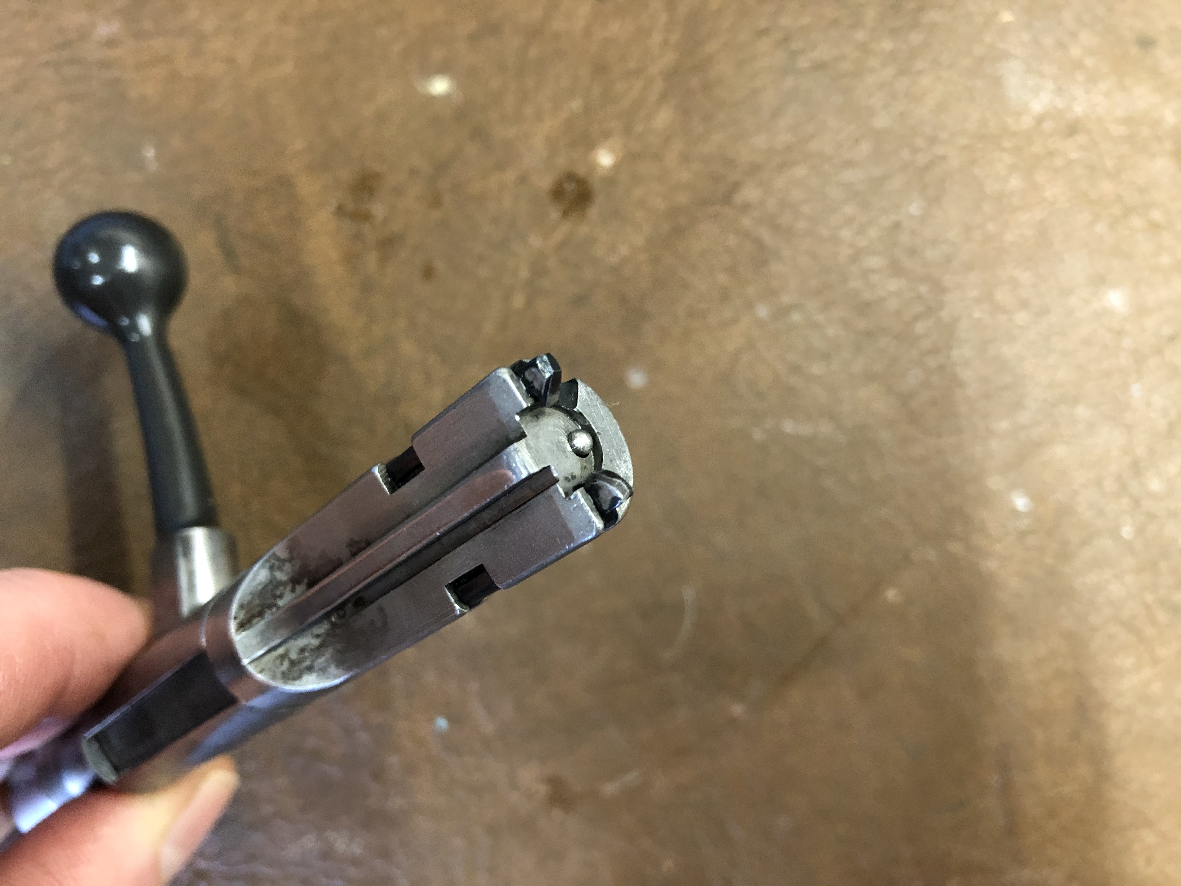

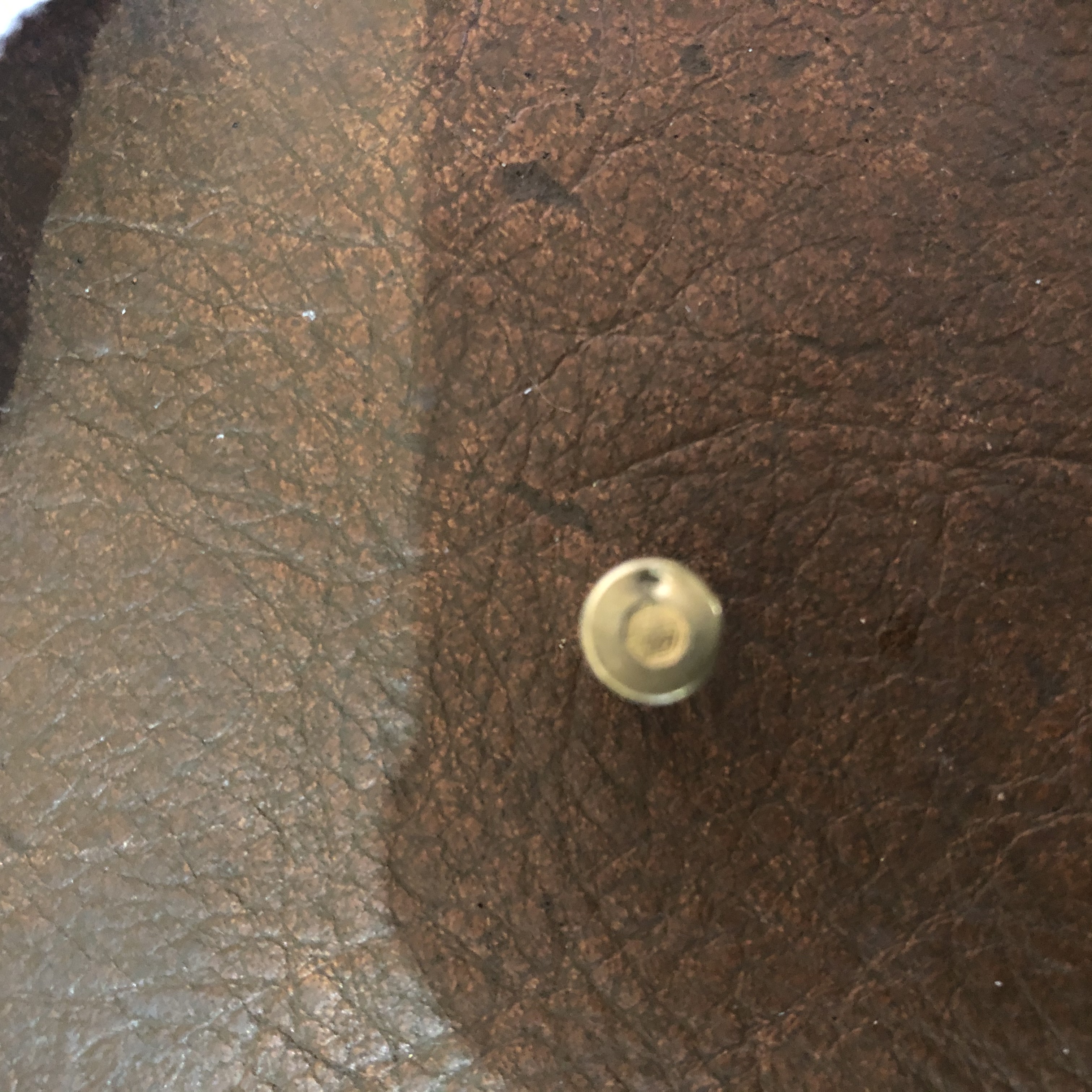

Post by martin » 11 May 2020, 2:50 pm
Tried to load some pics, nothing seems broken .. maybe some wear ...
Hopefully an assembly error
martin
Posts: 6
South Africa
Post by Oldbloke » 11 May 2020, 3:23 pm
Pic of the case not too clear. I assume dent is the shiny dot. I notice the firing pin is pointed. The 3 rimfires Ive had were all chisel shaped. I wonder if that is normal/original?

An in-focus closeup of the dented rim on the case and one of the end of the firing pin would be useful.
Check that a small corner or other piece hasn't broken off the firing pin, ideally remove it from the bolt for closer inspection.
I've also never seen a rimfire that has a round or pointed firing pin tip, they have always been very clearly chisel shaped and probably about 5 times longer then they are wide.
A new firing pin is probably what you need.

From what I can see online, the Annie firing pin is supposed to be rounded and not chisel shaped so yours seems normal.
A possibility is a build-up of crud inside the bolt that is stopping the pin from moving forward sufficiently. I know you say you've cleaned the bolt but have you stripped it and got inside with a bronze brush and solvent? Just a thought - apologies if you've already covered that.
Did this arise before or after cleaning? Double check assembly if it was working before cleaning/dis-assembly.

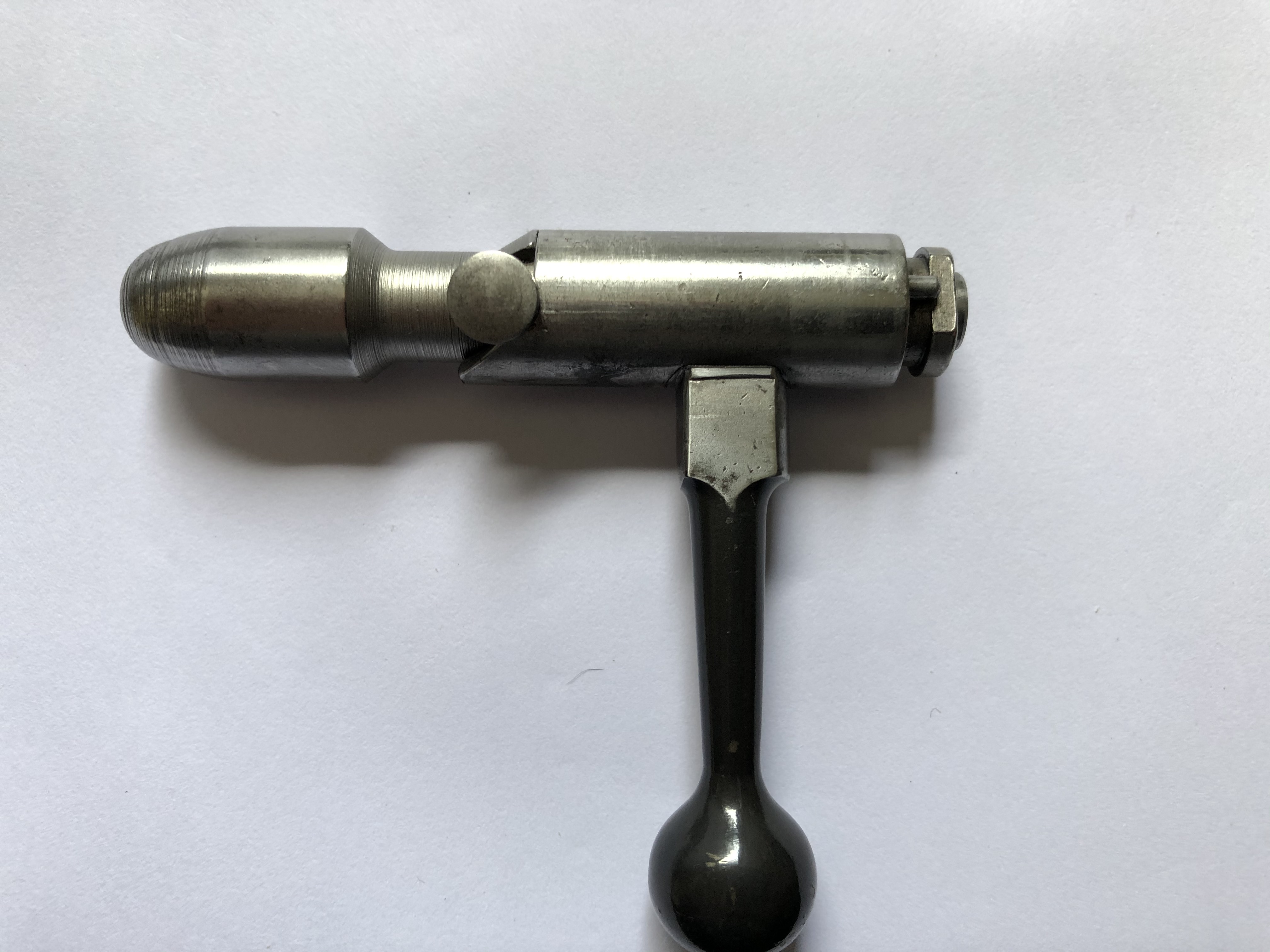

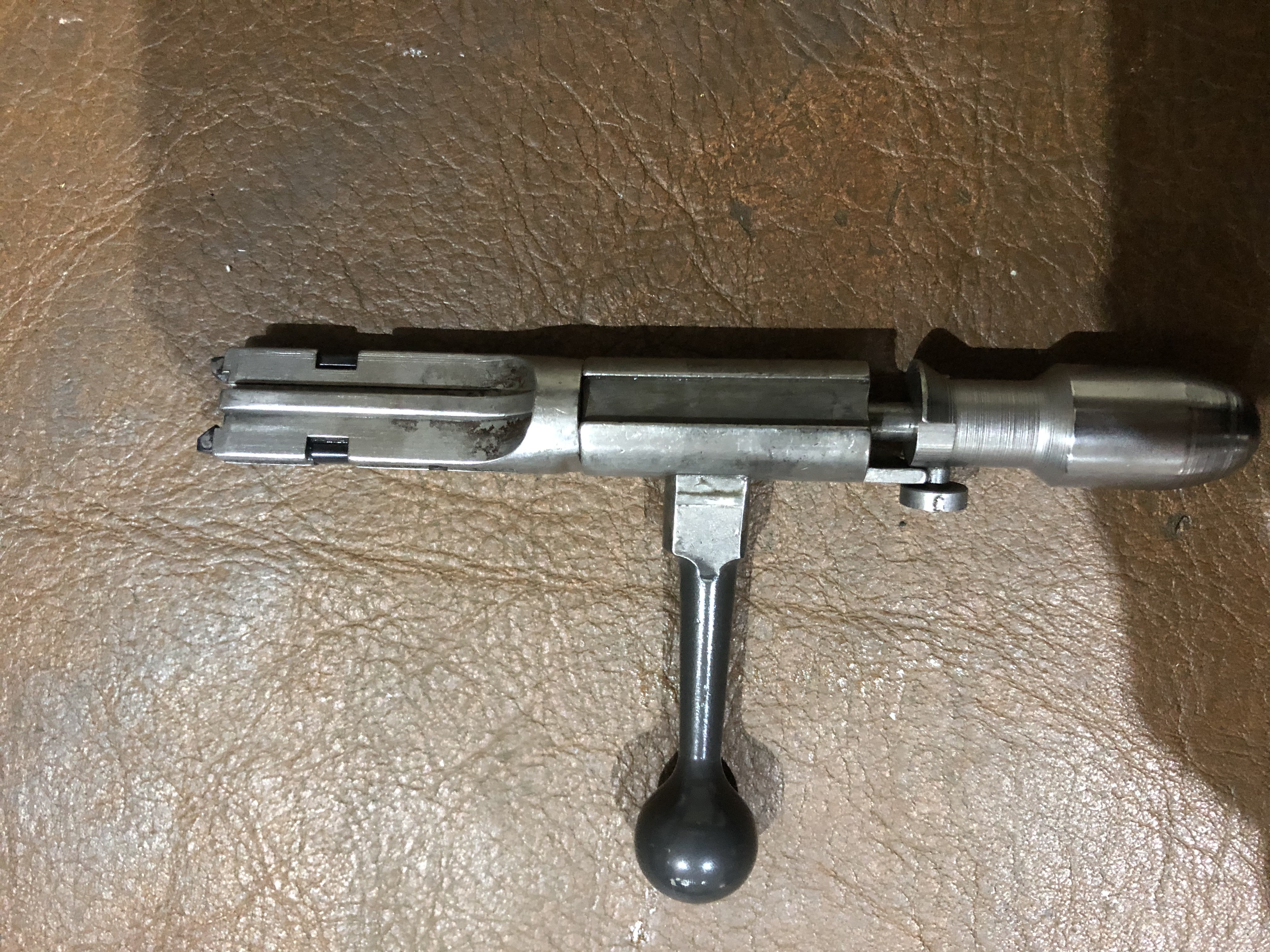

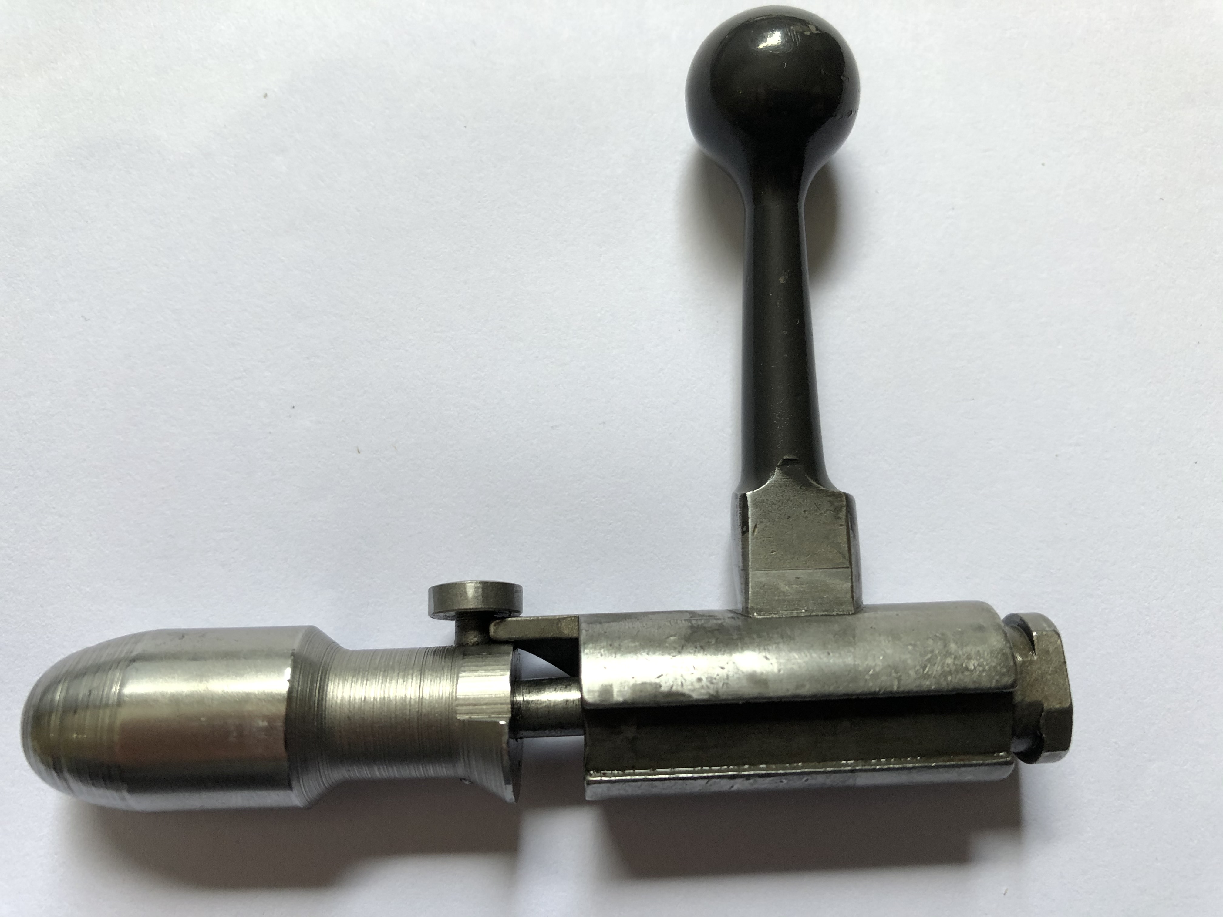

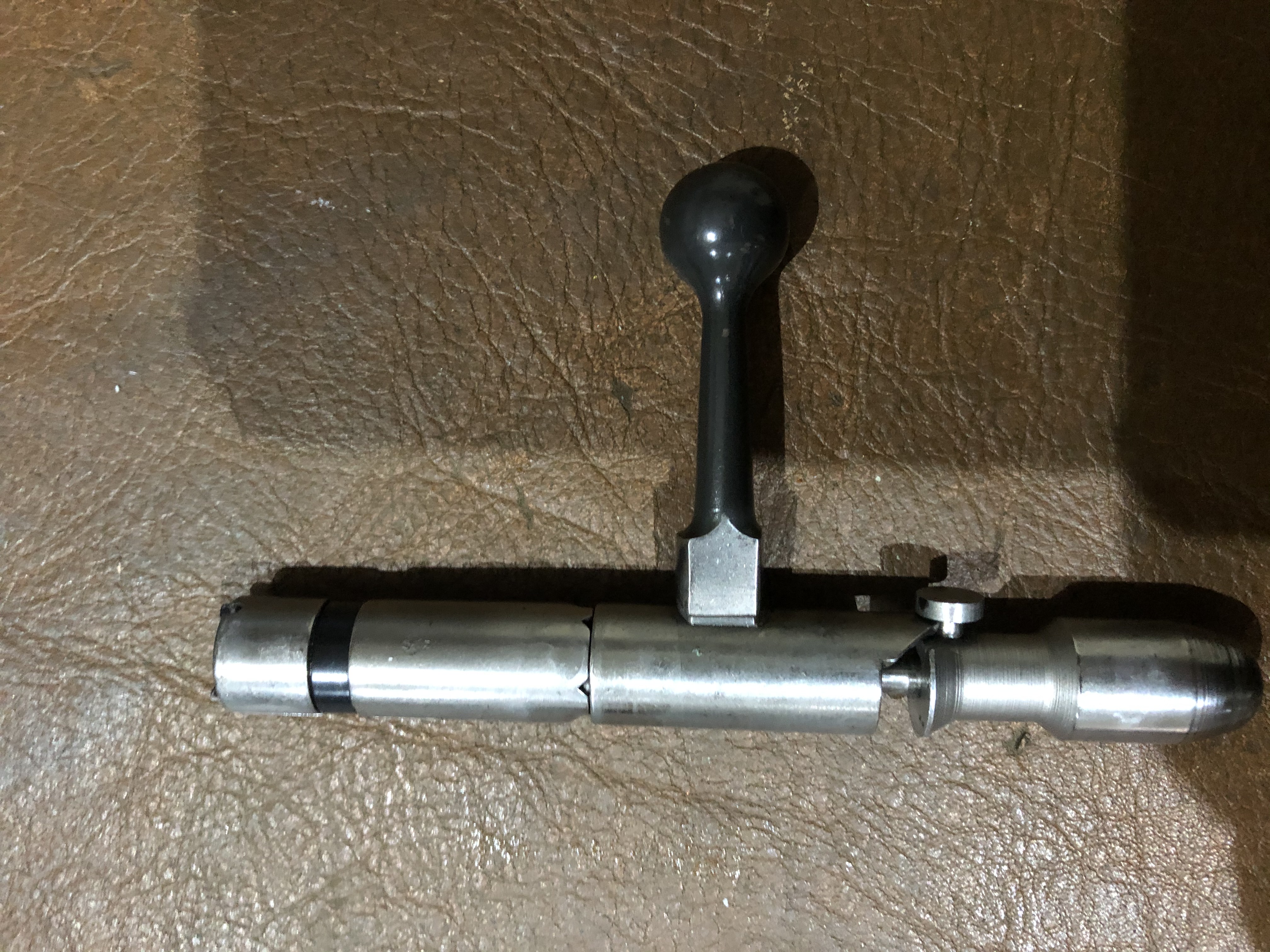

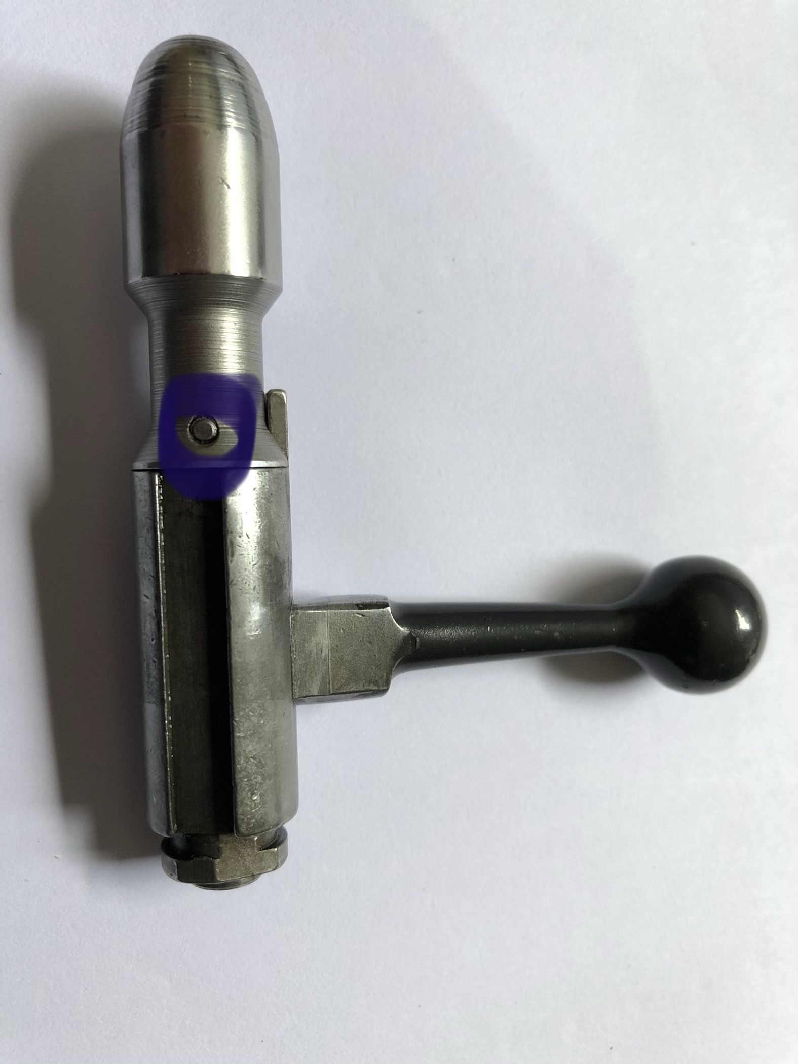

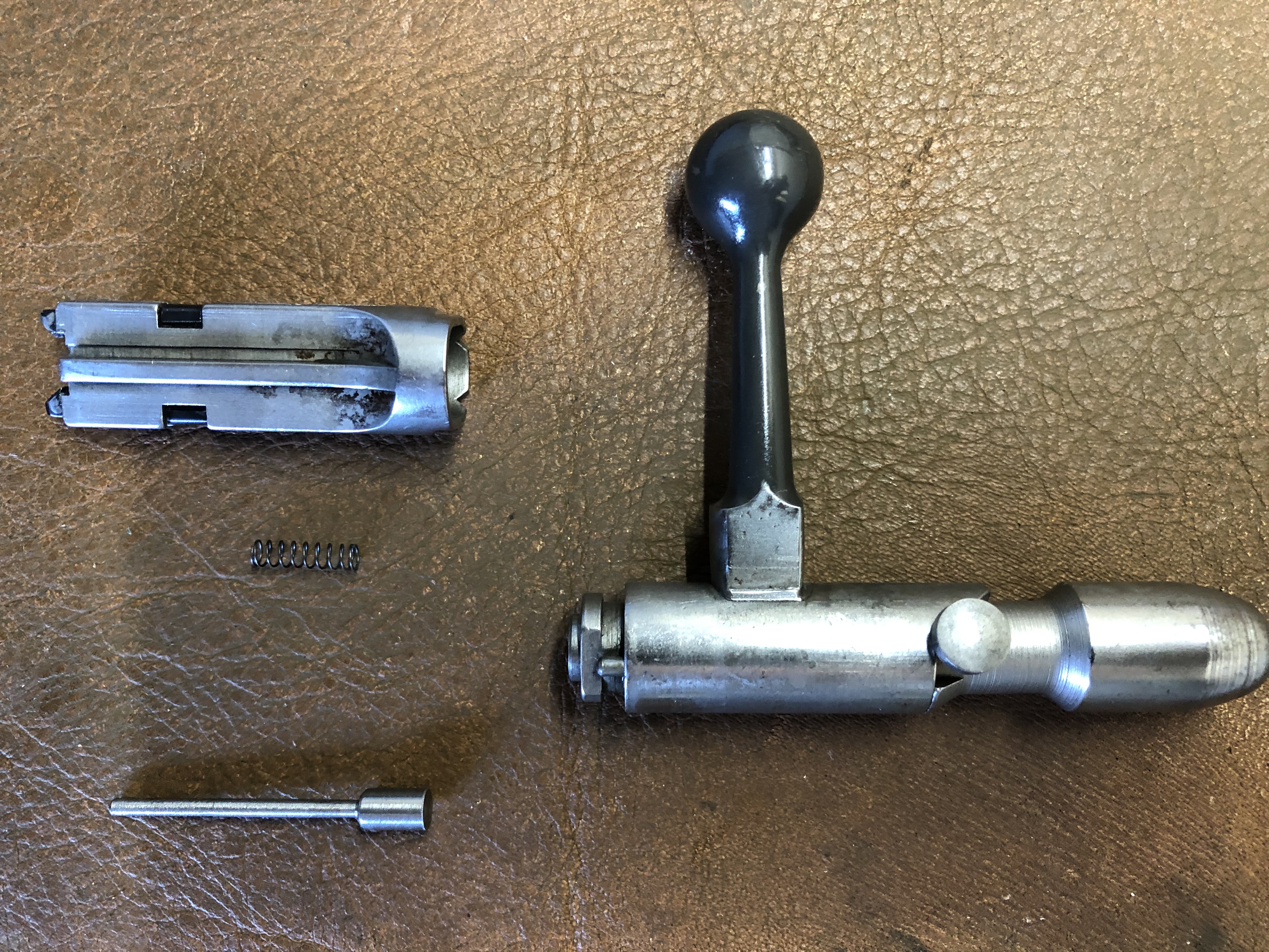

Post by martin » 12 May 2020, 7:05 pm
I have soaked and sprayed with carb cleaner.
Thanks with the step by step dismantling process... but i am not winning..
See pics attached
Do i need to remove the "pin" market with purple ?

Post by marksman » 12 May 2020, 7:50 pm
it looks to me that the rear of the bolt looks like it is doing what it is supposed to but what is it like uncocked fully assembled
does the firing pin protrude and does the rear seat down uncocked the same

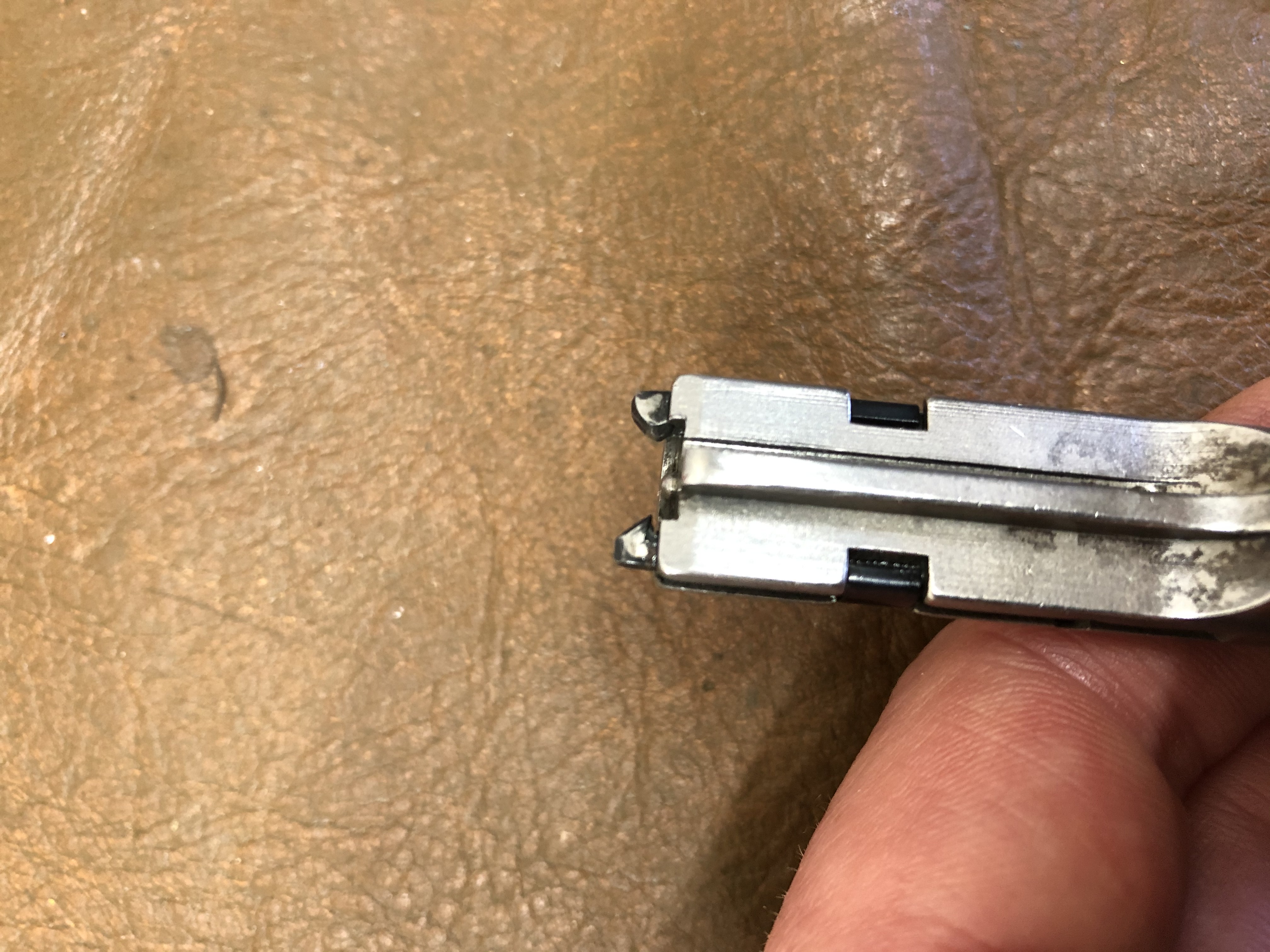

Post by martin » 12 May 2020, 10:50 pm

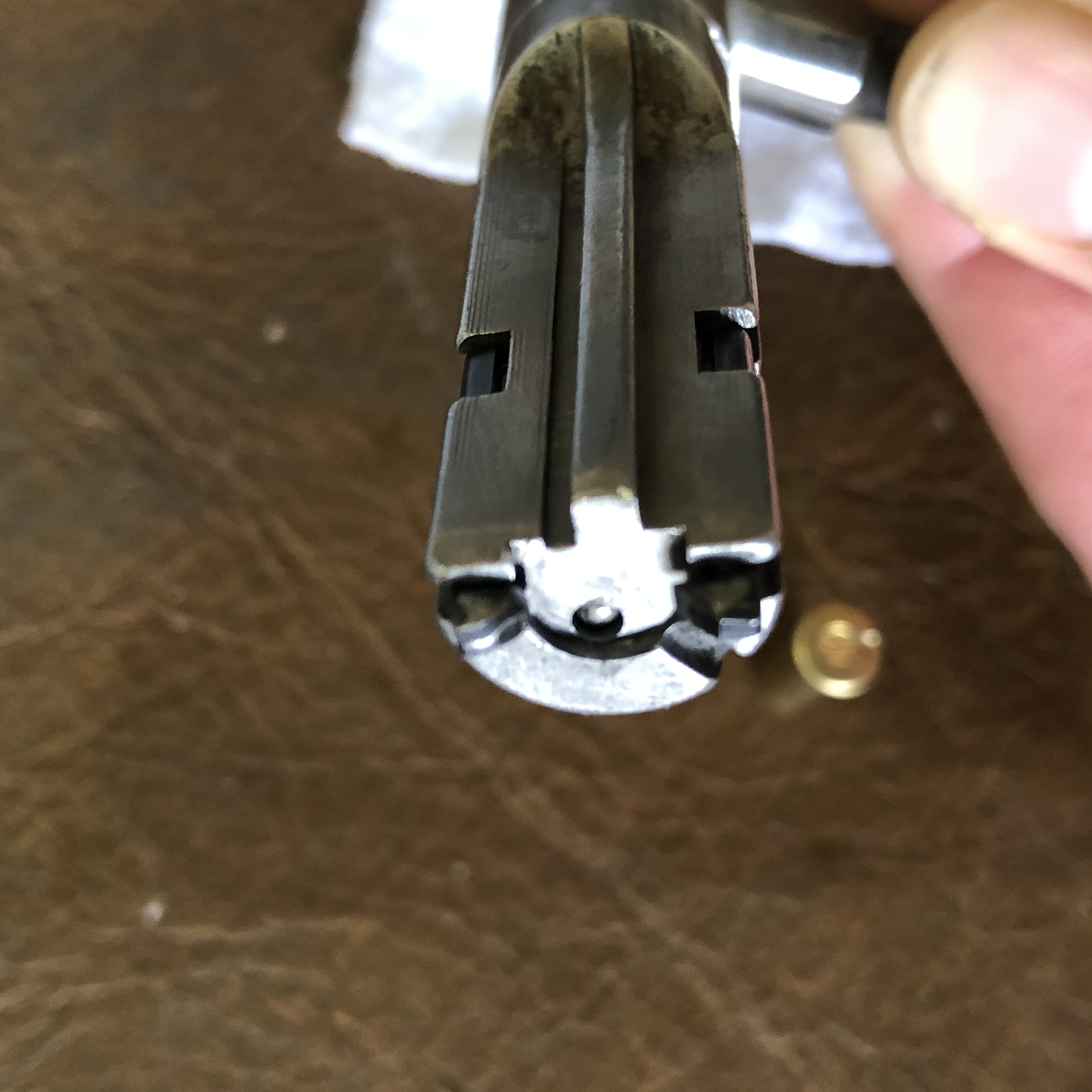

the firing pin does protrude .. i don't know what is "enough" or how to adjust it
Look at the second pic, looks like the one extractor claw is chipped or rounded at the end compared to the other.... is this correct ?
however the round does sit firmly on the bolt face ... but maybe that is the problem .... if the round "moves forward" when firing ??

Post by marksman » 13 May 2020, 10:20 am
the difference in the ejectors is so it extracts and can flick the case away, its normal
the firing pin does look like its protruding enough although l'm not exactly sure how far it should protrude
the protrusion is usually around .055"-.035"
going by the little bit of carbon seen on the bolt head l would say it was because of some crud inside the bolt head that may have been dislodged
when cleaning the inside a spray is not enough you need to clean it with carby cleaner and a small brush ect...

The carbon marks on the bolt face seem to suggest that it's not properly aligned with the cartridge case which would explain the firing pin catching the outside edge of the case rather than inside the rim.
Do you have something like a tiny bead of blu-tak that you could put on the bolt face and then close it against a chambered cartridge and then open it again to see how the alignment looks.
Maybe you have a problem with wear or damage on the bolt or action, the firing pin certainly looks to be protruding enough.
It could also be a head space issue if the bolt isn't closing close enough to the back of the cartridge.
