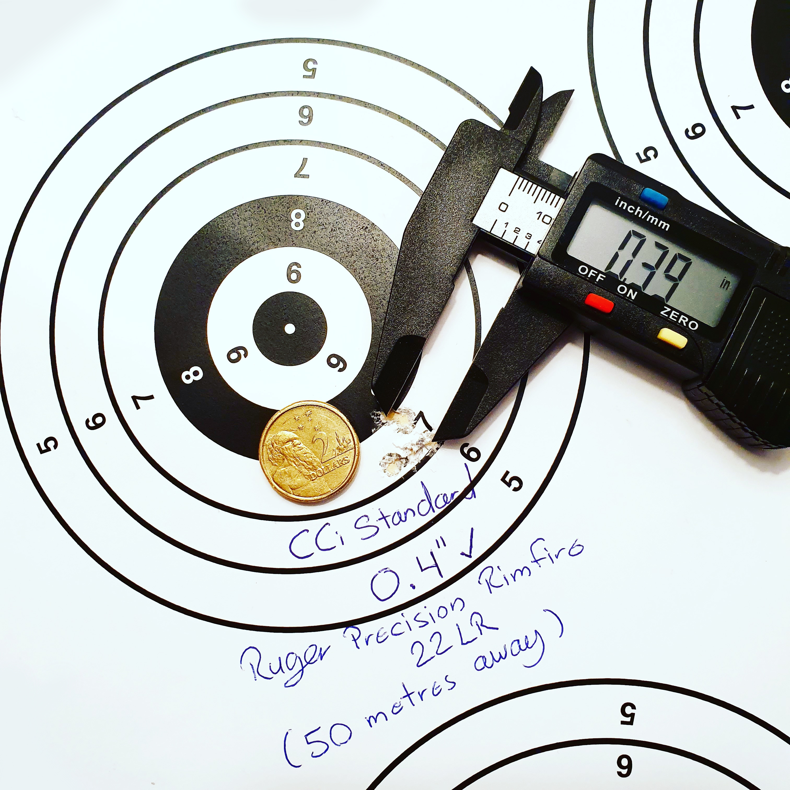

Here are my final thoughts on the “Ruger Precision Rimfire Rifle” in 22LR
After months of mucking around with it, testing multiple different types of ammunition etc
I took the Ruger down to the range for the 1st time in a while a couple days ago using CCI standard velocity
And it’s fair to say that I am satisfied with the results
I shot 19x groups from 50metres away (just shooting off the bench)
And here are the results that I got;
0.4”
0.5”
0.6”
0.7”
0.7”
0.7”
0.7”
0.7”
0.7”
0.7”
0.7”
0.8”
0.9”
1.0”
1.0”
1.1”
1.2”
1.2”
1.3”
My best group was 0.4”
I am happy with that
I shot another group which was 0.3”, however I had a flyer which extended the group out to 0.6”, but if it wasn’t for that flyer, 0.3” definitely would’ve been my best group, with 0.4” being 2nd best
Long story short; if anyone is thinking about potentially purchasing the Ruger Precision Rimfire rifle down the track, I do recommend it
Please note;
- I haven't changed the barrel or anything like that, I kept the rifle completely as is
- I only used a front rest in these tests, I did not use a rear rest

And no, those results that I put up, I just sorted them out from "smallest groups" to "biggest groups"
The results that I got were quite random and spread all over the place
I’m not sure if rifles are supposed to shoot better with a hot or cold barrel
I haven't looked into that
But I personally haven’t noticed any difference that I'm aware of
But then again
The Ruger Precision Rimfire does have a heavy barrel
So it may not make that much of a difference in the Ruger Precision but it probably could make a difference in the thinner barrelled rifles

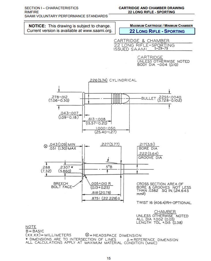

Target rifles very likely have match chambers, most .22LR rifles have sporting chamber spec.
Blade racer - can you expand on that for this dummy please. How do they differ?

https://saami.org/wp-content/uploads/20 ... -06-13.pdf
See pages 14 and 15.
22LR Sporting Chamber Dimensions.JPG (86.91 KiB) Viewed 13265 times
22LR Match Chamber Dimensions.JPG (85.34 KiB) Viewed 13265 times
A Sporting chamber is .2307" diameter at the face tapering to .227", Match is .227" at the face tapering to .2248".
A Sporting chamber is a .818" long taper, Match is a .643" taper.
A Sporting chamber has the lead at .8751", Match is at .6876".
Match chambers jam the bullet into the lead, which is why they generally shouldn't use CCI Stinger length cases.

bladeracer, thanks, I've been looking for those technical specs since I first saw the warning on a box of CCI Stingers that they shouldn't be used in match chambers.
OK thanks.
