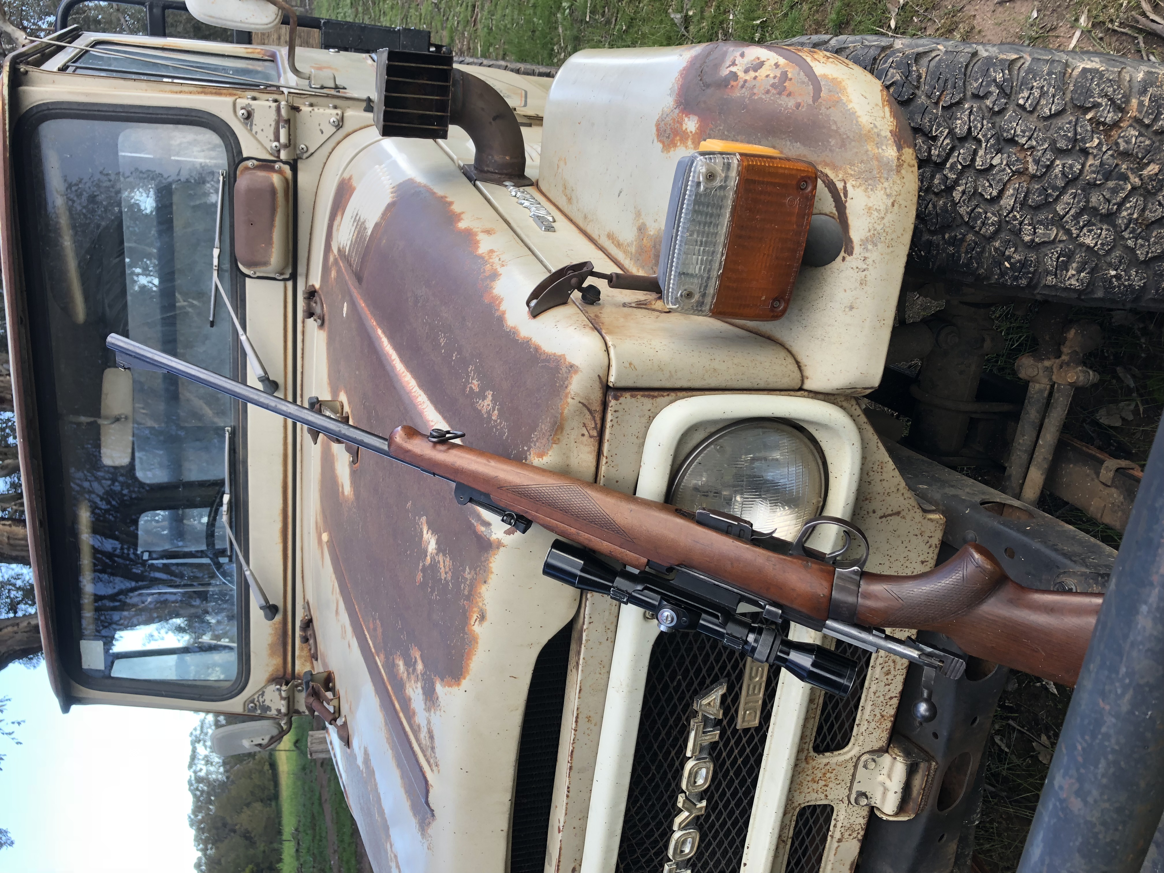

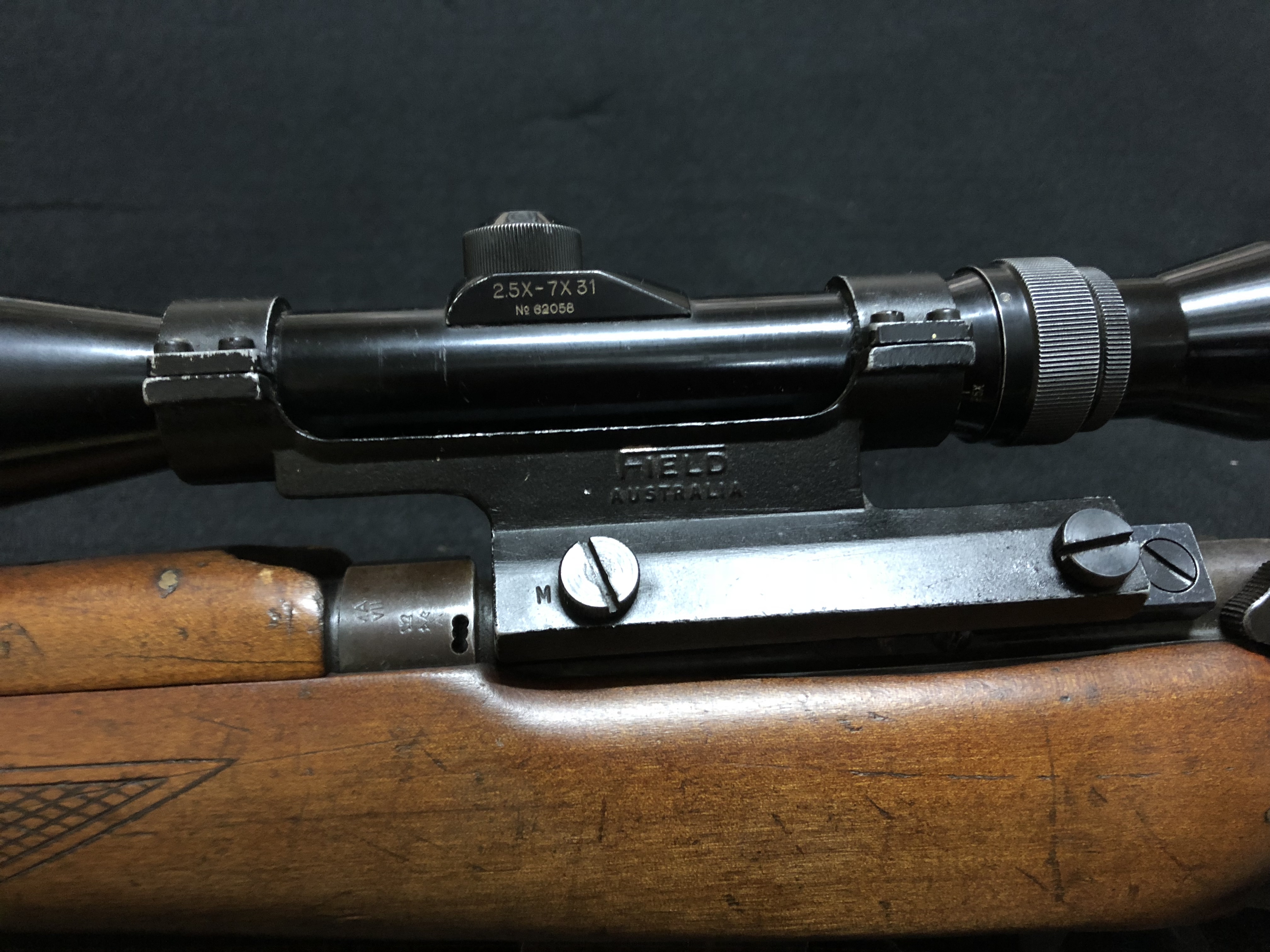

Post by Diamond Jim » 03 Aug 2020, 9:55 pm
Chappo wrote:I have a model 24 and 2 of the .410 shotties. All good rifles and a great bit of australiana.
What is the scope mount on the model 24? My dad has had one for nearly 60 years but ours has iron sights. It has always been a very accurate rifle but I've always though it would benefit from a scope.
That’s an Australian made “ field” mount.

Post by Chappo » 11 Aug 2020, 5:45 pm
Vicko wrote:How does the M24 shoot Chappo?
I wouldn't mind adding one to the collection one day...
Vicko. My 24 isn’t that flash to be honest. I can’t get a 5 shot group under 2.5 inches at 100 yds with it. But that’s not really surprising considering it’s had a lot of high velocity rounds put through a rifle that was built in the late 40’s early 50’s from a modified ww2 303!
It’s good enough for foxes though every once in a while when I’m feeling nostalgic.

Post by Chappo » 11 Aug 2020, 5:53 pm
Diamond Jim wrote:What is the scope mount on the model 24? My dad has had one for nearly 60 years but ours has iron sights. It has always been a very accurate rifle but I've always though it would benefit from a scope.
Yes mate, deanp100 is correct, it is a field side mount. Drilled and tapped. Very common back in the day for ex war 303’s and their derivatives.
