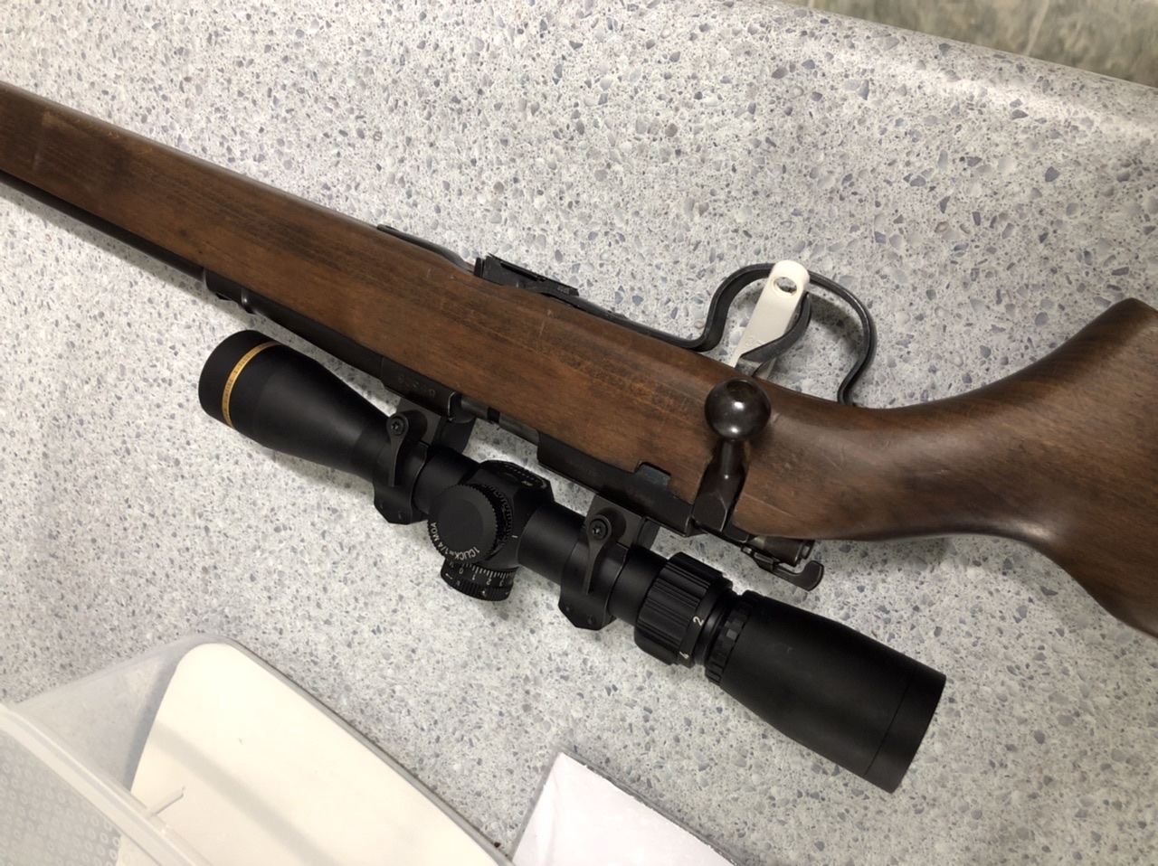

Pic of rifle.
Don’t know what the stock is from.
Maybe Chinese s/s
Or slug gun.
Yep
Rough enough.
Side

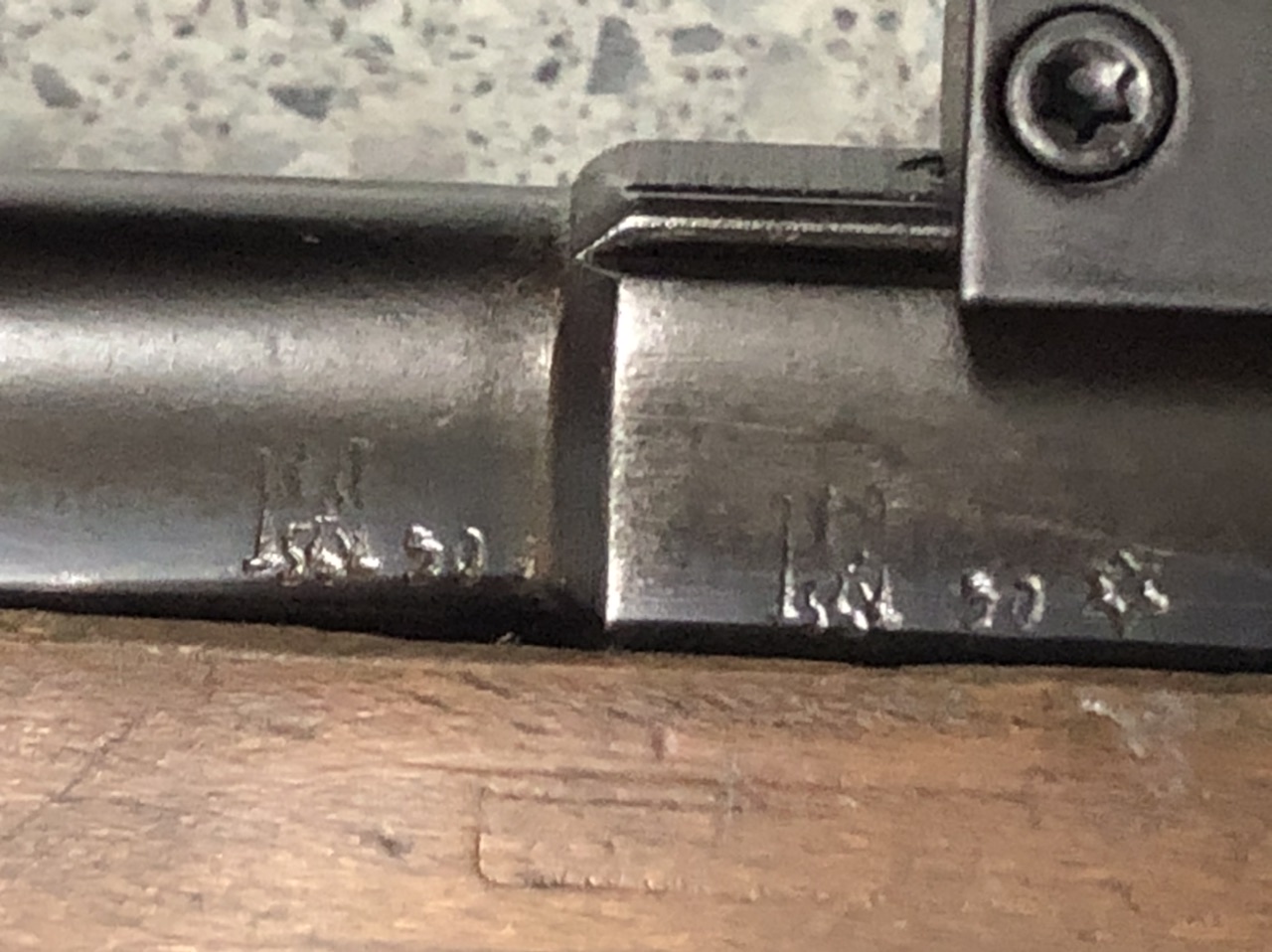

I don’t know what these marks are.
50 star year proof but the other one on the left?
Is it supposed to be crossed swords or some such?
Any way it is what it is.
Stamps
Thanks for looking.

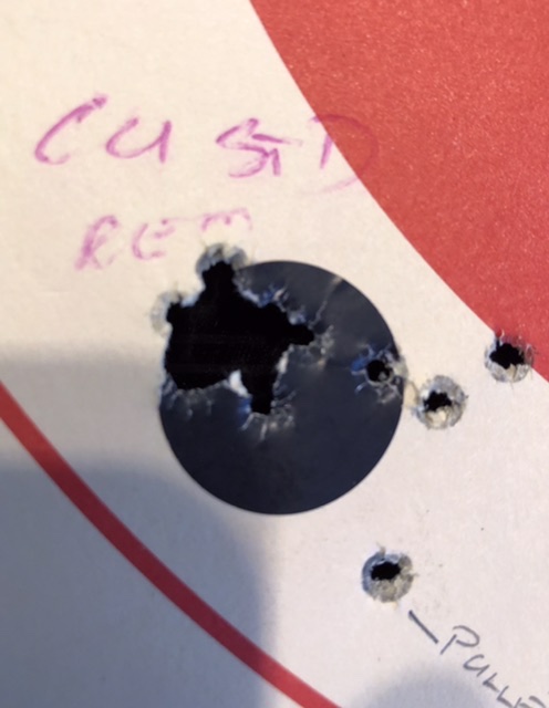

Took out my old trusty Remington and shot a group with cci std from a clean cold bore.
Wow nothing wrong with the ammo then.
Remccistd
Remington
Proceeded to shoot holding on forearm with the Brno as I normally do and shot some groups again.
Brno 1 cci std
Brno1
You would think the Remington shot better but the magic 5cent piece tells otherwise.

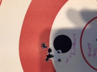

Federal champion
Eley sport
BruceW

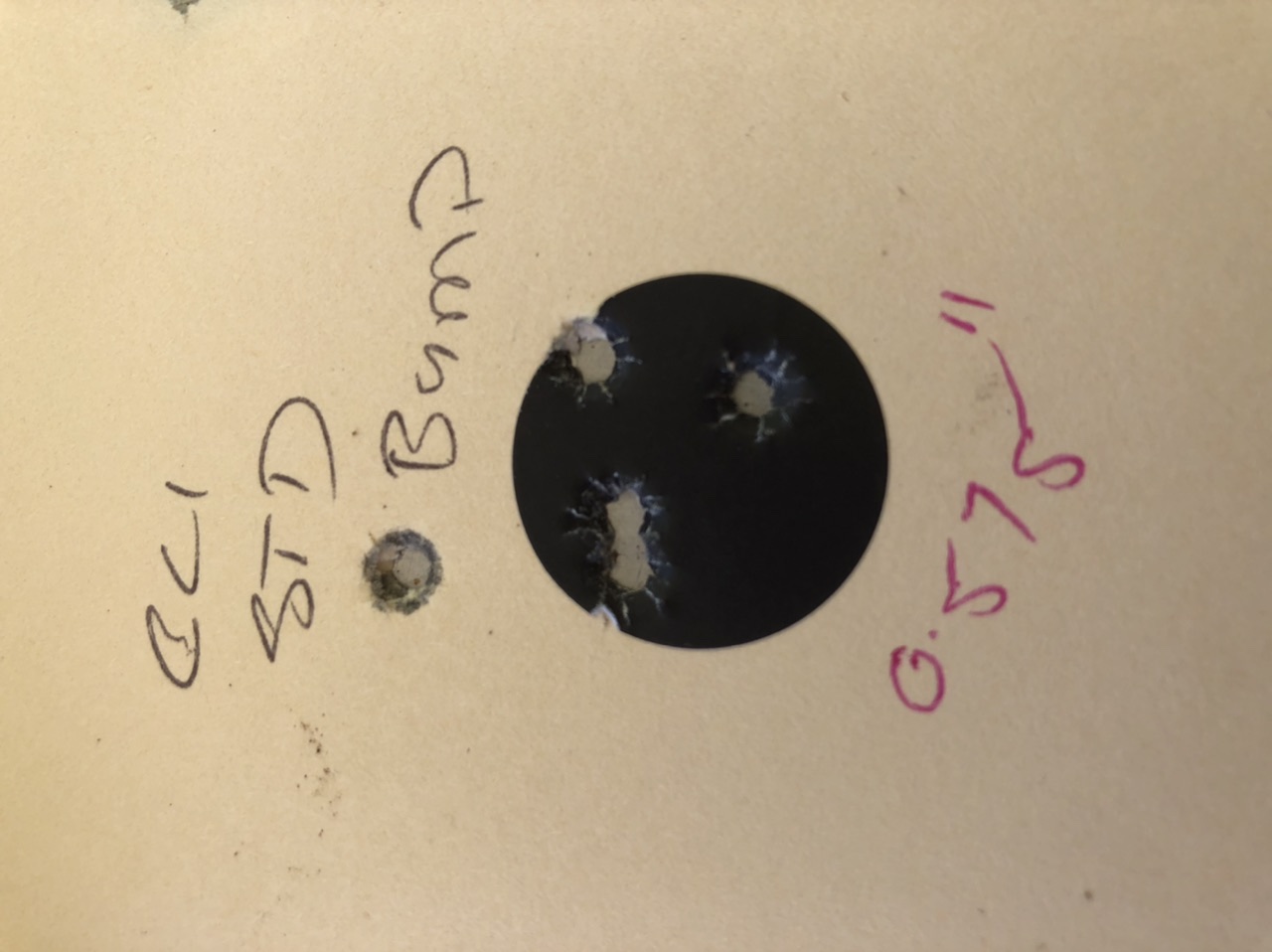

Cci std
Std
A bit more consistent.

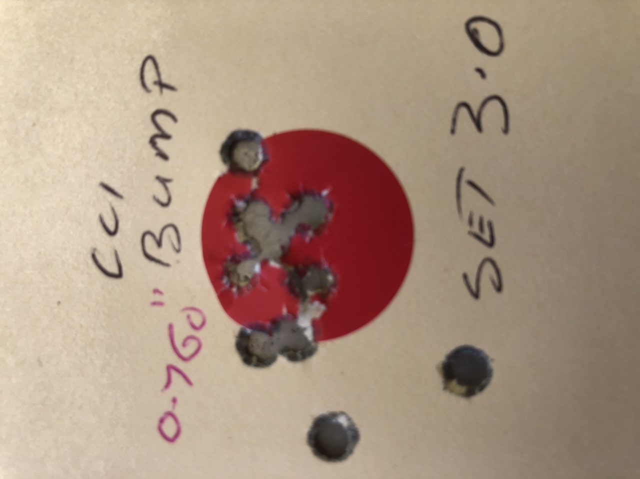

I used a home made paco style bump die. 0.225" which helped a bit more.
Bumped5
Ingnoring the flyer. Probably me.
Put a small tuner on and a quick dail in.
Tuner
Cci 5 shots 50 yards
Ccibumptune5
10 shots cci 50 yards
Ccibumptune10
May have to refine the bump die some.

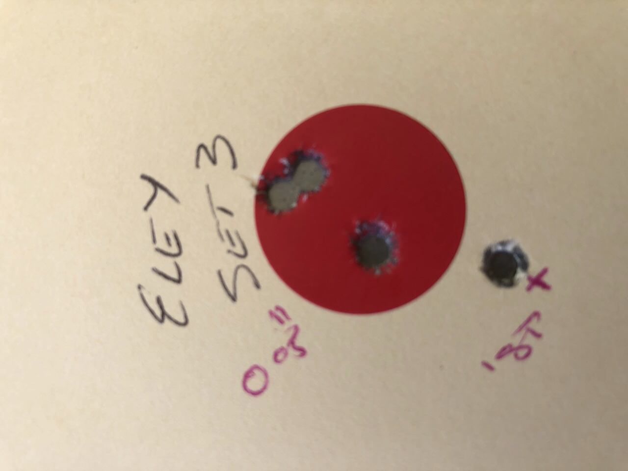

Eley Edge only fired 10shots at 50 yards straight after shooting different ammo so it might even be better
Before tuner
Eley
with tuner
Eleytuner
Better than it was.
