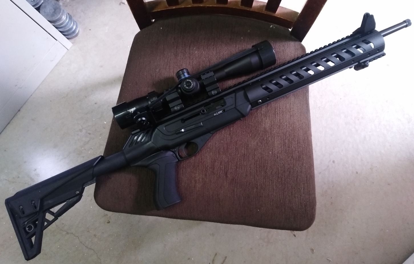

Set up with a bit of extra rail on the bottom of the forend, a Bushnell Rimfire 6-18x40 and some cheap offset iron sights
Cz 515 S.JPG (142.74 KiB) Viewed 20794 times
The CZ 515 Tactical.

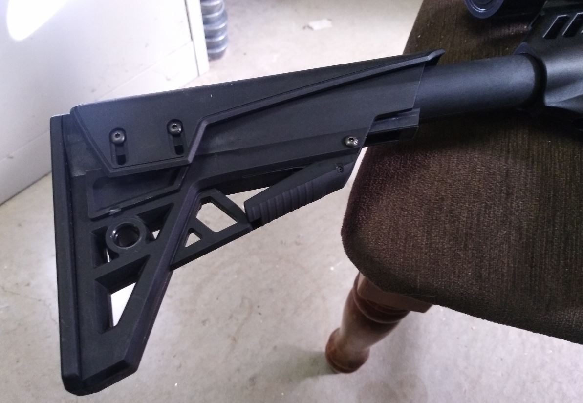

•The buffer tube- I’ll make special mention here that the buffer tube is not interchangeable and is also plastic. While I believe you can swap out buttstocks (for a Magpul or such) but I’m not sure how the fit would be. I’ve resigned to use the one it come with... which is not awful… but it’s not wow either.
•The upper pic rail- Not a problem I have personally had, but others have noted that the fit between the upper pic rail and the receiver is loose. Hard to explain here, but the rail screws to the forend and the rear butt stock adaptor. There is no screw that actually holds the rail (that your optics will sit on) to the receiver. For accuracy, this is not a great design as there can be some wiggle. There are some fixes, but they either look scrappy (zip-tie) or they will definitely void your warrantee (drill and tap the receiver) This, however, is not a problem you will get with the American version.
Note the plastic buffer tube.

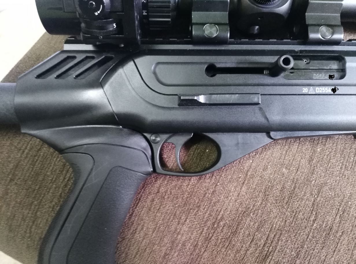

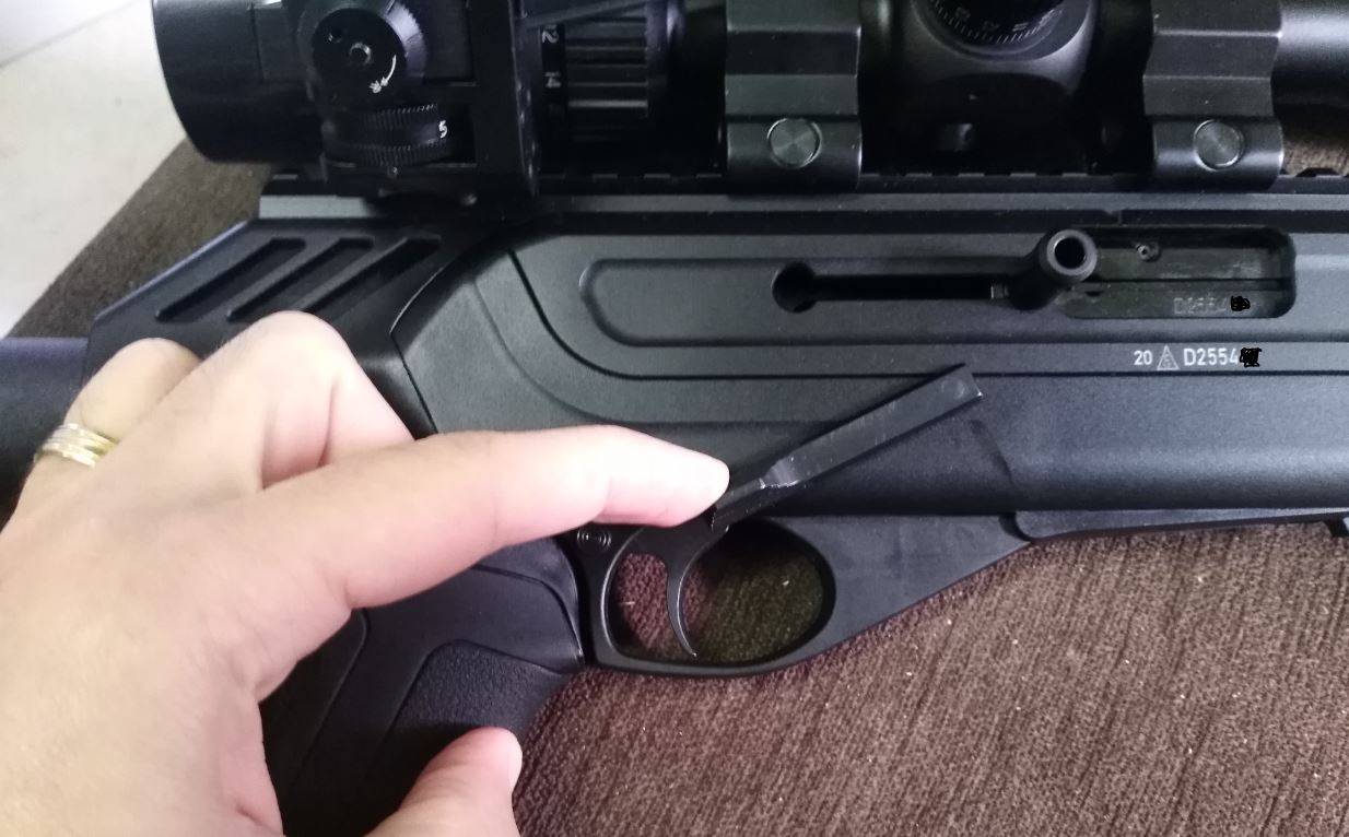

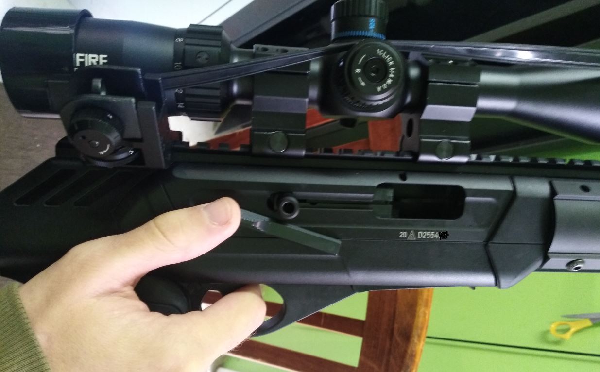

Another note I’d like to make is the location of the lever release on the CZ. This is a straight up improvement over the Savage. The A22r has its lever release located in front of the trigger guard. It’s a bit of a chunky thing, and very heavy to pull… although it has a short travel. The CZ lever is located on the right side of the receiver. It is more of an actual lever compared to the trigger like lever on the A22r, and it takes much less force to operate. It is a longer push down than the short and crisp pull on the A22r, so take that as you will. It might be more of a preference thing.
Bolt closed S.JPG (189.66 KiB) Viewed 20794 times
Bolt locked back S.JPG (105.02 KiB) Viewed 20794 times
Lever throw to close bolt S.JPG (120.93 KiB) Viewed 20794 times

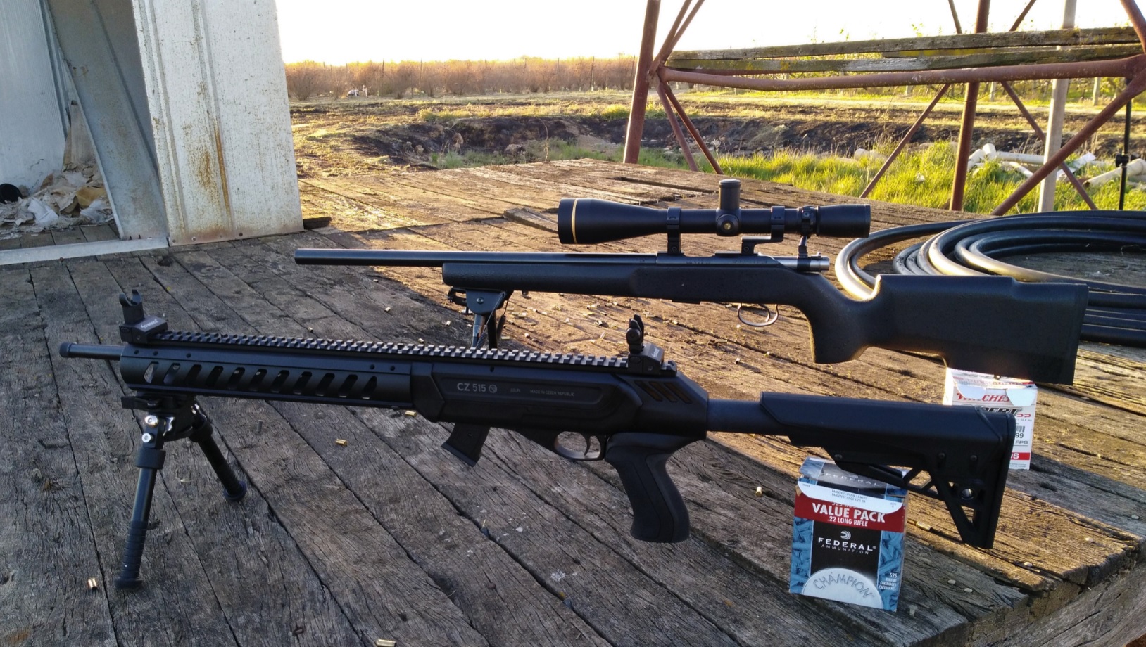

Overall, I do like the CZ 515 more than the Savage, but it is mostly down on look and feel. Functionally they are both pretty good, but options that the 515 has from the factory just win it for me. With the A22r, you can buy an aftermarket Boyds stock, or and MDT tactical type stock for your AR grip and buttstock, but you can get either look factory from CZ. Honestly, I’m hoping Boyds come out with something for the 515, I think that would be a nice aftermarket option should it ever happen.
Next to my CZ 455 Target set up, they are a neat pair!
small cz 515 2.jpg (604.52 KiB) Viewed 20794 times
