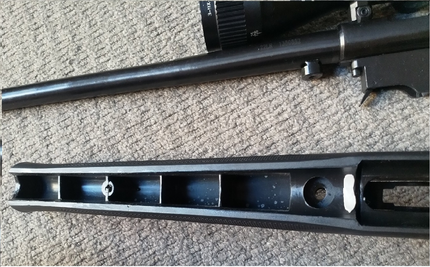

At the risk of starting another norinco thread.......I just bought a second hand JW15 as a cheap knock around rabbit gun. Has the plastic stock
Anyway, I've read differing opinions on whether to float the barrel on these, something went a contact point of the barrel. As it's a real struggle to get to a range or somewhere to shoot regularly (I hunt nsw state forests, can't target shoot or sight in there) I was hoping to get things sorted before getting it sighted in, rather than trying and treating a heap of things.
Barrel contacts on the very end of the fore end, plus each of those formers in the stock seems to contact the barrel also. Along each side the stock seems to contact barrel the full length.
There is the little lug at the front of the action/rear of the barrel that seems to bottom out in the hole in the stock. I could just pack that up with washers, leaving contact points at this lug and rear of action.
I guess while I'm at the range I could just pop the action out and put washers under the lug so barrel clears stock and compare.
Anyway, what are the thought of what to do with it-grind out the stock, compare at the range, just use washers, or don't bother as it's fine as is and just go shoot?
Appreciate any advice you guys can offer
Stu
Edit: trying to add photos but it just won't let me. Will get them up at some point

Some like to be floated, some like pressure at the tip of the forend.
Try both.
Yes you can , just use washers, or put a business card under the barrel near the action to tedt free floating.
Don't grind/sand out the forend till your sure.
And try at least 10 brands of ammo

Thanks Oldbloke. Managed to get one image up now on original post..
I'll get a washer or 2 sorted and check barrel is clear with it
I think I've got about 7 there to try. Would be nice to line up with someone else trying to pick ammo for new rifle instead of buying 50-100 of each type to use maybe 10.

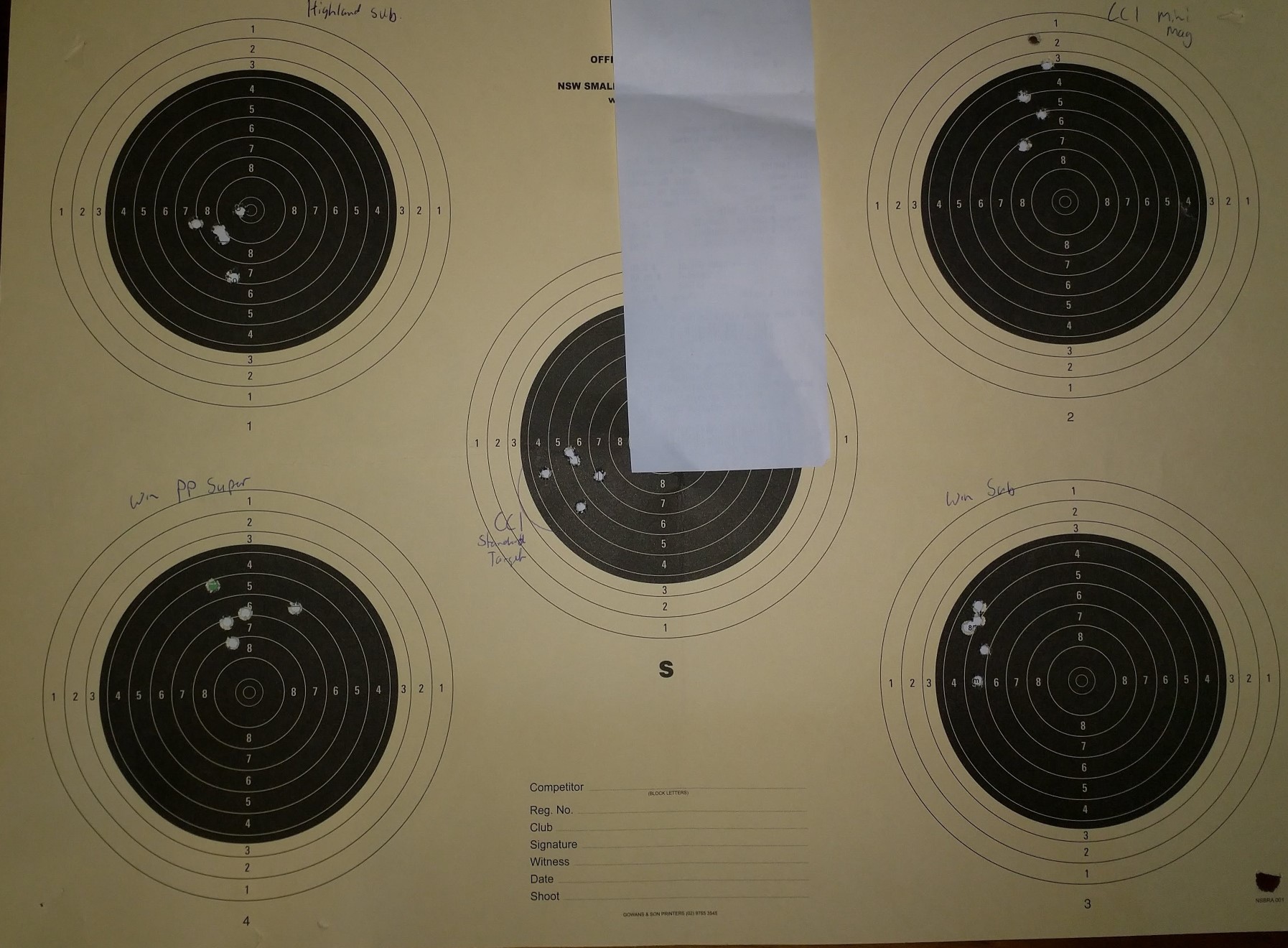

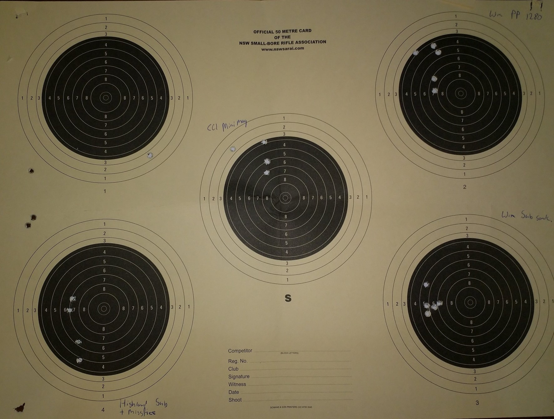

So I finally got out to shoot this yesterday.
Tried range of ammo after getting it onto target at 50yds. Just shot for groups as I figure I'll get it sighted in properly when I decide on what ammo to stick with
Middle CCI mini mag (used to get on target also), top right Win Powerpoint HV, bottom right Win subsonic 40gn, bottom left highland subsonic HP
Second target (ignore the ones covered, just shot Browning trombone at the target while waiting to change targets. Middle CCI target Standard velocity, top right CCI Mini mag, bottom right winchester subsonic 40gn, bottom left Winchester Powerpoint HV, top left highland subsonic HP
You can notice a lot off vertical spread in these groups, which could be me or the the rifle possibly has some effect..
I did try putting washer under the front lug to float barrel. Problem was it was on the last targets and I only had a target out at 100 so just shot at that. Shot 3 groups, one without floated barrel and 2 with floated barrel. Only found 2 groups on the target, which I suspect was unfloated and one floated based on position. Unfloated group around 3" and floated group 4-5" with more vertical spread. Shot with the winchester subsonic which i thought gave the most consistent results at 50m
I did have a few instances of going to fire and the trigger just bottomed out with nothing happening. Thought I forgot to cock it, but it wasn't my stupidity. In each of these instances the round stayed in the chamber on opening the bolt, and reclosing the bolt and opening wouldn't get it to extract. Had to pry the rounds out with screwdriver each time. Putting the round back into the mag at one point the round still fired and ejected fine, so it seems the rifle was the issue. It happened with 2 brands, Highland and I think the CCI target standard velocity, 3 times in total I think. The fact it wouldn't trigger makes me wonder if the ejector claws weren't fully around the rim, but wasn't sure if the ejector claws can impact on cocking or triggering of the firing pin.
Keen to hear any thoughts you guys (non gender specific term) would be willing to give.

disco stu wrote:You can notice a lot off vertical spread in these groups, which could be me or the the rifle possibly has some effect..
I very much doubt that it is you. A tightly stressed forend->barrel will cause that. Regardless of spread, your groups should have uniform dispersal on both axis.

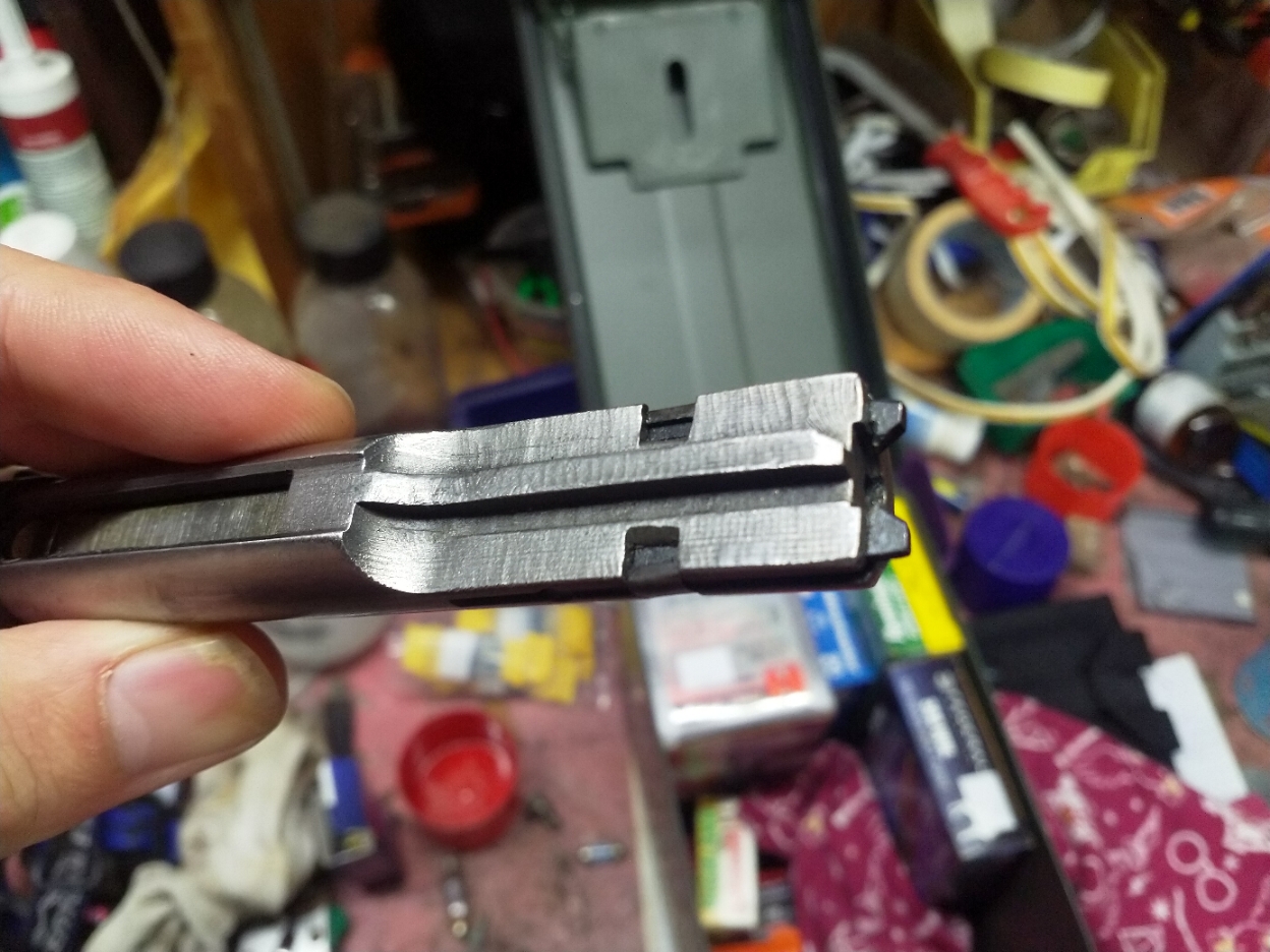

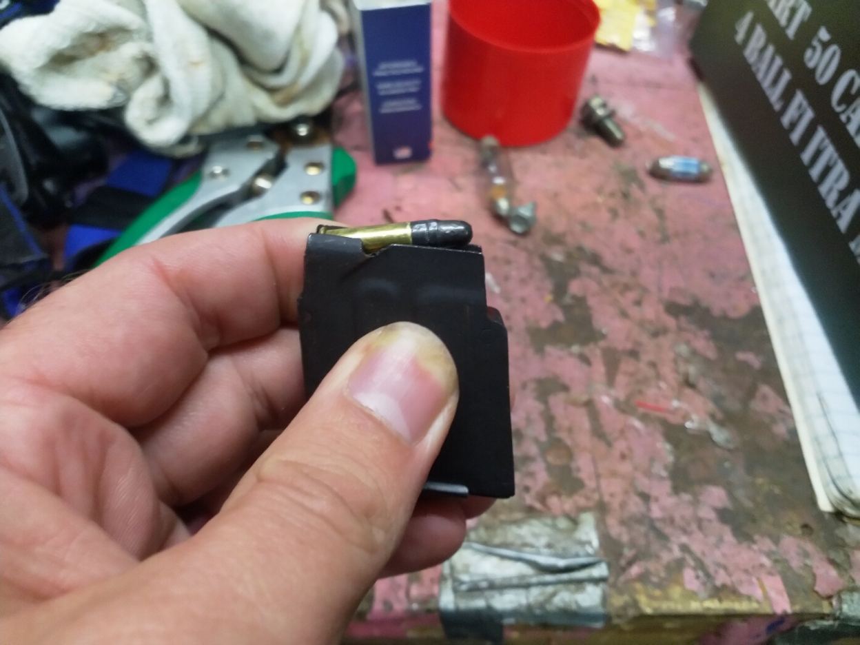

Post by disco stu » 20 Apr 2021, 6:51 pm

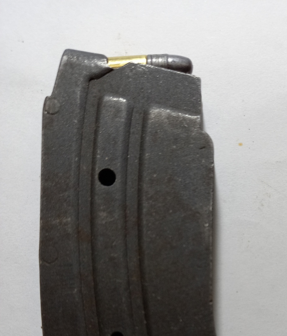

So had a little look this afternoon. The rounds are sitting very nose up. I'm thinking the spring might be a little strong. But some adjustment to the lips that hold the rounds in might help with the angle they sit on.
Also, the rough as guts bottom of the bolt rides over the top of the round underneath when cycling and scrapes a little off the top of it. I'm wondering if its worth getting to work and smoothing that out. The very end that picks up the round is slightly angled, so it appears that I can take a bit off without affecting operation. The angle that the round enters the chamber is also taking a little off the front on some of the ammunition, but not all of it.
Looking at the operation of the bolt, it appears that proper operation would be that as the round slides out of the "lips" in magazine it snaps up into the bolt and claws, this should then hold it in the right position to enter the chamber relatively straight. Does that sound correct? It would seem that the function of the magazine as it is is leading to angle of the round, which makes me wonder if getting a CZ 452 magazine might be a better option

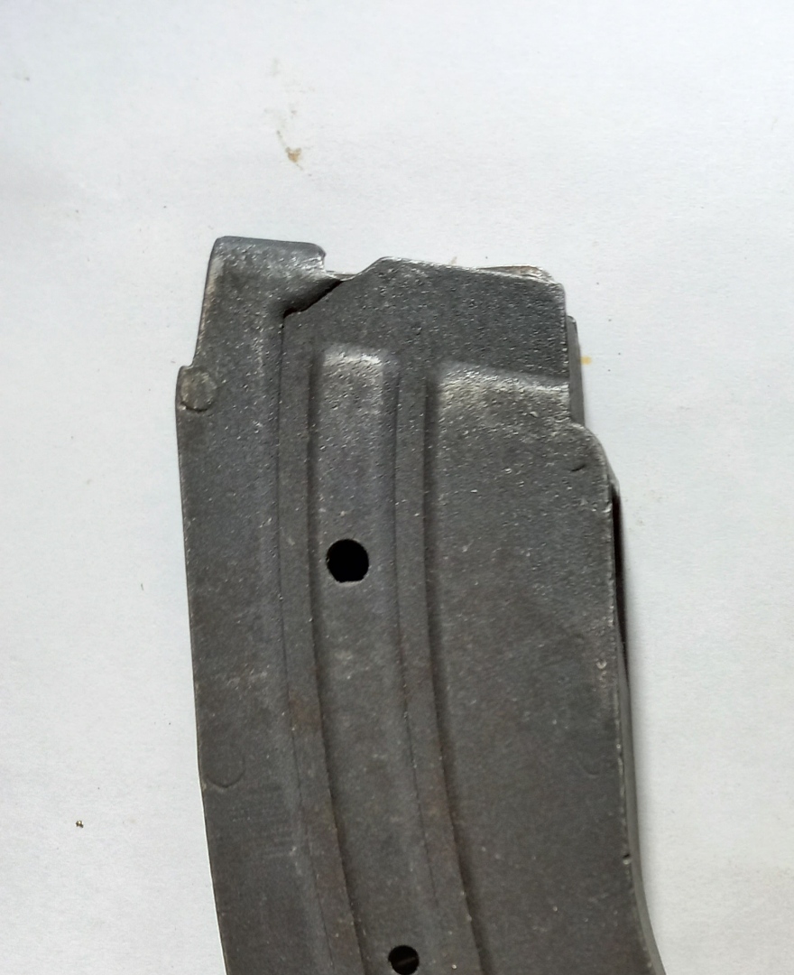

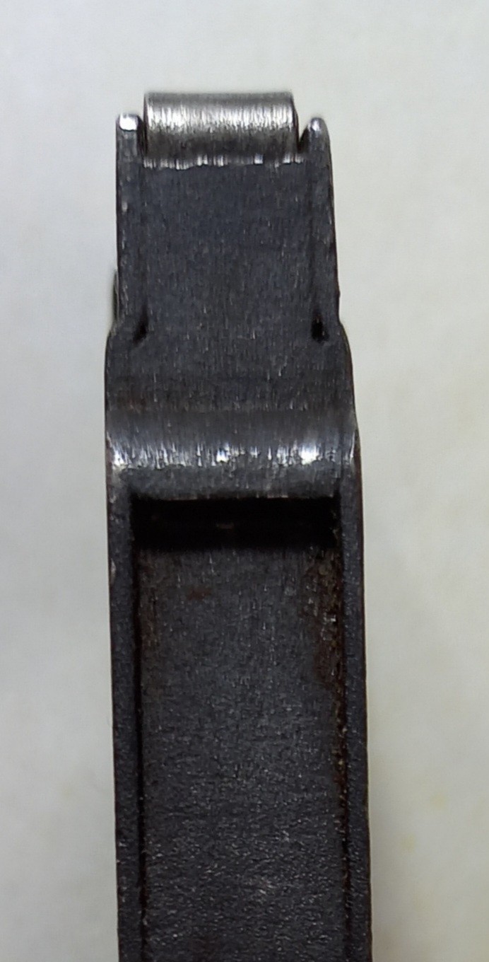

Post by Oldbloke » 20 Apr 2021, 7:39 pm
A brno m2 mag. Loaded and empty.
Loos like your follower protrudes more.

Thanks old bloke, that's helpful. I actually just pulled the mag apart to have a look at the follower, found the long front part that sticks down angled in quite a lot, allowing the front to rise up. I've adjusted it, now just need to see if it chambers properly.

Re: Norinco JW15-float barrel?
Post by disco stu » 20 Apr 2021, 9:24 pm
No good with the adjustments I've made. Without that much angle it now pushes the tip into the front under the chamber before it moves up into the chamber.
To my thinking, the front of the lips on the magazine holding the rounds in shouldn't be as long. Being shorter would allow the back of the case/rim to exit the magazine and rise up before the tip of the projectile was jammed hard into the bottom of the chamber (whatever that would be called). Does that thinking sound correct?

Post by Oldbloke » 20 Apr 2021, 10:10 pm
Not sure. If I get time I will take more pics of the mag
Post by disco stu » 20 Apr 2021, 10:38 pm
Thanks. It looks a little like the front corners of the tabs on your mag are rounded. Not sure if that makes the difference.
I guess I'm just thinking that the distance from where the rear of the case leaves the magazine to the chamber should be longer than the length of the cartridge, or at the very least longer than what it is on this, because anytime the round starts to enter the chamber at the angle it is it's shaving off or distorting some of the bullet.
If I had 2 magazines for it I would get creative with a file, but I'm reluctant seeing it's not the sort of thing that can be easily undone

Post by Oldbloke » 21 Apr 2021, 12:10 pm
Once you remove material you can't replace it. I would compare with one that is proven to work ok in your rifle before filing anything.
Post by Oldbloke » 21 Apr 2021, 12:21 pm
Um, I think I have the problem. The small step in the follower determines how far the front of the follower protrudes.
Check yours is the same. Dont know how you fix that?

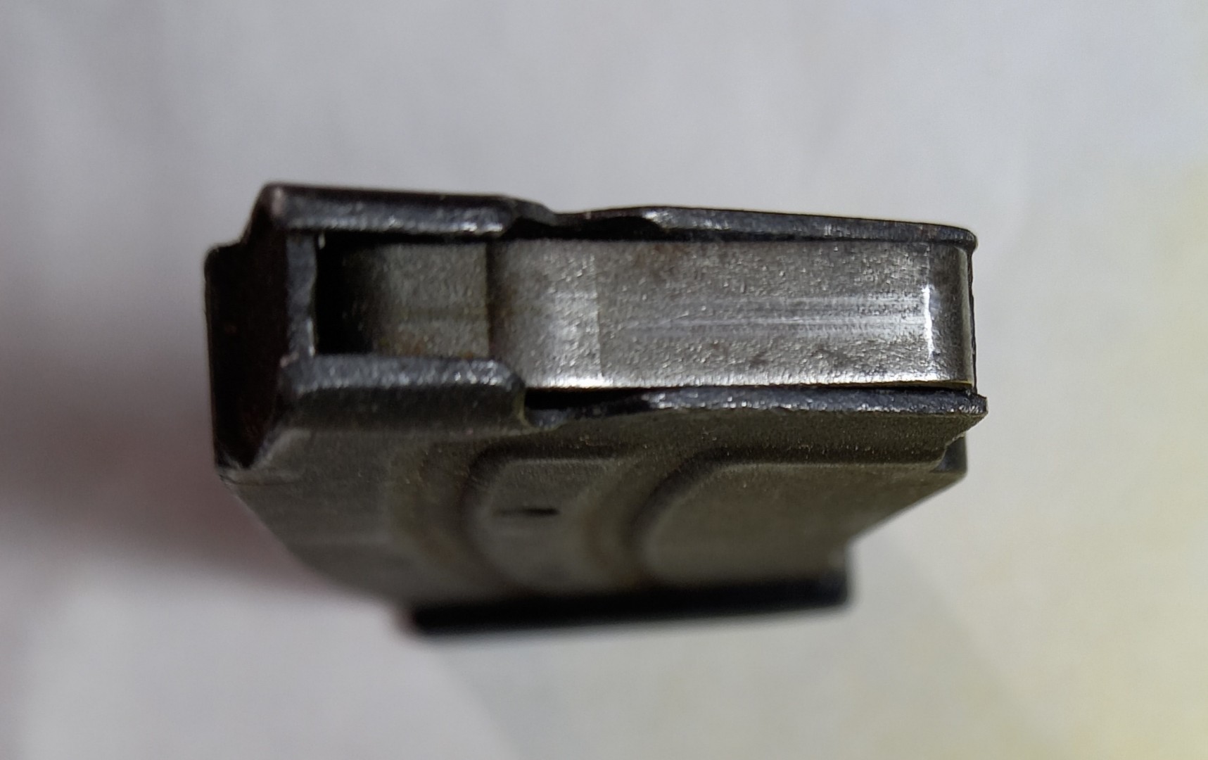

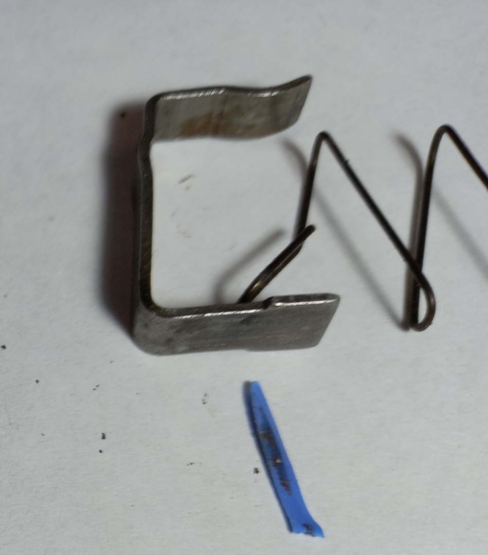

Post by disco stu » 21 Apr 2021, 7:43 pm
Thanks for the photos old bloke, really helpful to compare. Appreciate you pulling your mag apart for my sake also.
This is a photo of mine. I just bent the longer part closer to a right angle and the bullet end wasn't sitting up as high. But like I mentioned, now it's not forcing the nose into the chamber, rather is sticking into the back/underneath the chamber before the rear end of the case pops out of the ear tabs in the mag.
I'll try bending out the very front of those tabs to see if it pops out a little earlier. That's easily reverseable at least. If that doesn't work I might try grabbing a CZ mag.

Post by disco stu » 21 Apr 2021, 9:40 pm
Got a winner!! I put a bit more angle on the follower, but less than it had previously, got it to match the photo of yours old bloke.
Is now angling them up nicely and not jamming the point up into the edge of the chamber. I thought it wouldn't be able to do that when I was looking at it all before, but there you go.
Now the angle is lower, the file like bottom of the bolt isn't grinding into the top of the bullet quite as much. I'm still tempted to smooth that right out, but it's less of an issue now.
Really appreciate your advice in2anity and old bloke, especially going to the trouble of taking a heap of photos and pulling your mag apart so I could compare. Greatly appreciated
