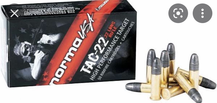

Does anyones 101 like Norma standards? Mine absolutely loves it! 1/2” groups at 50m!

The only Norma I've found is the Training 2, nothing else. I can't find a listing for Norma Standard anywhere and all of their ammo is "standard velocity".
Re: lithgow la101 22lr
Post by alucarD » 11 Jan 2022, 6:25 am
Yeah that’s what I meant sorry. Norma standard velocity 1100fps.

Nice, I haven't been able to find the Tac22 anywhere. I only found one place that had the Training2 stuff.
Bloody hard getting test ammo since they stopped mail-order in September.

Yeah k. Which state you in? I’m in Newcastle, NSW and they are in a few shops here.
