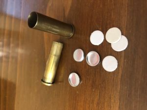

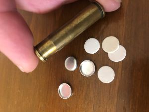

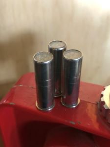

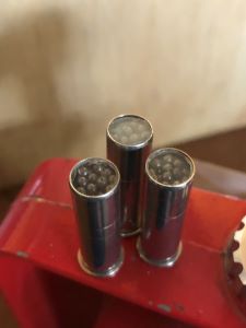

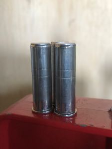

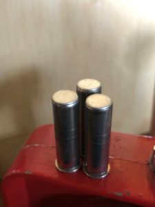

Post by Pendous » 27 Jun 2022, 11:17 am
Did a little experimenting a while back never finalized a load.
Don't believe I'll ever shoot to many but they are entertaining for all who have shot them.
The silver tops are aluminium gas checks, roll crimped in place.
Filled the case with shot, weighed max payload then backed the payload back until I could fit it with an appropriate powder charge.
These are 357mag cases with somewhere around 90gn? (without checking notes) depending on pellet size.
The clear plastic is cut from CD cover, roll crimped
Pendous
Posts: 38
Re: Anyone load shot charges in metallic cartridges?
Post by Pendous » 27 Jun 2022, 11:22 am
Cardboard over powder card hammered out of retail packaging using a outside sharpened case.
Card seated against powder with finger pressure into case web using a 32-20 case.
Pendous
Posts: 38
