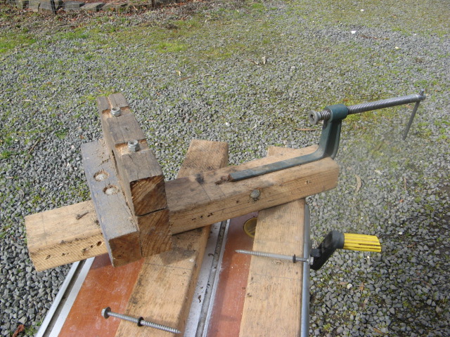

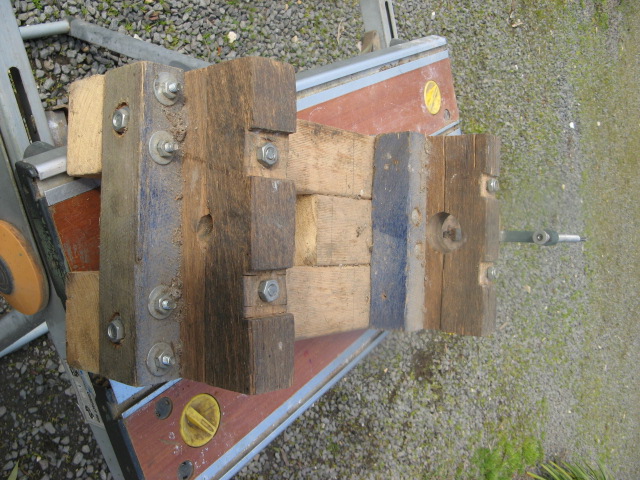

Here are pictures of my Mk. II spring compressor made from bits of scrap wood and - typical of anything I construct - somewhat overbuilt out of a healthy respect for compressed springs. [I still have all my fingers and can count to 10 and my teeth are intact too!]
I have a number of different air rifles of different power outputs and sizes, hence I made it adjustable. By that I mean that the central section can slide forward and back as required between the two outer arms. I simply anchored the centre shaft with long tech screws, one from each side - I did not have long enough through bolts which would have been stronger, though there is not a deal of lateral stress once the tech screws are screwed home. It's pretty tight.
As you will note the barrel is clamped at the front and then bolted down. The compression tube/body is set in the larger rear bracket and clamped also. I adjust the for/aft [middle] shaft distance to suit the likely length required for the G-clamp to be screwed in to seat the spring so the end cap/pin may be safely secured. Some testing is required for each rifle to get the initial position right so as to avoid running out of turns on the G-clamp. The G-clamp is a basic Bunnings job with the top cut off. It has to be big enough so as to provide enough depth in its shaft so it can be drilled to take a bolt which is counter-sunk in the sides of the wooden shaft. Only one bolt was required as the flange on this G-clamp lies on top of the shaft in the narrow slot cut for it. I will use a thin pad between the rifle end cap and the tip of the G-clamp screw and tighten the clamp very slowly paying great attention to keeping it exactly centred. Bunnings' G-clamps are not exactly precision instruments!
I cannot remember where I saw [and copied] this model for a compressor. I'm sure there are many variations around.

Wow! What a piece of work :D :clap:
This morning I looked at sliding bar clamps at Bunnings. Now I am going to look for Whopping Great G-Clamps on their website.
Thank you very much Jim. Some of your invention coincides with my ideas and some is not, which is food for thought. :)

G'day WT,
An improvement that would make it stronger would be to mount the whole outer frame on a sheet of 1/2" plywood leaving the centre 'shaft' free to move and then be locked in place where required.
Jim

NTSOG wrote:G'day WT,
Jim
Yes; just looking at it again, I suppose you could say that it is in danger of "spreading" laterally.
