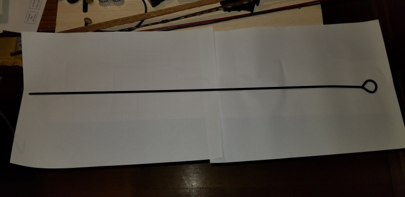

I have a barrel that won't group better than about five-inches at 25m, on a very good day, with ammo it really likes. But this is not because it's worn, it's because of the way it was "cleaned" and that it was used for decades for "fishing". Put the muzzle in the creek, wait for fishies to swim near, pull the trigger and grab the stunned fishies. The barrel is 25" long but a cleaning rod only has friction in the first and last couple of inches - the middle is all bulged way over-size. As it had one owner from new in 1940 until I inherited it, I estimate it had well under 5000rds put through it. The cleaning rod is little more than a length of fencing wire.
