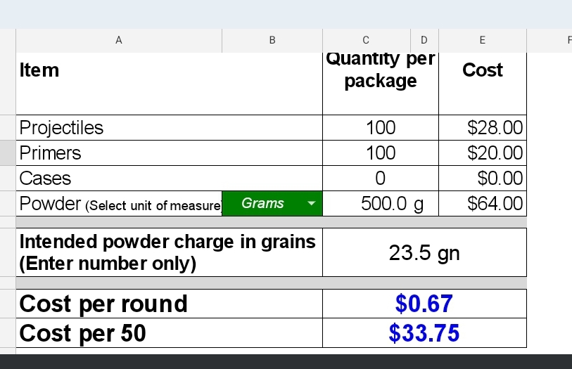

Way off topic. I did the google on costs and come up with these costs for loading 223.
Aprox I guess.
Re: School me on 22mag and ammo
Post by bladeracer » 02 Aug 2022, 7:08 pm
Oldbloke wrote:Way off topic. I did the google on costs and come up with these costs for loading 223.
Aprox I guess.
Aprox I guess.
$20 for 100 small rifle primers? You must be buying the premium stuff. The last primers I bought were about $7/100 and I thought that was expensive.
