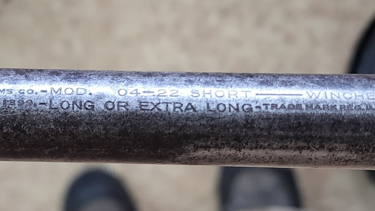

On this subject I also have a question.
My first gun was a Winchester Model 04 that my Mum gave me for my 13th birthday, still have him.
It is pre serial numbers but I'm told that there were two versions, one marked 22 short and 22 long and another marked 22 short, long and long rifle.
Mine is in the second group, does anyone know the date ranges of the two series?

G'day Lazarus,
Is your rifle marked MOD.1904 or MOD.04? Are your calibre markings actually ending in Long Rifle or Extra Long? The change in date from 4 digits to 2 digits occured in February 1919, and the calibre was marked- 22 Short, Long Extra Long from 1914 until 1927 then it was changed to Long Rifle, the Model designation changed that same year and aftter 1927 they were marked MOD.04A, hope this helps.

G'day Lazarus,
G'day No1Mk3
Thanks for that info
This is the marking
So if I understand correctly that would be some time between 1914-27?
With the year marking in 2 digits, it would be Feb 1919 to 1927.
Thanks mate, it's something I've wondered for 50yrs.
