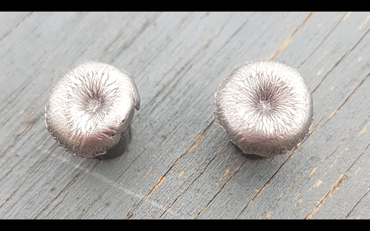

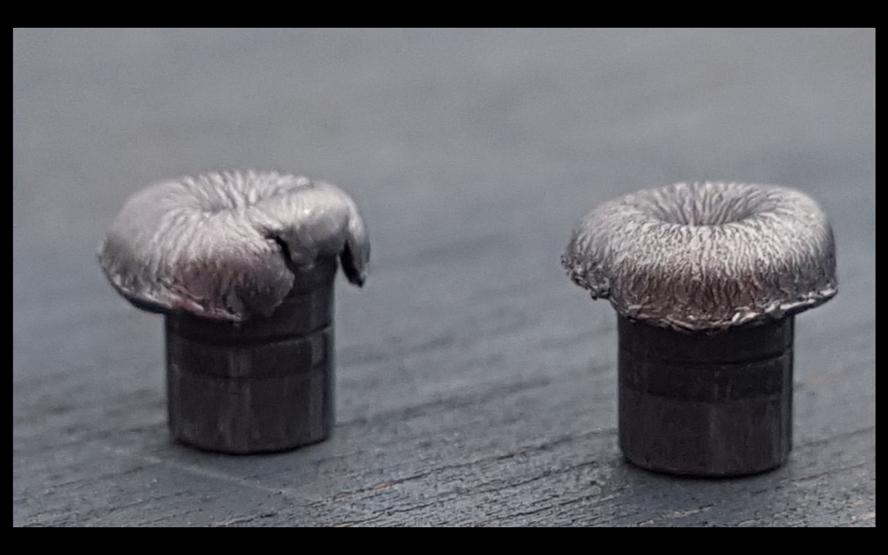

Post by deye243 » 01 Jan 2023, 12:03 am
Been through this before they were milk cartons now you can always tell an effective bullet on a rabbit or a fox because of the thump it makes when it hits nearly as loud as the round itself using a solid you get a slight click and they buzz clean through half of these bullets don't even exit a rabbit on a longitudinal shot which proves they work well but as I only shoot them stinking things to get rid of them ain't no way I'm getting my hands dirty digging friggin projectiles out of them bloody stinking things .
Another way of finding out whether you have a effective projectile shoot one at 150-200 yards should have a very resounding Thump and they should just jump a bit up land flat on their sides dead as a maggot or do a backflip chest shots again round noses and hard bullets like just about everything cheap just sail clean through and they run off and if your lucky they stop and die .

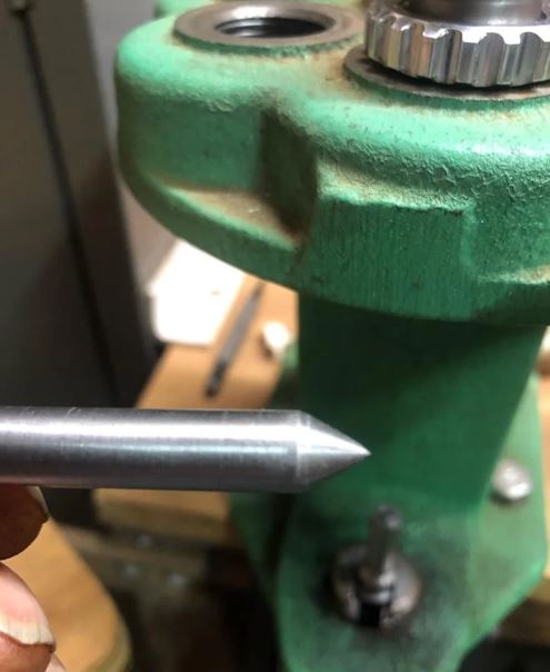

Here. I must have saved a couple of pics.
Easy if you have a lathe.

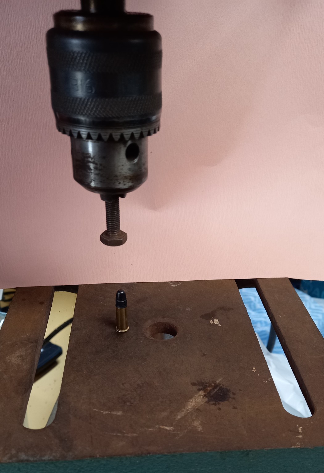

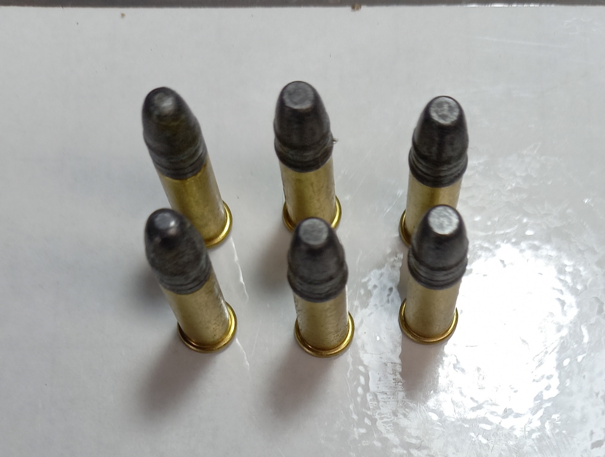

Re: US manufactured 22 ammo
Post by Oldbloke » 01 Jan 2023, 2:45 pm
I did this in a drill press. Just set the drill stop. Four flattened. Two un touched.
Post by bladeracer » 01 Jan 2023, 4:46 pm
Oldbloke wrote:I did this in a drill press. Just set the drill stop. Four flattened. Two un touched.
Do they still chamber okay?
No loss of accuracy?
Post by Oldbloke » 01 Jan 2023, 6:13 pm
Lazarus wrote:That was one of my first thoughts, and it does work but what stopped me was losing concentricity without the die.
Have you checked them before and after?
Have not been shot yet. (Been slack) But feed OK.
Hoping they kill a tad better and still very be accurate.
I don't expect them to mushroom but might "start" to mushroom. Searching around suggests flat points kill better. I intend to put one through a few milk cartons full of water as part of the accuracy test.
I have measured a few with a mitutoyo micrometer and no measurable change to the diameter. But you can see they have been pushed back into the case by perhaps upto 0.010"

Oldbloke wrote:Here. I must have saved a couple of pics.
Yep, that's the die I made. Hollow point depth is controlled by screwing the central plunger up or down.

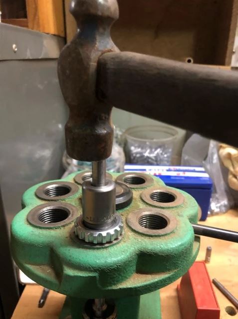

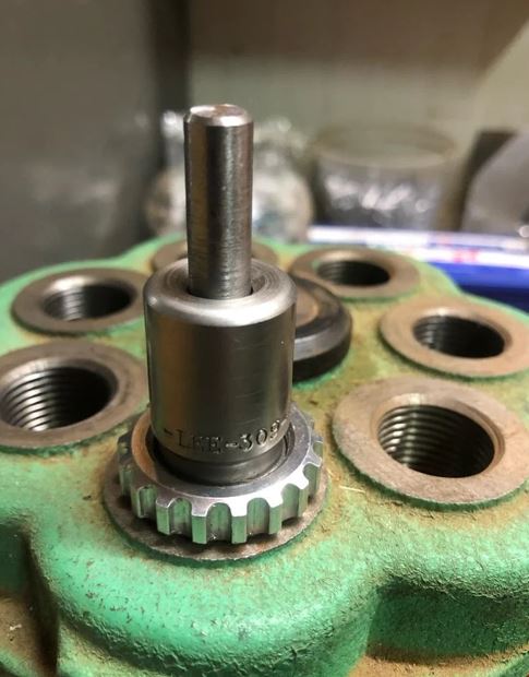

Post by Oldbloke » 02 Jan 2023, 8:44 am
OK. Found the other version.
But not for 22ir. 308 bullets.
Used a 308 sizing die for cast bullets and hit with a hammer LOL.
BUT Im convinced this will work for 22lr.
Same idea, 224 resizing die with a pointy rod to fit. But do it in a drill press to give depth control.
