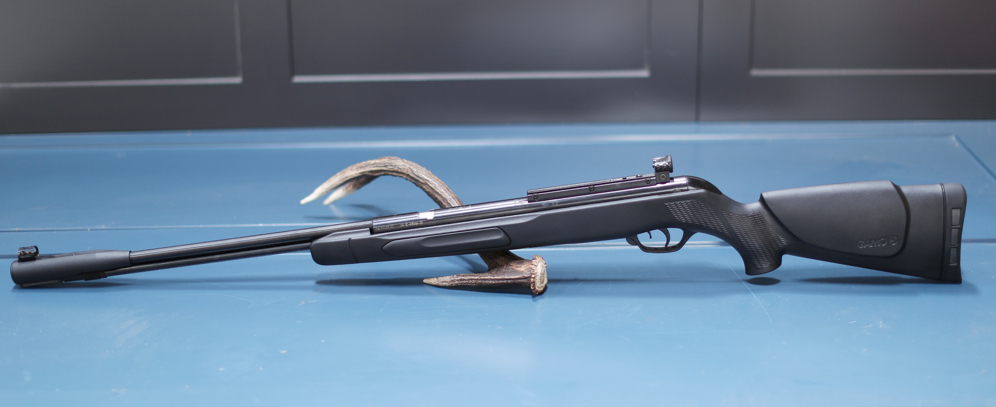

Post by SHV » 24 Feb 2023, 10:19 am

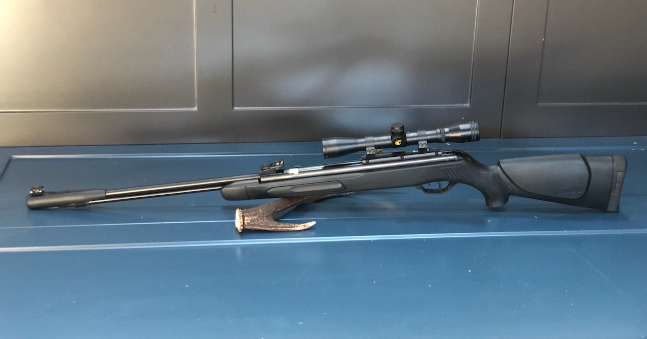

Very accurate but scope always has zero wandering issues, not too much but drives me crazy

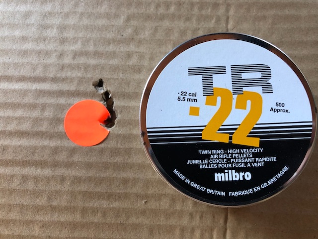

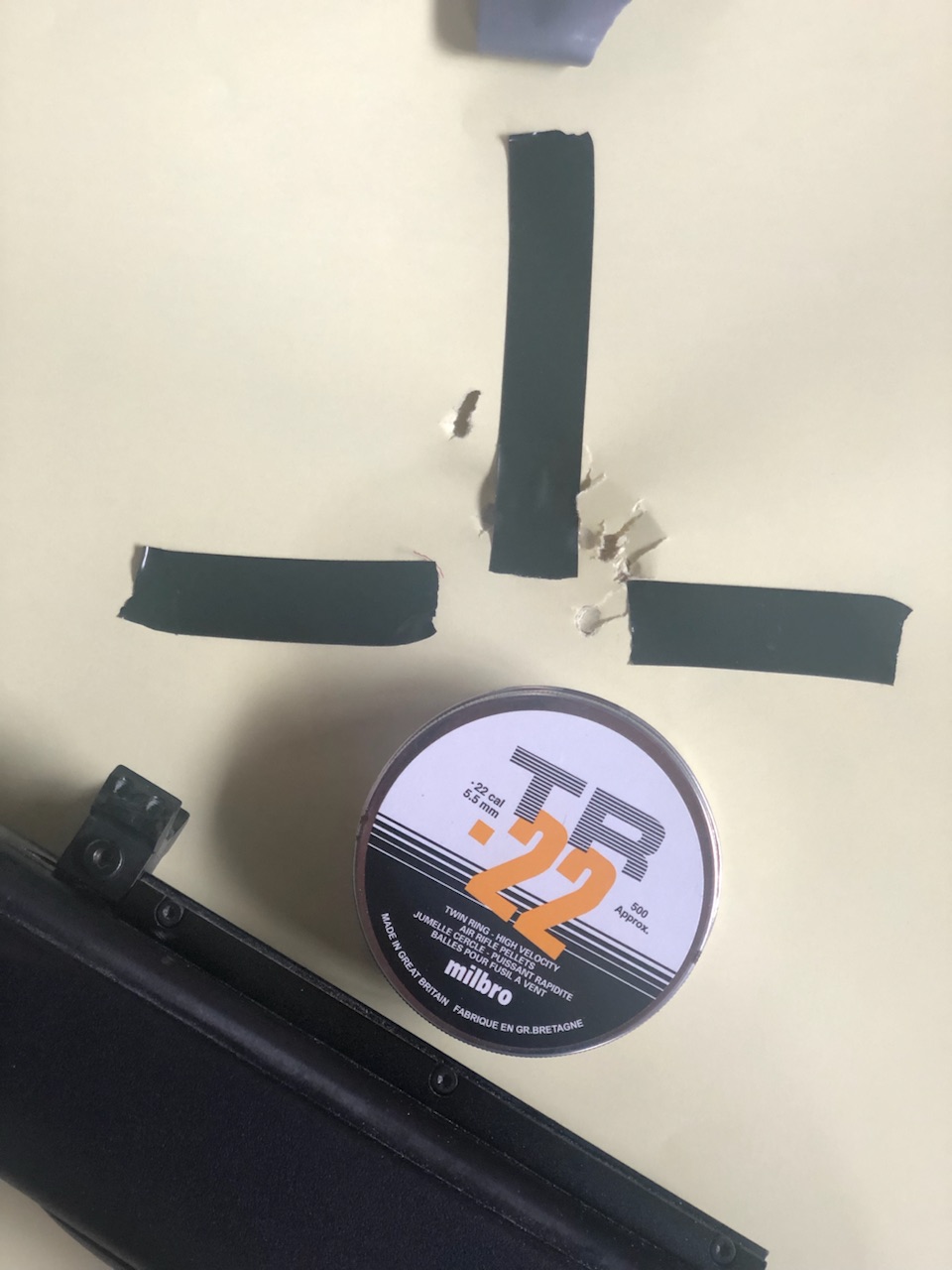

Post by SHV » 24 Feb 2023, 10:24 am
TR is the best ammo for it
Scoped at 25 meters
Sometimes you can get amazing accuracy sometimes not and sometimes the rings and scope move backwards because the shocks and vibrations
Even put the pin down to the hole on the rail the scope ring screws still keep loose

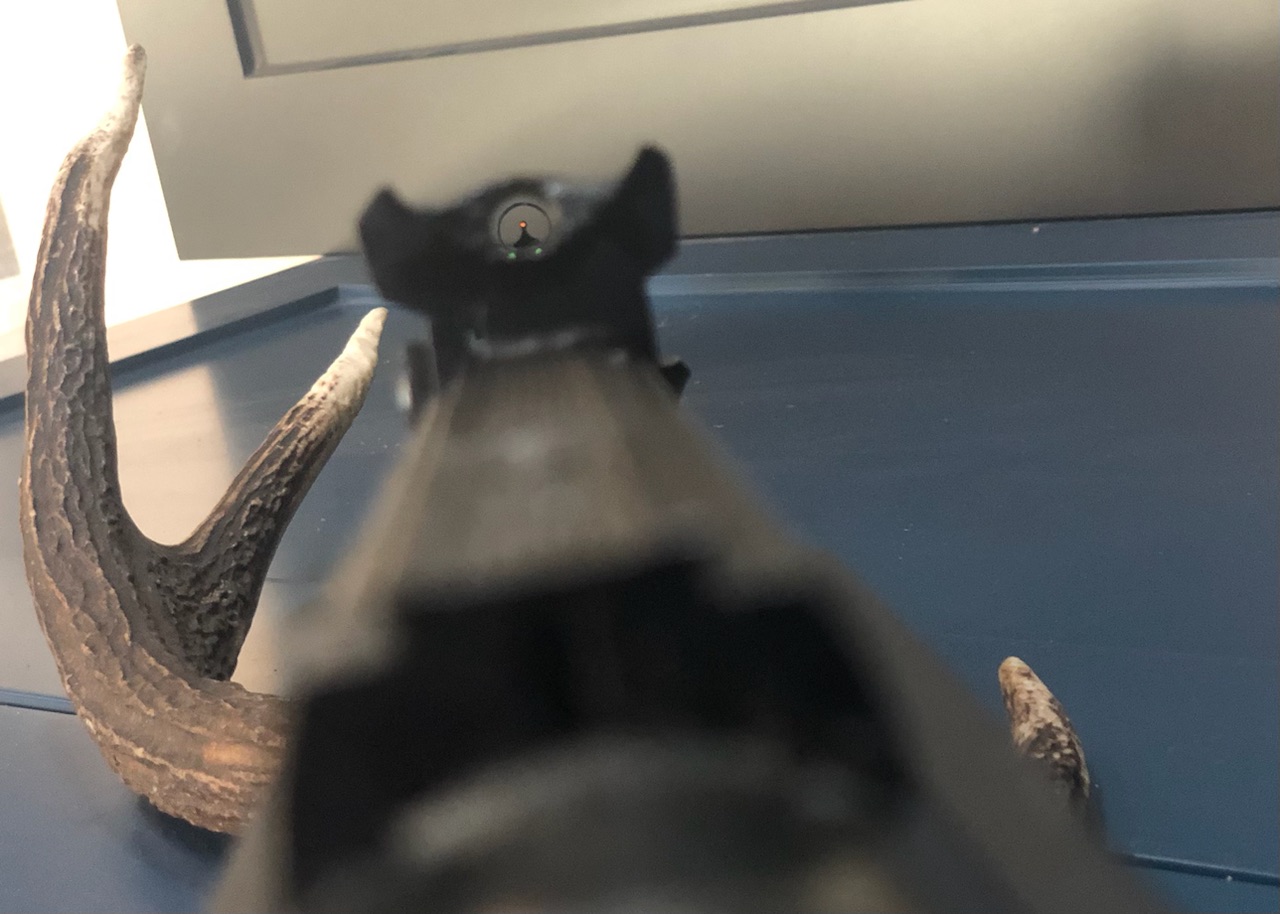

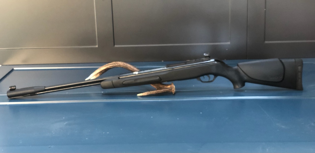

Post by SHV » 24 Feb 2023, 10:30 am

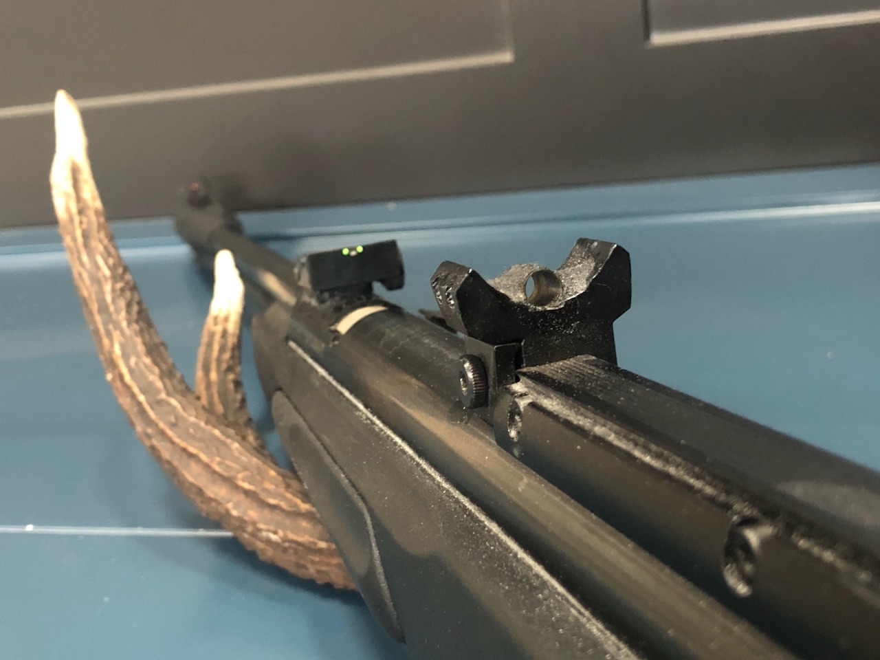

So I use some parts to DYI peep sight
Cut a 22 case glue (super glue and baking powder magic) to an aluminium ring and cut and trim the ring a little bit, easy job I know it’s ugly but it works

25 meters quick test
Much easier to aim
Much tighter group compares to original open sight which is ok for most of the shots but always a big fly far away from the group each 5 or 10 shot (it maybe is my fault)

Post by animalpest » 24 Feb 2023, 2:15 pm
Yeah I have same issue with my Gamo rifles of the same model - I have 4 of them. Will get good groups then after about 30 shots its all over the place. Scope wanders around, tried different scopes, mounts but the spring going off rattles them. Resight them in and good for another 30 or so shots.

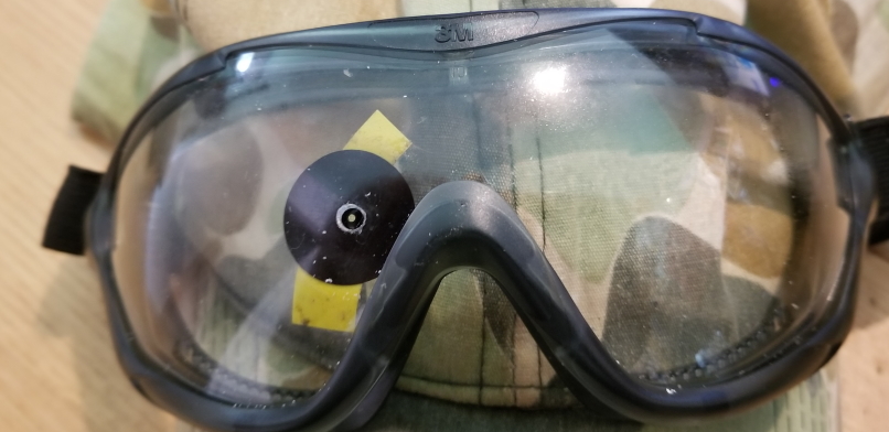

Post by bladeracer » 25 Feb 2023, 1:31 pm
SHV wrote:If you got better eye sight open sight maybe better but unfortunately for me the open sight always guess work but the peep sights are more comfortable to use and always much better accuracy
My eyesight is failing me rapidly now, front sights don't exist anymore and rear notches have become "W"-shaped (so I can pick which one I want to look through). But if you practice getting a consistent cheek weld you'll find you can still shoot remarkably well without being able to see the sights.
But the aperture sights work best when it's close to the eye, as close as you can have it without endangering yourself from recoil.
For precision try one of the apertures that fit onto your glasses, like the Eyepal. For about $40 it is well worth trying as the difference is astonishing. I can be looking through my open sights and have no front sight and a blurry W for the rear, pull down my glasses or goggles with the Eyepal on them and immediately have a perfect sight picture. It does not work well at all with aperture sights I've found.
https://eyepalusa.com/
Goggles work much better for me. With glasses, they move with every shot so you have to find the hole in your glasses first, then look for the sights, and then the target. With goggles they stay in place every shot, and when I remove them and put them on again they're still in the same place. Goggles do fog up though so I drilled a hole through them so there's nought but air between my eye and the sights. It means I can't see much through the fogged up left lens though so I may decide to remove the left lens entirely.
I shot with LERAA last weekend, and used these goggles with the open sight SMLE, I don't need the aperture with the PH5 sight on the modified SMLE. LERAA here don't like the Eyepal and consider it a sighting aid, they're happy for me to shoot but I won't be in the running for awards and things, which is fine with me so it's a non-issue. But LERA in the UK do allow the Eyepal and consider it an aid to eyesight rather than an aid to shooting.

Post by SHV » 02 Mar 2023, 1:43 pm

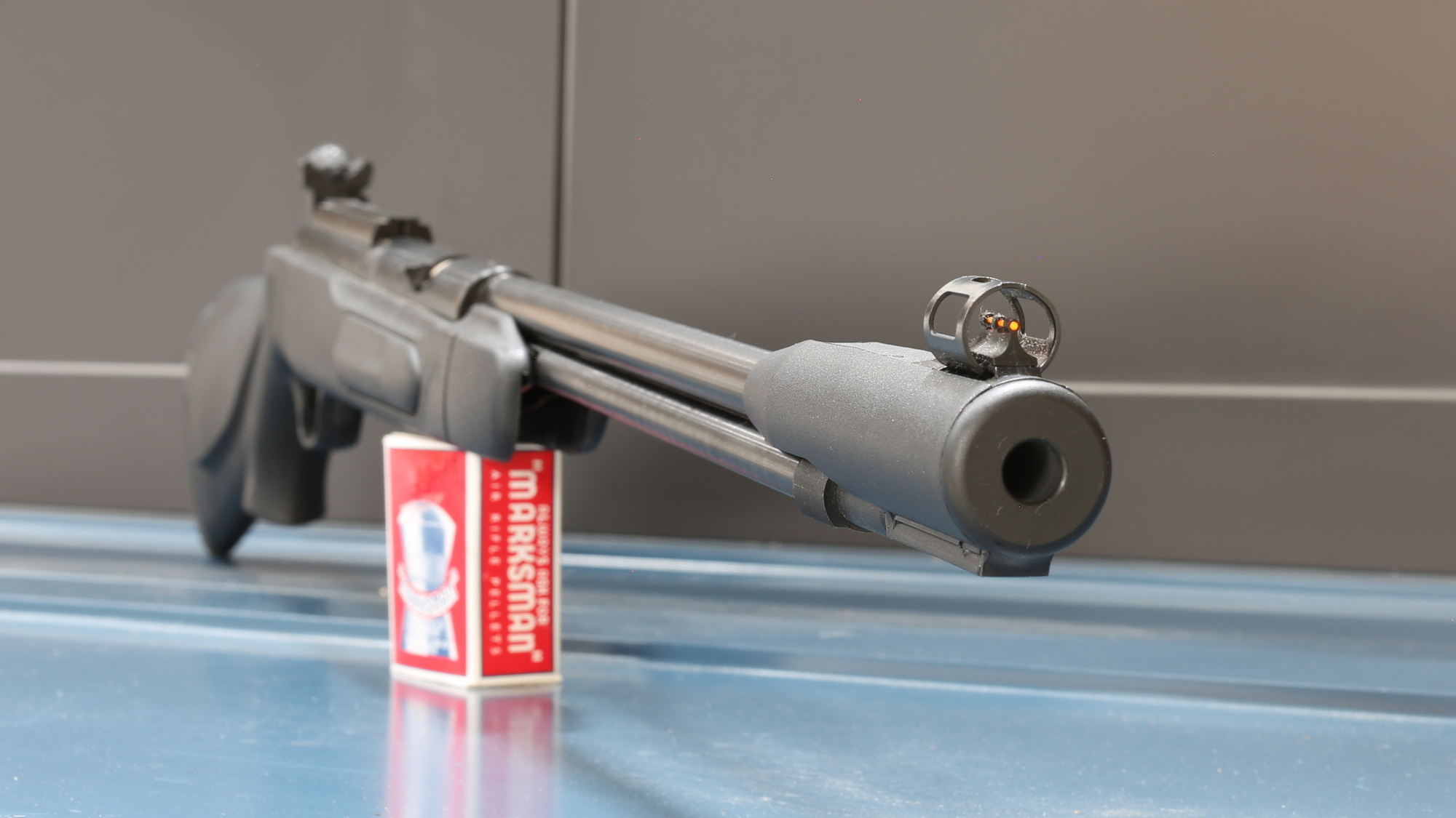

you boys are right
I found a piece of plastic from a broken ball pen is perfect size as inset,(tight fits into the 22 case to reduce the hole size) so I can move the peep sight to the back and cut the coke bottle lid as eye piece glue to the back of the sight, remove the open sight then the project finished
And turns out the result is not too bad

This is a good idea for the outdoor range at day light, will make the vision much clearer but a little bit darker I reckon…

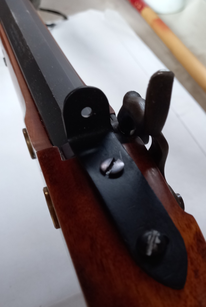

Here is a very simple one I made for my ML. There is a slot for the rear screw that facilitates some adjustment L to R. Height is adjusted just bending & with shims.
Peep is 3.5mm and intended use is general shooting and perhaps hunting one day.
