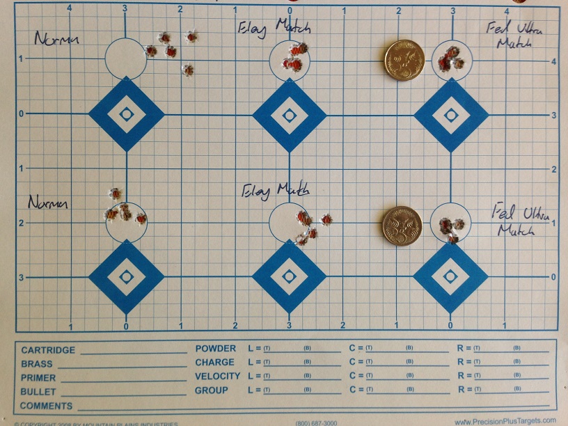

I've also got a Crossover and have been testing various different ammo at St Marys.
The barrel on my Rifle wasn't floated so i have done that. I also installed a Lumley Arms Trigger kit which reduces the pull to about 700gm and takes some of the creep out.
I've tested the following Ammo in mine.
Eley Club - All groups under 1" but holes not touching,
Norma Practice - All groups under 1" but holes not touching
Federal Ultra Match - Some ragged one holers about 9mm and some average groups 15-20mm.
SK Rifle Match - Groups around 12-15mm
RWS Rifle Match - All groups under 1" but holes not touching
Winchester T22 White Box - 1.5" Groups
Lapua Centre-X - All groups under 1" but holes not touching
The first 3 were done prior to floating the barrel so i'm going to re-visit the Federal Ultra Match this weekend to see what difference that made. I'll also be trying a few other rounds in my search for the best performer. I'll try the Eley Match and see how that goes.
My Scope is a Bushnell Legend Ultra HD 4.5-14x44 on Burris Zee low rings.

Post by GPostal » 13 Feb 2015, 4:40 pm
Good work Custom PC.
The 3 Crossovers that were sold from my LGS all shoot different ammo well .Mine one like the most expensive ammo...Meh !
However, one owner recommends reinforcing the fore-stock with a strip of alloy to improve groups and different ammo. Also to play around with action bolt tensions.
Lithgow recommend 1.3 nm on each but I need to find a tension wrench that accurately measures that low.
Custom PC - Do you know what tension have you got ???
Once ive found a consistant ammo ill play with the tensions.

Post by CustomPC » 13 Feb 2015, 5:40 pm
I use the Wheeler FAT torque wrench set to about 13in/lb which is 1.5Nm.
I've yet to experiment with different torque settings.
For the stock stiffener and bedding I've purchased the "Match Grade" products from NZ. The company name escapes me right now but a Google search should find it.
I will do a bedding job sometime in the next few weeks.

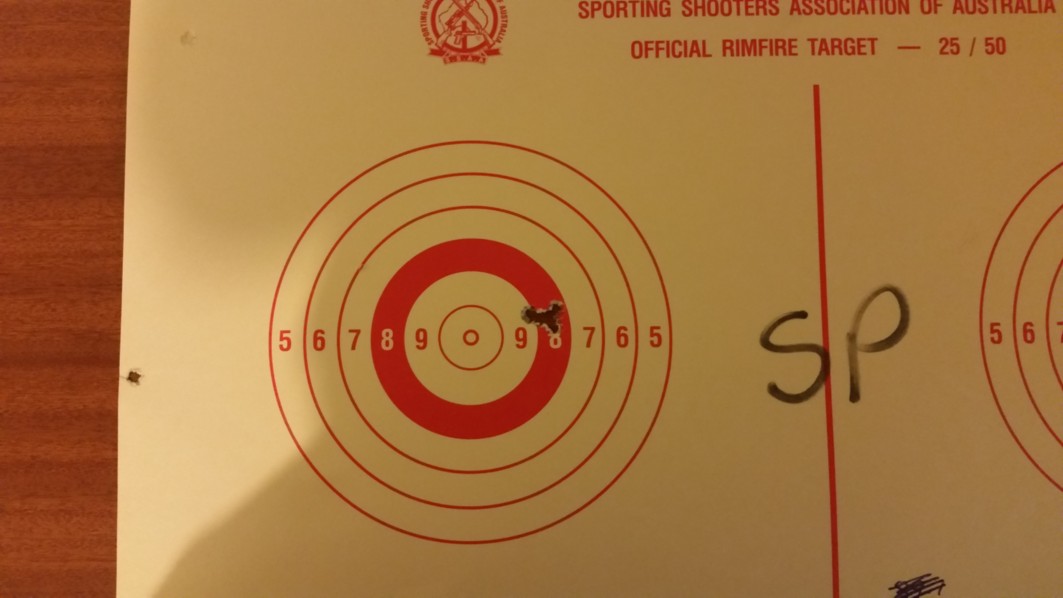

At first my Lithgow shot pretty much as above, no real consistency that I could find. After starting to argue (I call it arguing) with it, it would throw the first shot and then group nicely. I thought after bedding the rifle I had it pretty much sorted and seemed to be shooting and grouping well but the last two weeks it has started throwing the first shot and then grouping again.
See photo, yes that is the first shot to the left, very edge of the paper and then the next 4 shots is in that one hole.
Anyway I've tightened all the screws up further tonight, action and scope screws, I'll try it out on the weekend and if it hasn't improved I'm going to part ways with my Lithgow. At this point in time I'm quite disappointed with it which is a shame because I do like everything else about it especially being Australian made.

The picture below shows my results on a good day when i'm shooting well. The ammo is Norma 2, Eley Match and Federal 922A
