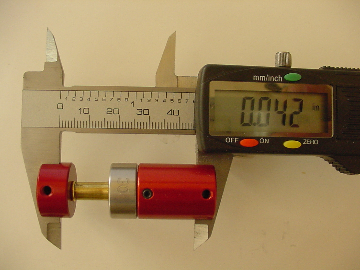

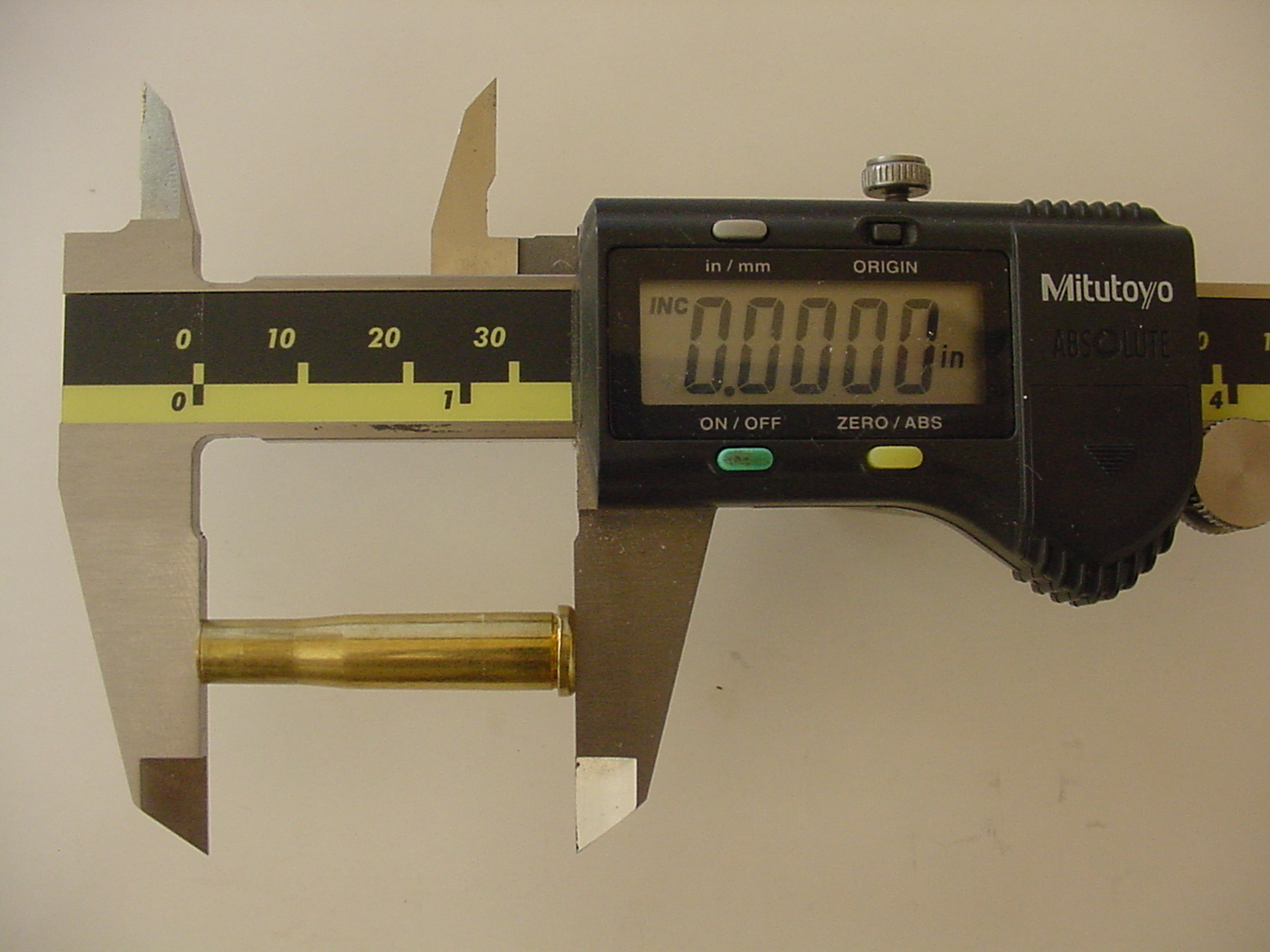

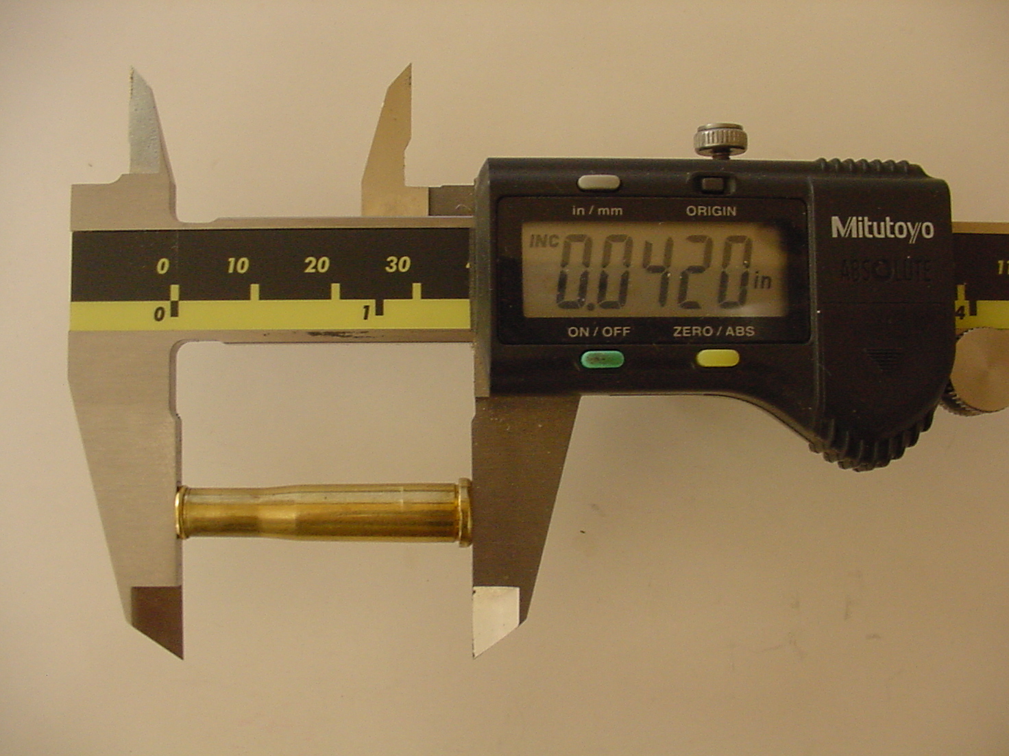

This is the cheap gauge we are talking about and the rim thickness measurement. Made by squaring both the head and neck of a fired .22 Hornet case so the measuring faces are parallel to each other. The way I use mine is it sits in a .30cal OAL gauge and is held in place to make measuring a simple single handed job other than changing cartridges.
Cheap ammo has a large measurement difference but even quality Lapua can vary to around 0.004". The last 500 I measured I had two main groups 0.001" different but about 10% of the brick were in another 5-6 groups. Shooting those shows up the POI difference in the varietion.
Some say this is a waste of time. To those, well fine and to each their own belief.

The red thing in the third pic is a holder, now I understand it I should check a 50 or so to see what happens.
rsj223
Posts: 649
Re: Head spacing .22LR rounds
Post by Apollo » 20 May 2015, 11:03 pm
The main "Red" thing is a Hornady LnL Comparator Base, the smaller one is a Hornady LnL Anvil and the shiny bit is a 30Cal Sinclair Comparator Insert. It's just that a .22 Hornet Case fits neatly into the 30Cal Insert so no need to hold anything. Normally used to measure Ogive readings for my 30BR's.
All just parts of my measuring equipment so nothing was purpose bought for this job.
