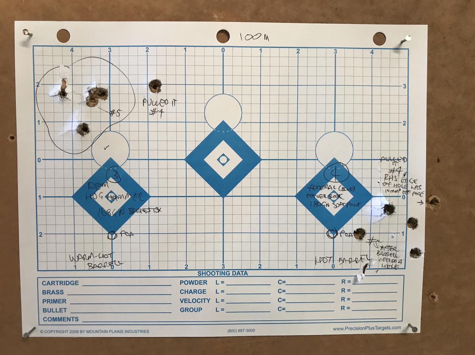

Was able to get some more time behind the featherweight 30-06 yesterday and found some fairly rubbish groupings from a couple of different 150gn rounds, and some decent groupings from some heavier rounds.
In particular:
- Remington Hog Hammer 168gnBarnes TSX tips - that I plan on using for pigs
- Federal Power Shok 180gn soft points - that I was planning on using for deer.
Question - will the 180gn soft tip be ok for foxes too.. or will it be major overkill...
Vicko

Post by Vicko » 21 Sep 2020, 10:24 am
Yeah I figured as much.
Slightly over 1MOA versus 2.5MOA...
I still have some more rounds in the safe to test. Happy that I've found good relatively inexpensive options for pigs and deer (which is what its for really), but would like to find some decent options for foxes.
Will keep you posted. Sun's out today.. might get out again at lunchtime...

Post by Vicko » 21 Sep 2020, 10:32 am
Here they are.
Vicko
Posts: 116
Re: 180 gn 30-06 round for foxes..?
Post by Vicko » 21 Sep 2020, 10:34 am
Also noticed that the #5 round I shot with the 180gns (after I'd walked up and checked the first 4 and written on them and then returned) was then the left most of the group. Warmer barrel could mean more flex?
Vicko

Post by marksman » 21 Sep 2020, 11:38 am
l have used my 30-06 on foxes when stalking plantations (with permission, induction ect... :lol: l dont poach) on the way back after not seeing what l was after
the foxes would follow me around the plantations, the 30-06 guts them as well as kills them with the same shot, it works
but really can it be done safely is what l think you should be asking, in my situation yes it could be done, the 30-06 bullets are not frangible in construction and you need to know they will not be heading towards what you are not aiming at ;)
IMHO your barrel is way to thin for 5 shot groups
l would be doing 1 shot a half hour to make it like out hunting or no more than 3 quick shots then let the barrel cool right down
for factory ammo the groups are what l would expect and not that bad :thumbsup: it does seem that your rifle prefers the 180's

Post by Vicko » 21 Sep 2020, 3:55 pm
marksman - yes I wasn't really going for any records in terms of tight groups. I'll try one shot with the 180gn again with a cold barrel next time and confirm its still dialled in to the same spot. Oddly enough as the barrell warmed, groups tightened.. so I need to double check that (you can see on the targets I noted barrel temp). 4 shots of the 180 in reasonably rapid succession and it was hot to touch but still grouped ok.
I do have two other packets of 125gn including a 'Lite' hornady load and a packet of 168gn precision hunter still to group after having a bit more time behind the rifle (both of those are more expensive than I'd like tho...). The trigger is still pretty ordinary, heavy and long, but I wanted to know that it would shoot before spending any more money on it. And I think the trigger has lightened a smidge as Ive been using it.
I'm not too fussed with using it for foxes to be honest. Just a good excuse to get some practise shooting it under pressure. I dunno if I'd see any more foxes after the first shot anyway.. its pretty bloody loud :)

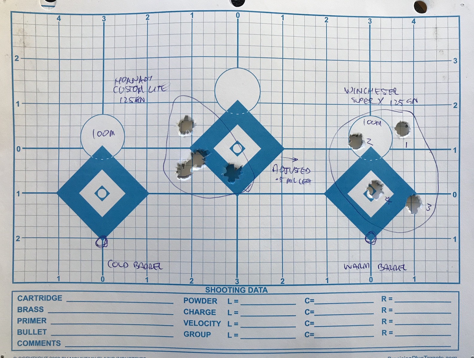

Post by Vicko » 26 Sep 2020, 5:27 pm
Update - took her out for another bit of testing today and I have some more options now. On top of a good pig load and a good deer load as per previous posts, I now have two good 125gn fox loads. One of them surprised me how good it turned out to be to be honest.
Today I tried the Hornady Custom Lite 125gn and WInchester Super X 125gn. The Custom Lite's grouped a genuine 1MOA from a cold barrel. 4 shots in about a minute. I'm more than happy with that from this rifle. The Super Xs were a little over 1.5MOA on a warm barrel which would also nearly do (and they're much cheaper).
I also tried the Hornady Precision Hunter 178gn and it HATED them. Barrel was hot by then and I noticed the bipod screw had come a little loose so I tightened it up during the group so I might have to reshoot them tomorrow. But we're talking 5MOA... I won't bother showing that group lol ;)
