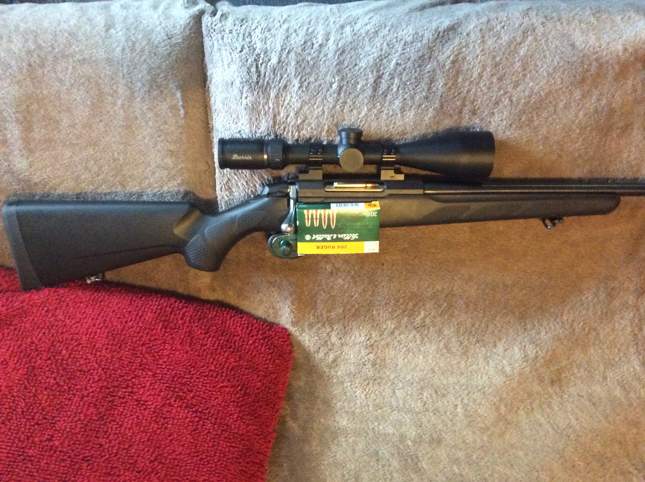

I had the same conflict. Finally settled for a Tikka T3 in 204 Ruger. A little more punch, and factory ammo is cheaper. I did have a .17 Remington 30 odd years ago and it was an AWSOME fox buster. I don't use enough ammo to justify reloading, so it would be your call, but have a look at a .204.

Tikka T3 204

Post by Grizzle » 20 Oct 2017, 6:04 pm
I use L&B 32 grn, my Tikka loves them. It would depend on which rifle & what it shoots best.

Post by Grizzle » 20 Oct 2017, 6:12 pm
Sorry, forgot to attach picture.
