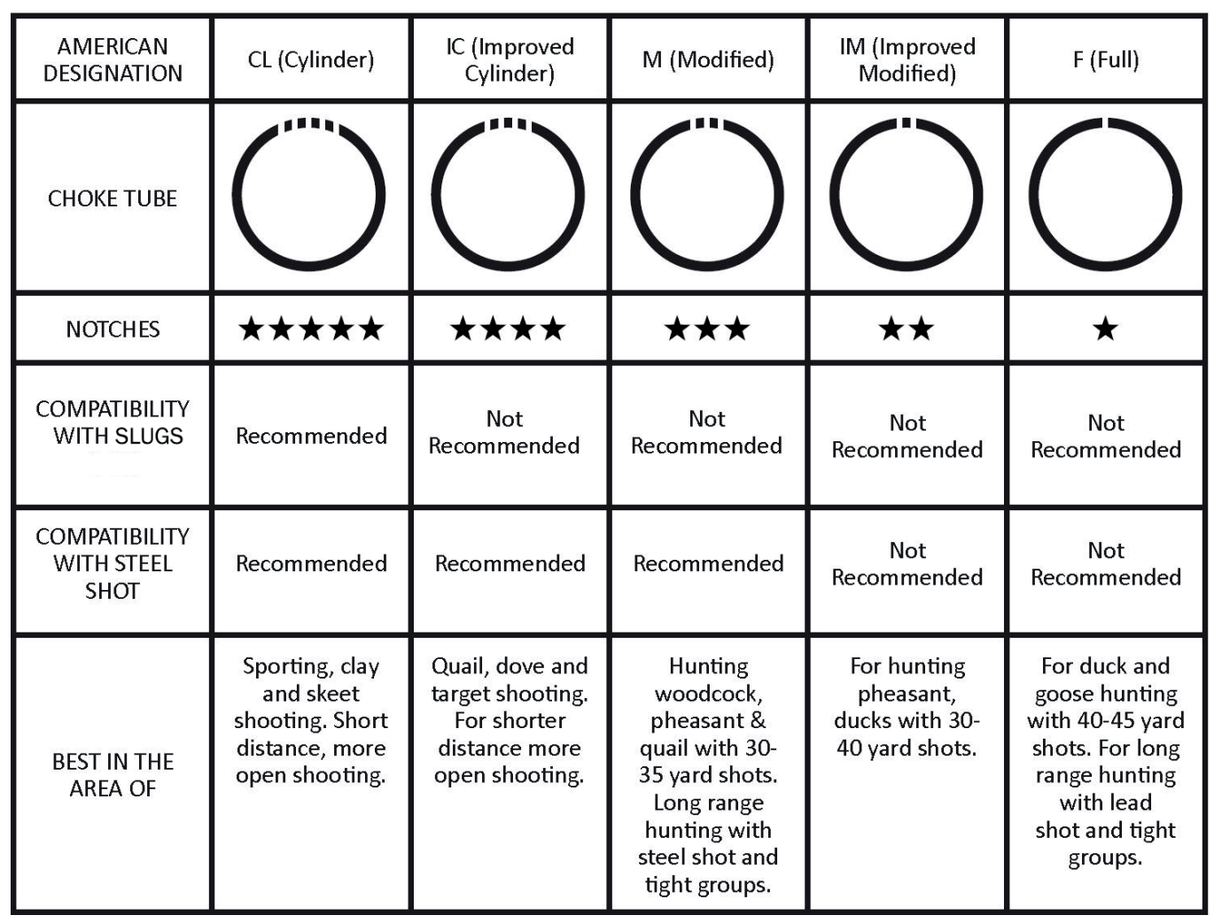

I recently purchased a Templeton T2000 on the back of the WA Firearm laws changing.
I've never done any sort of shotgun shooting and am new to the whole venture.
What choke should I be using for Fox shooting? I've included a screenshot of the user manual but it only refers to birds.
What distances is the shotgun effective for? Ammo recommendations are also welcome :)

Full choke,36gm BBs, out to 40m

I agree full choke and BB shot is good also .

I agree full choke bbs but I’m mostly pig hunting so I’m full choke 36 grams of aaa shot , so that’s what I hit my foxes with . I also have a Templeton 2000

I just select the ammo and see how it shoots on a pattern board with tightish chokes to give a decent range.
BBs are a known fox shot and I like #2s as I got a good tight pattern with a tight choke.
I didn't like that 9 ball buckshot as it left holes big enough for a rabbit to jump through and it's too exy to see what choke it liked.
It seems safe enough to shoot slugs out of those guns with one size tighter than open, and I had no issues shooting about 40 rounds. It was very accurate through the 20" Dickenson.
