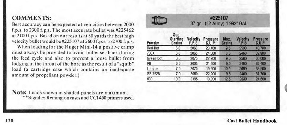

I load a 55gr SP with 7.6 gr of AS50-N in my 223 (see thread link below)
viewtopic.php?f=3&t=4991

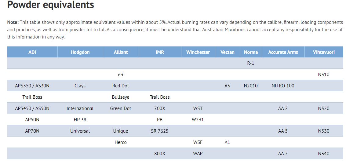

I believe you can do same. You list the following powder in stock.
Alliant 2400 APS 450 AP50N AR2205
ADI Eq.JPG (78.19 KiB) Viewed 13349 times
APS 450 (preferred) AP50N These are close to Green Dot. (but not same)

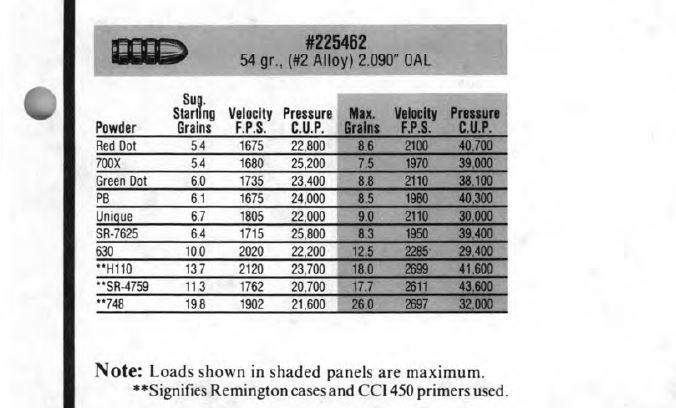

See loads below from Lyman 48th manual for cast bullets using Green Dot.
Lyman 48th squib 223 55gr.JPG (53 KiB) Viewed 13349 times
Lyman 48th Squib 223 37gr.JPG (85.87 KiB) Viewed 13349 times
I believe you can use APS 450 or AP50N with 40 to 55gr SP bullets using from start load 6 to 9gr.(max)
SAFETY NOTES because the case will only be about 50% full.
I would NOT load below about 5.5gr for safety reasons.(possible detonation) But I've heard of some using Blue Dot and 800x as low as 3 or 4gr and these are slower powders. So 5.5 should give a good margin of safety.
Also double check the powder in the case before pressing the bullet in place..(i use a torch)
If you forget to load powder you may get a bullet jammed just in the barrel resulting in dangerous pressures if not removed prior to a follow up shot.
Its easy to double the load resulting in dangerous pressures.
